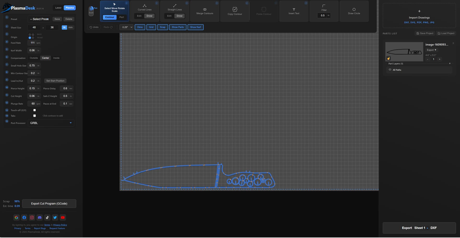

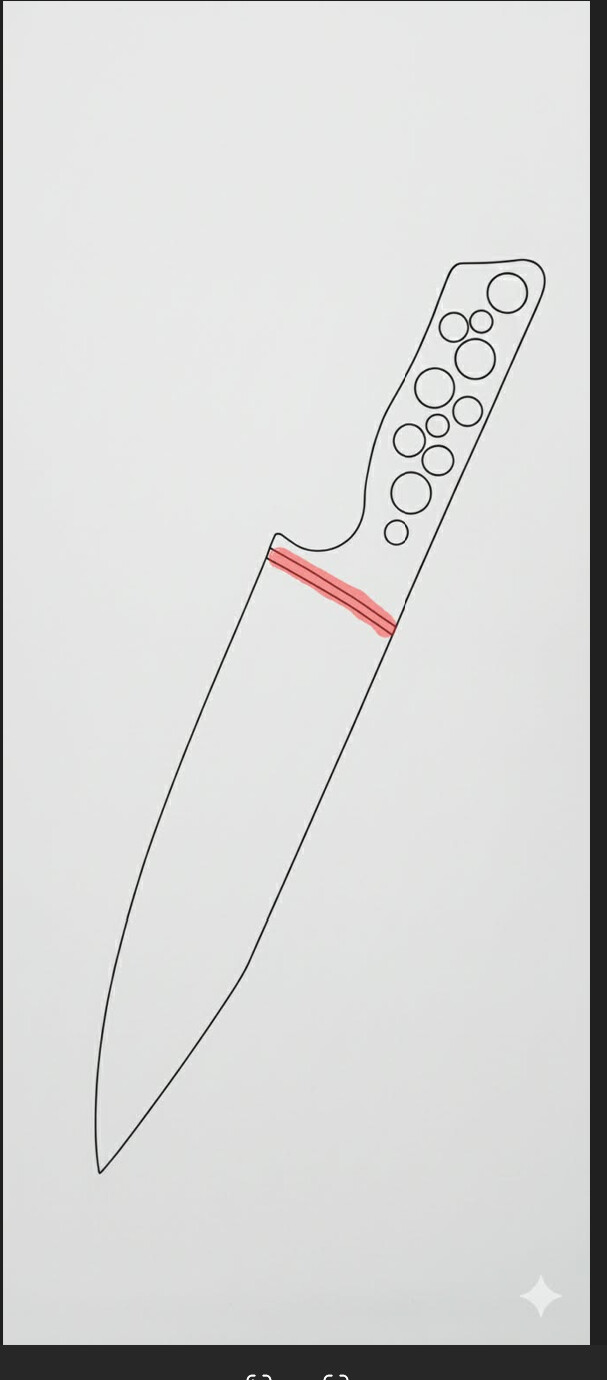

I spent about two hours working with it. It’s pretty functional. I tested a customer jpg and it did import but when I export the dxf it was blank.

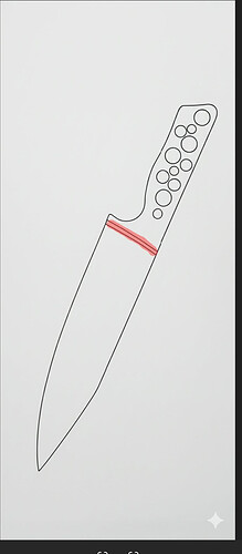

I imported this jpg
it totally identified the edges and I was able to rotate it.
If I could get the dxf export to work I would use this a lot.

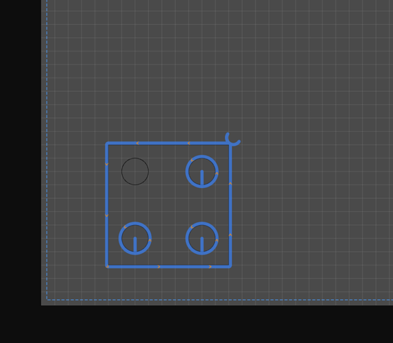

one other thing when drawing holes i can only define the radius. I don’t like doing math. I wish I could type in its diameter. outside of snapping I don’t have any other way of locating features. on the part below I need to locate the 4 holes outside of just snapping.
also notice how it didn’t put a tool path on the one circle but it did on the others? what causes this and how would I fix it.

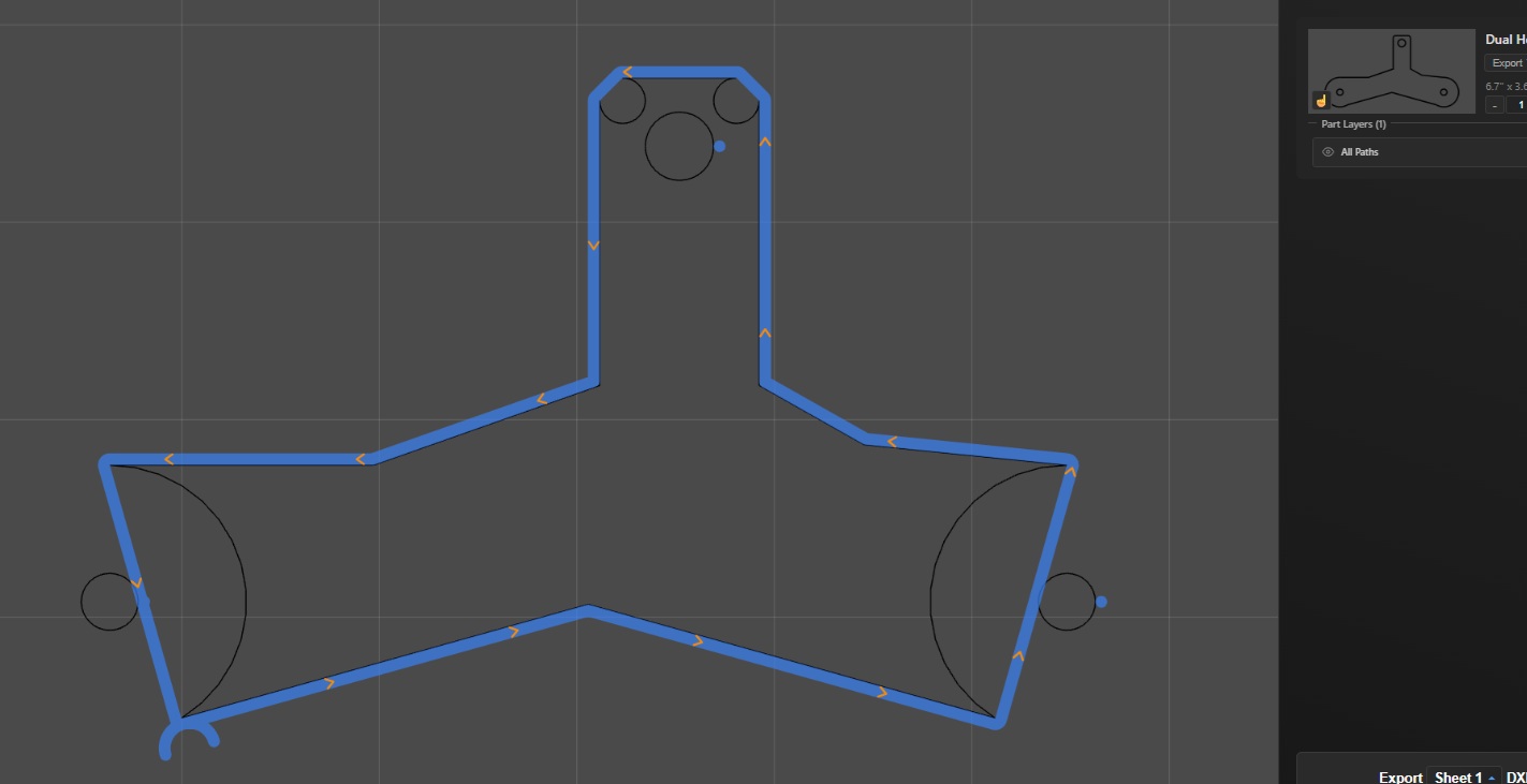

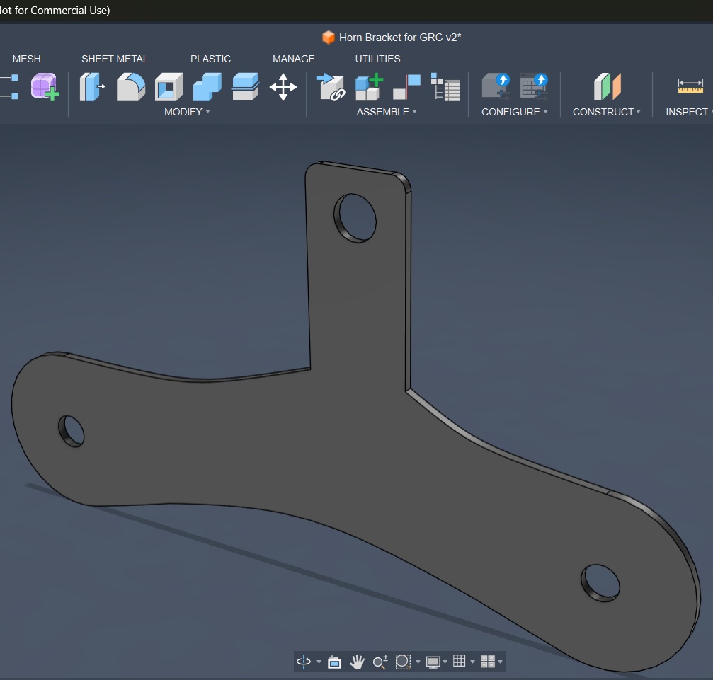

Ok. Here is a small horn brkt I have designed in F360:
Here is what I see when I open the dxf in your program:
You can see the dxf loaded okay by the view in the upper, right hand image. However, the outer half of the circular ends of the bracket are not visible in your program. I toggled the ā€œShow Partsā€ but that only eliminates the black circles in the sketch.
Dual Horn Bracket for GR Corolla.dxf (4.8 KB)
I tried several different files, both svg and dxf, and some imported fine while others did not. There were added or missing contours on some of them for some reason.
The outside contour is cutting in the wrong direction. Changing the compensation in the left panel does nothing, it still appears to be on the outside.
that looks like what happens when you flip the start and end points in a DXF interpreter. I use python to work with DXFs and i have the same thing happen when I flip the start and end. I think whatever language is being used always traces DXFs in one direction (clockwise or counter). at least that’s how python and the libraries I used work.
