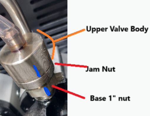

For the second part after that homing strangeness, that sounds like it is potentially just an under-tuned Pressure Relief Valve Calibration thing. One of your valves blew early and it forced the ram out of alignment. You just need to increase the calibration of your Pressure Relief Valves and
There are three parts to the PRV (Pressure Relief Valve):
  • The upper valve body - a part that can rotate and the position of which determines the pressure calibration.
  • The Jam nut - a nut that tightens upwards and holds the upper valve body in its calibrated position.
  • The base 1" nut that is used to screw the part into the pump.
To tune up your PRV, you will want to loosen the jam nut downwards slightly, turn the upper valve body about 90 degrees tighter to the right, and then tighten the jam nut upwards to secure the assembly again.
If your upper valve body and base 1" do not have a sharpie mark showing their default alignment, I would add one before working to tighten it up. That way you can keep track of how far you have tightened the valve past the pre-calibrated position. DO NOT TUNE YOUR VALVE MORE THAN 180 DEGREES PAST THE PRE-CALIBRATED VALUE WITHOUT CONTACTING THE SUPPORT STAFF FIRST.
You will also want to bleed your machine before you run another high-tonnage bend like that. https://www.langmuirsystems.com/titan25t/assembly#titan25t-manual-19
On your next bends, please take a video of the live report window so we can watch what is happening to the tonnage and ram positions. Especially on your first 90 degree tuneup. That way if your first 90 degree tuneup fails, you will be able to keep track of how much the pressure limit was raised by that 90 degree twist. You will generally want to make a 20 degree twist for each ton you are short.
Lowering the bend speed to 1 IPM for an extremely high tonnage bend will help, especially on the initial calibration after your first PRV adjustment. It will make spotting the high tonnage point on your post-calibration bend easier. It will also reduce the force required to make the bend.
