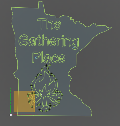

My cad and cam is all programed (in my mind) correctly. When i cut it the image is reversed. If i flip the part over it is correct but with the slag.
I am programming in the plane below

I don’t see anything wrong with the sketch and I ran your Gcode on my machine (dry run) without error and it cut in the proper orientation. Tag in @TinWhisperer
Just to confirm, you are getting a mirror image when you go to cut it out on your machine?
It is cutting so the top side on the table becomes the backside of the sign. Once cut I flip the part over and it is correct
And you’ve done cutting on this machine before? So it’s not a case of the wires being swapped on the motor driver inside the electronics enclosure?
I’m up for my computer right now but when I get back I’ll see if it’s a work coordinate system error in the setup menu (same menu is the stock box point)
I just cut a cut ready file from Fireshare so I am confident it must have something to do with my table. I have cut on this table but everything so far must have been symmetrical so I didn’t notice.

You can just swap a pair of the stepper motor wires (A+ A- swap them) and it will reverse direction of the motor. Only do X axis though. If it’s a dual Y axis you’ll have to do both motors

Ok, thanks.  But, in retrospect, I would manually exercise the table:
Goto  0,0
goto  +x,0
goto +x,+y
goto 0,+y
goto 0,0
To find out which axis is messed up and fix it.
I don’t know Firecontrol, but any decent controller would enable manual commands to do this. OR if it’s really a stupid controller, it’s simple enough to manually write a small G-Code file to exercise the table.
Anyone who has a CNC system should know basic G-Code.
Thank you for all of the help. I think i have it fixed. The Y axis was wired backwards. But with every solution comes another problem… I am losing cutting after about 30 seconds. Back to the forum for help.
