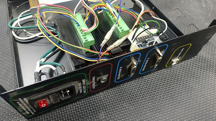

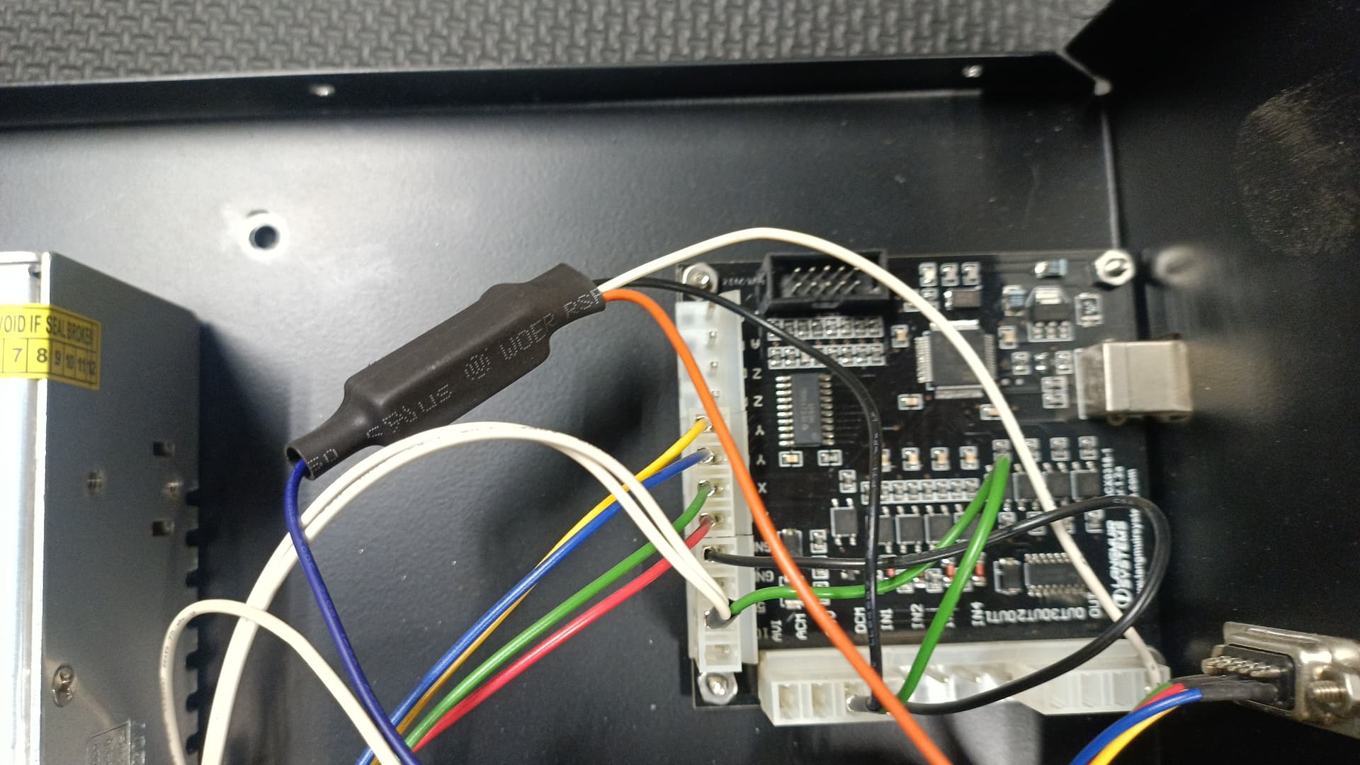

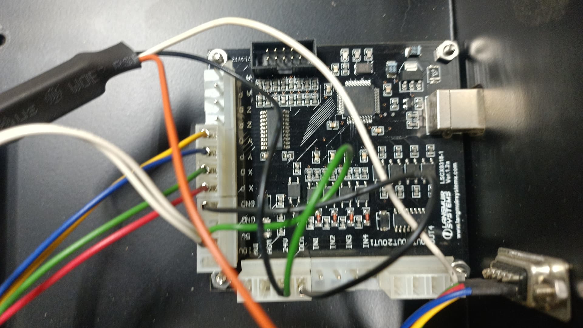

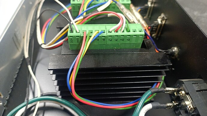

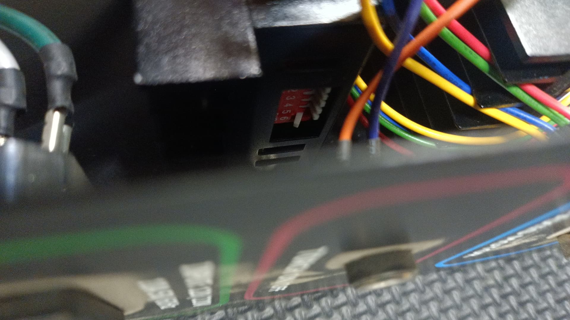

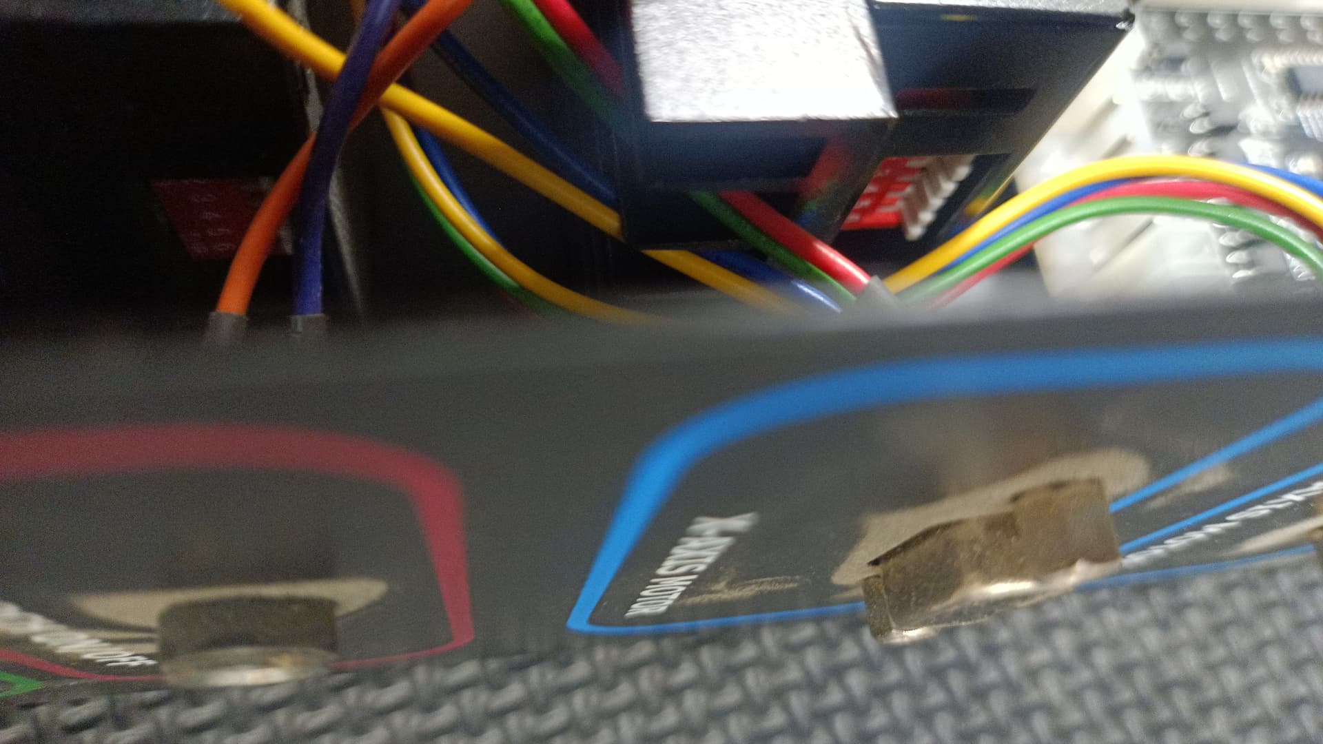

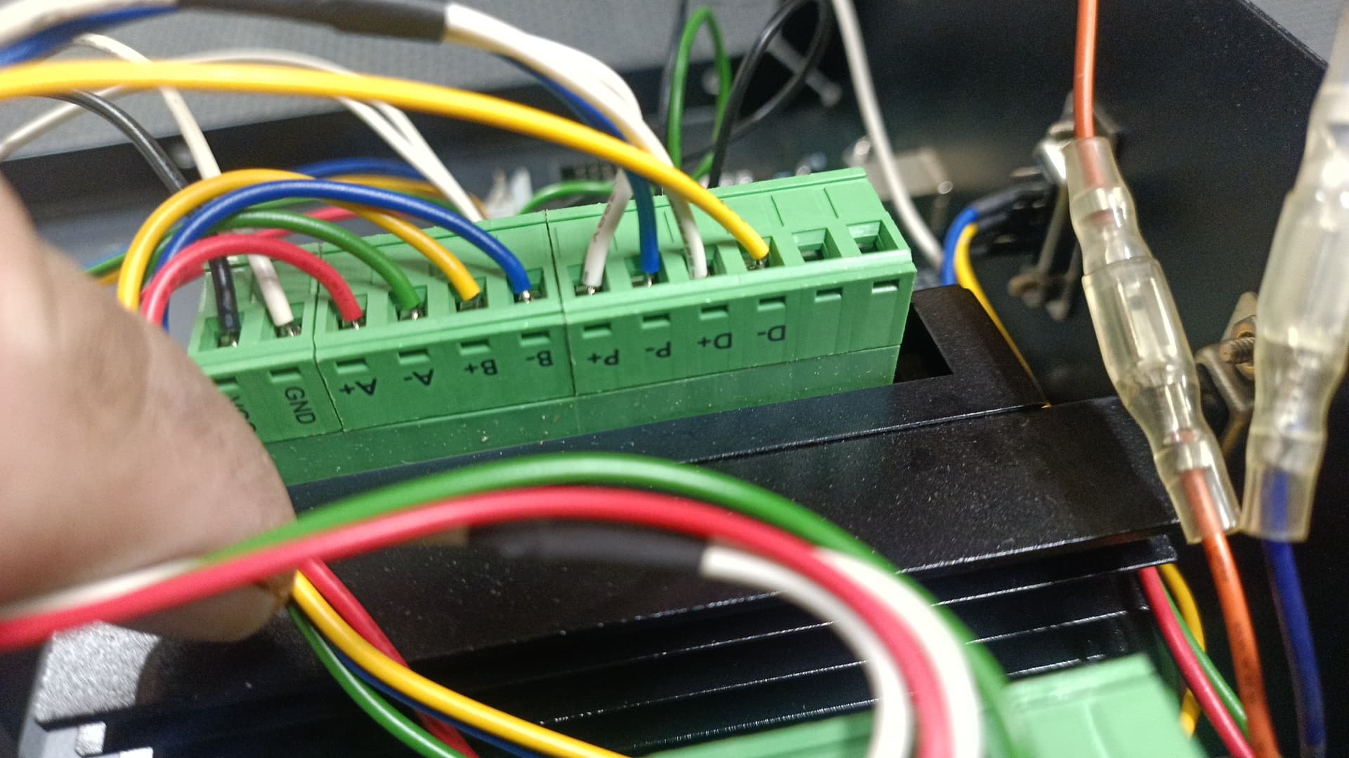

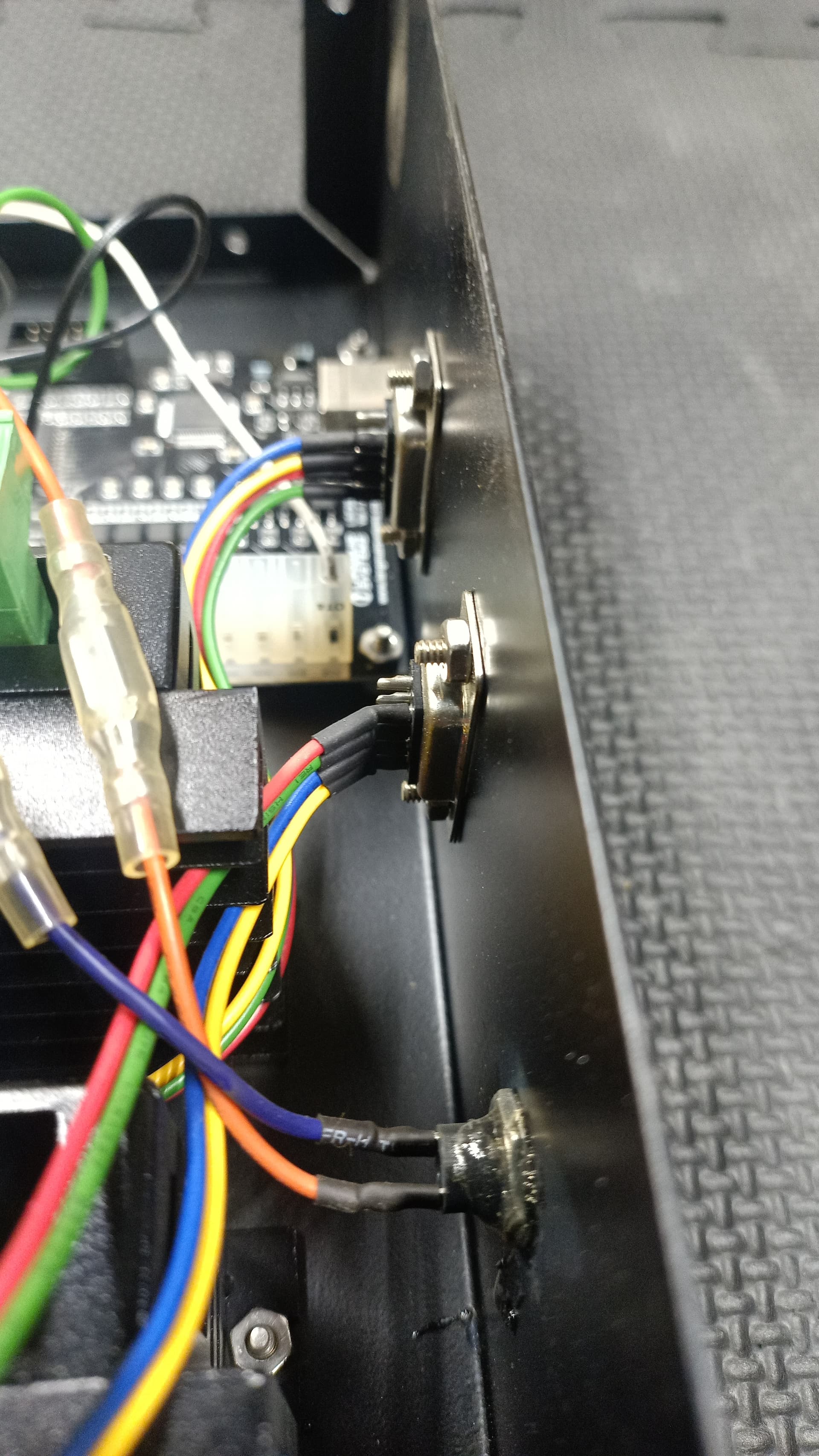

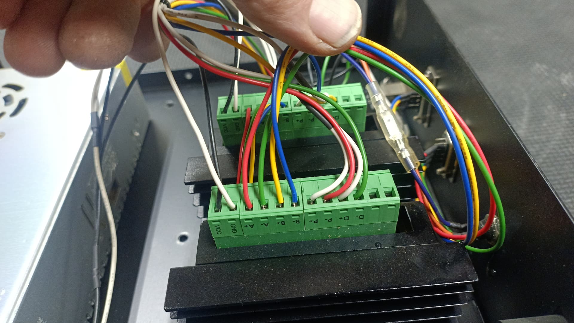

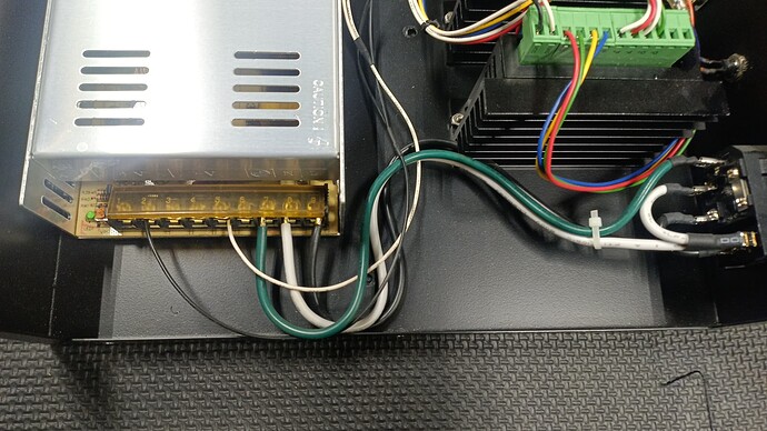

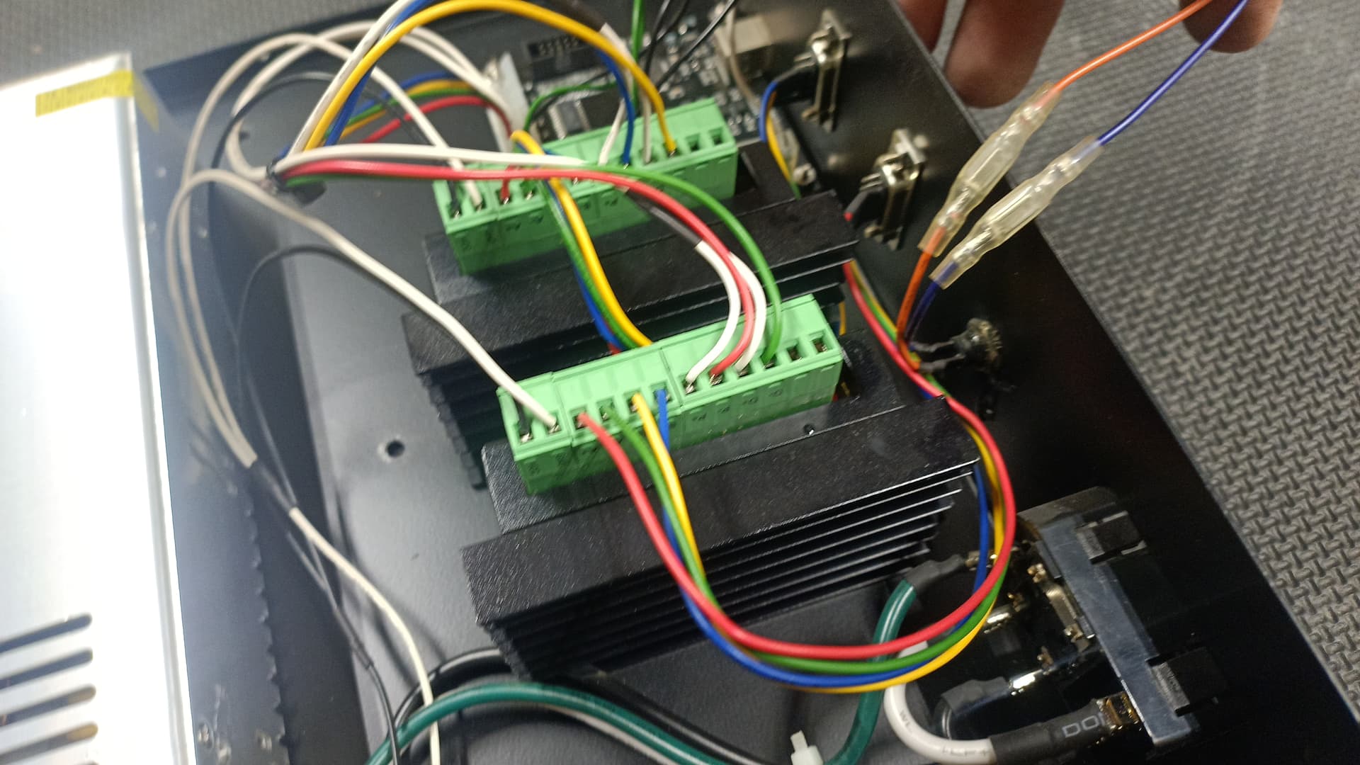

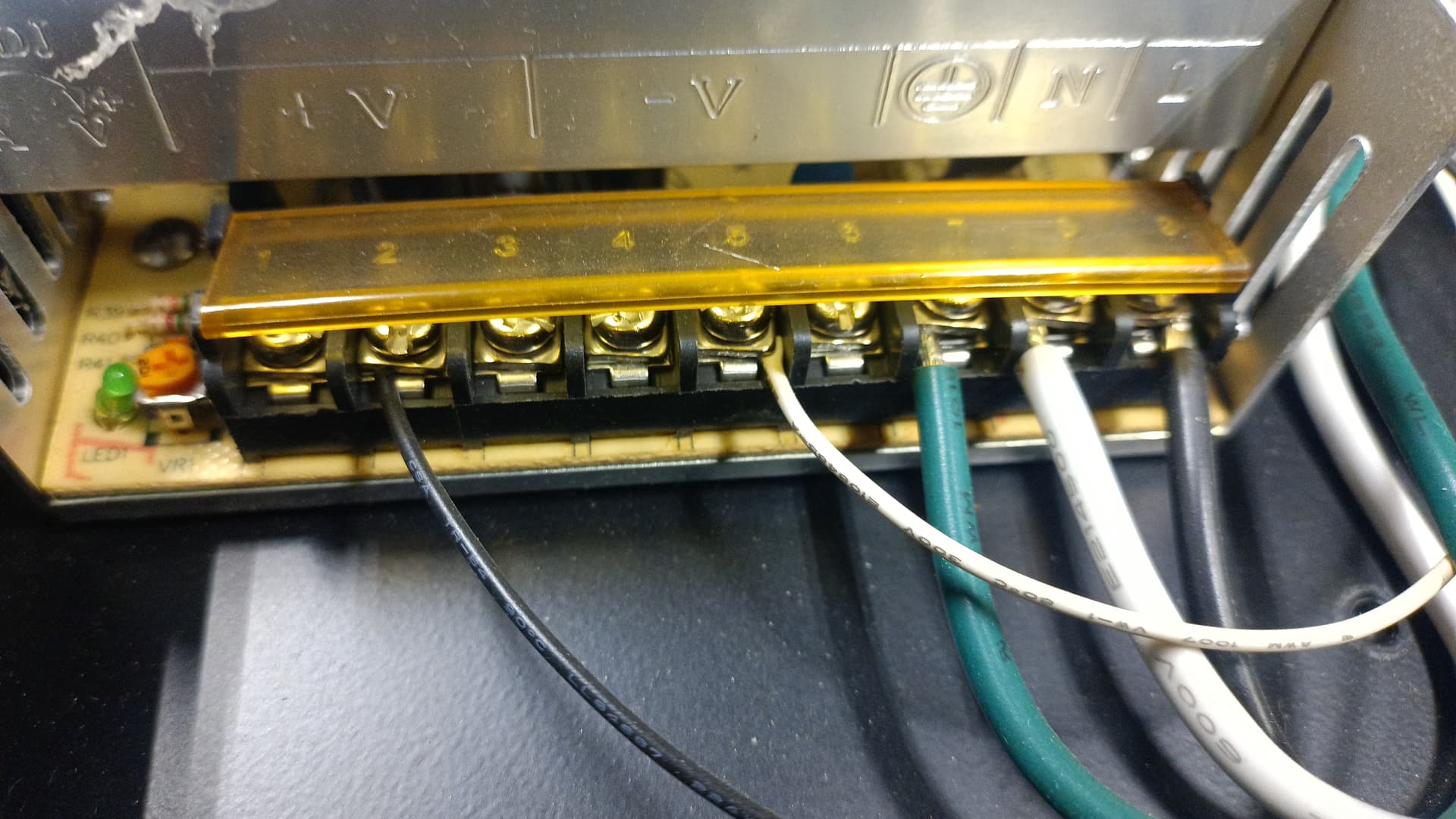

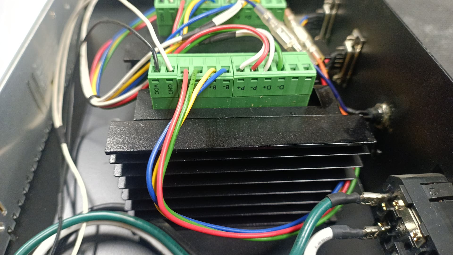

Does anyone have a wiring diagram for the the OG cross fire box that runs Mach3? The phone i took pictures with, to be able to reverse the changes i made, got crushed and i cant access the photos anymore. Or if anyone that has a box could take some pictures of where the wires connect and post them here, that would be extremely helpful. Its been a long time since i made the changes, otherwise i would probably be able to remember/figure it out.
I reached out to customer service asking if they had a diagram but they said they don’t have one. I feel that’s kinda odd that they don’t have one…

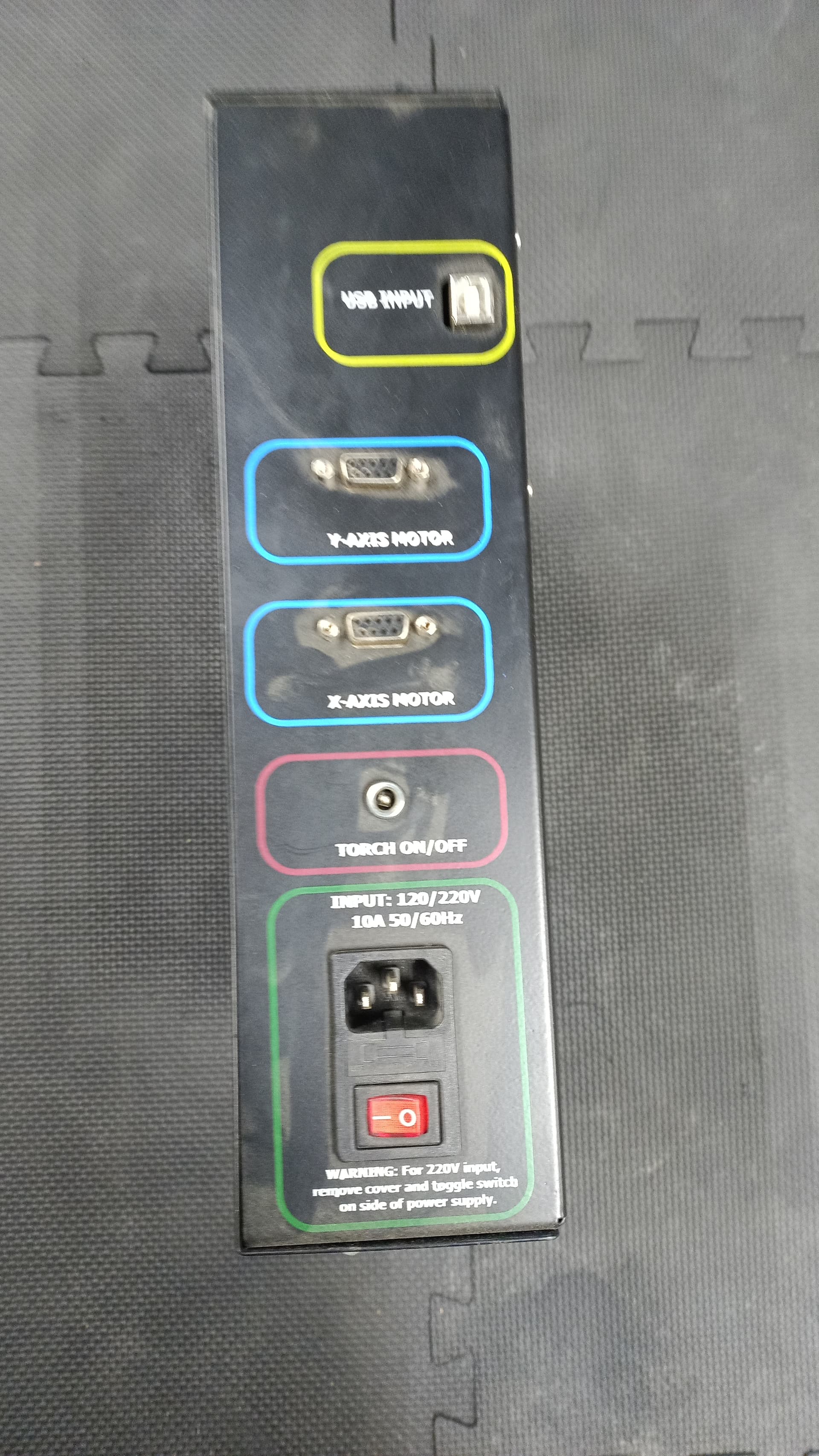

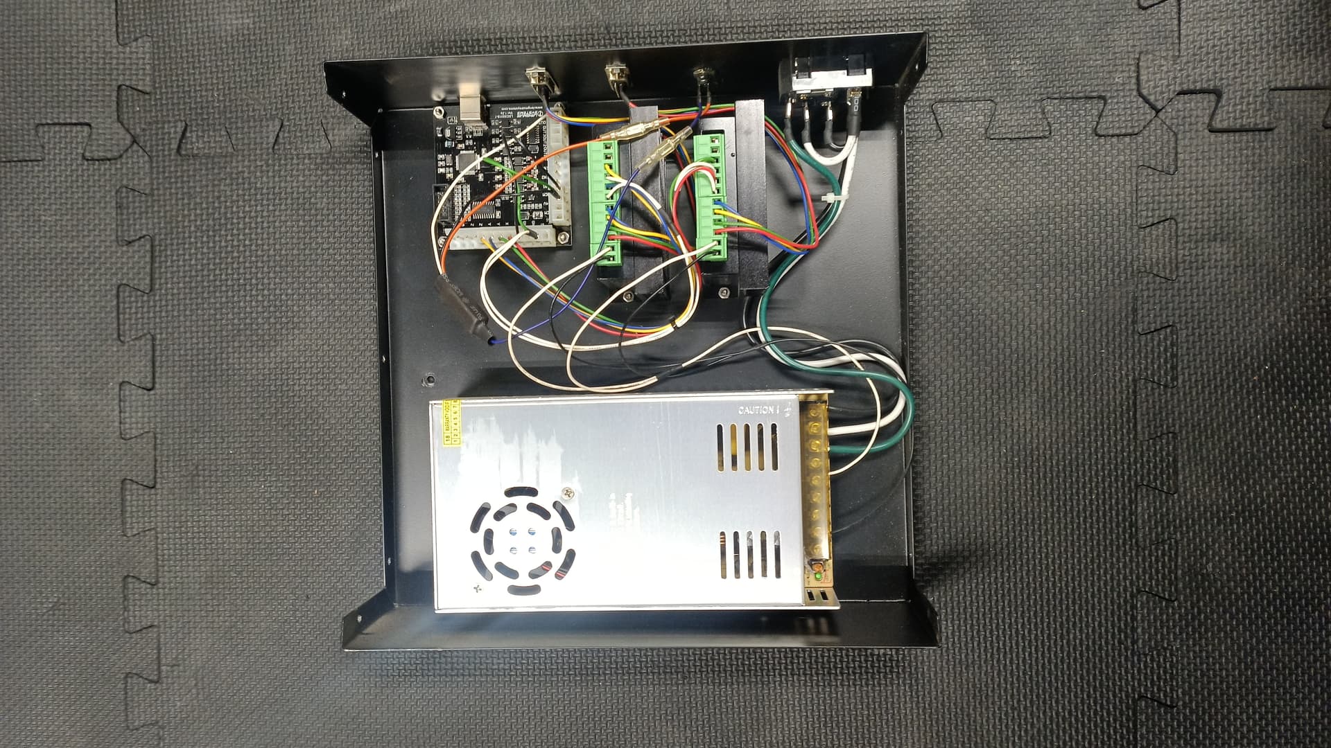

I do have a Mach 3 Langmuir electronics enclosure I can take some pictures of it after I’m done a few things this morning unless someone else gets to it first.
That would be awesome, Thank you!!
Wow! That is WELL documented! Of course, I would expect no less from Manual Man! :beers: :beers:
Thank you SO much, this is exactly what i needed to get back up and running!
