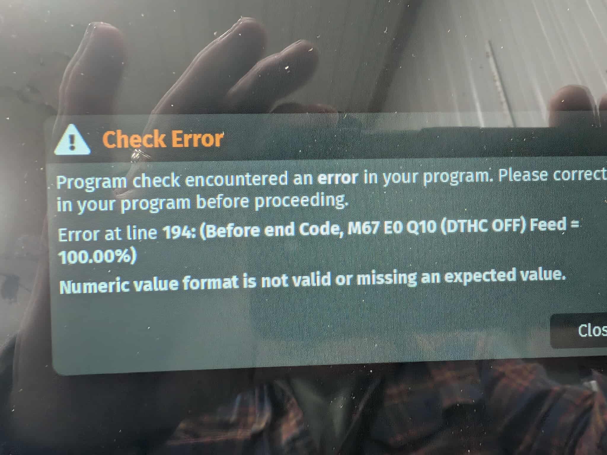

Got the table together and ready for first test cut. Updated my Sheetcam with FireControl-v1.6 post. Download file to Firecontrol and get this M67 Error. The script is just a square with a few odd shapes for test cut. I follwed the directions on installing the Post Script to Sheetcam, but must of missed something. Any have any ideals?

Unsupported GCode Command - Solved - Rule applied that turned THC off in sheetcam, not recognized - #5 by jbrown9709
it does sound like an incorrect selection in SheetCam
Did you download a tool set from someone with a different table. That M67 command is not recognized by Firecontrol.
That kind of command to turn off the THC is usually added as a code snippet in Sheetcam. That wouldn’t be there unless you added it or you got the tool set from someone else.
Excactly same issue! Thank you! Deleted them and works great!!
