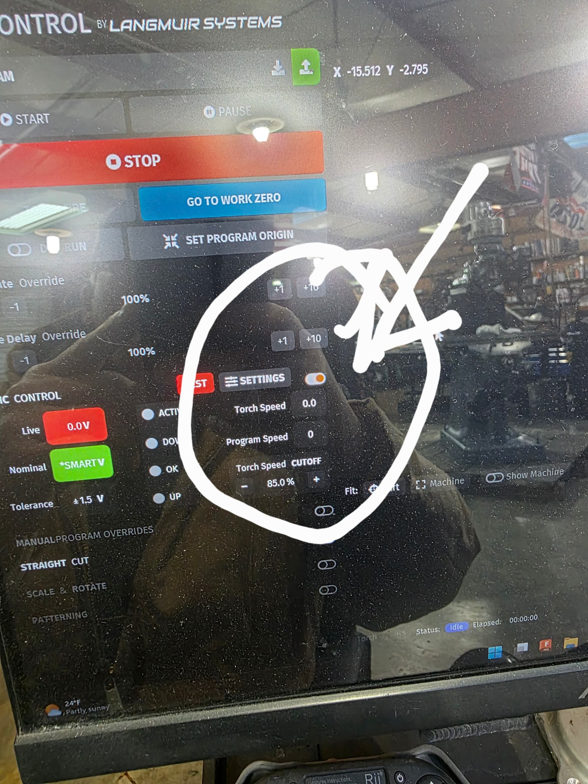

LS-THC Intermittently Connects to my pc(Solved)
On the screen, it’s turned off.
I am not sure what you mean by turned off. When FireControl says No Connections in the Height Control, the pc is not seeing the THC module in Windows Device Manager so I cannot even manually connect to it.
Oh shoot man. I did not even see that in FireControl. I will look for that the next time I can get to my machine and see if that has been my issue all along. Really appreciate the help man!!
