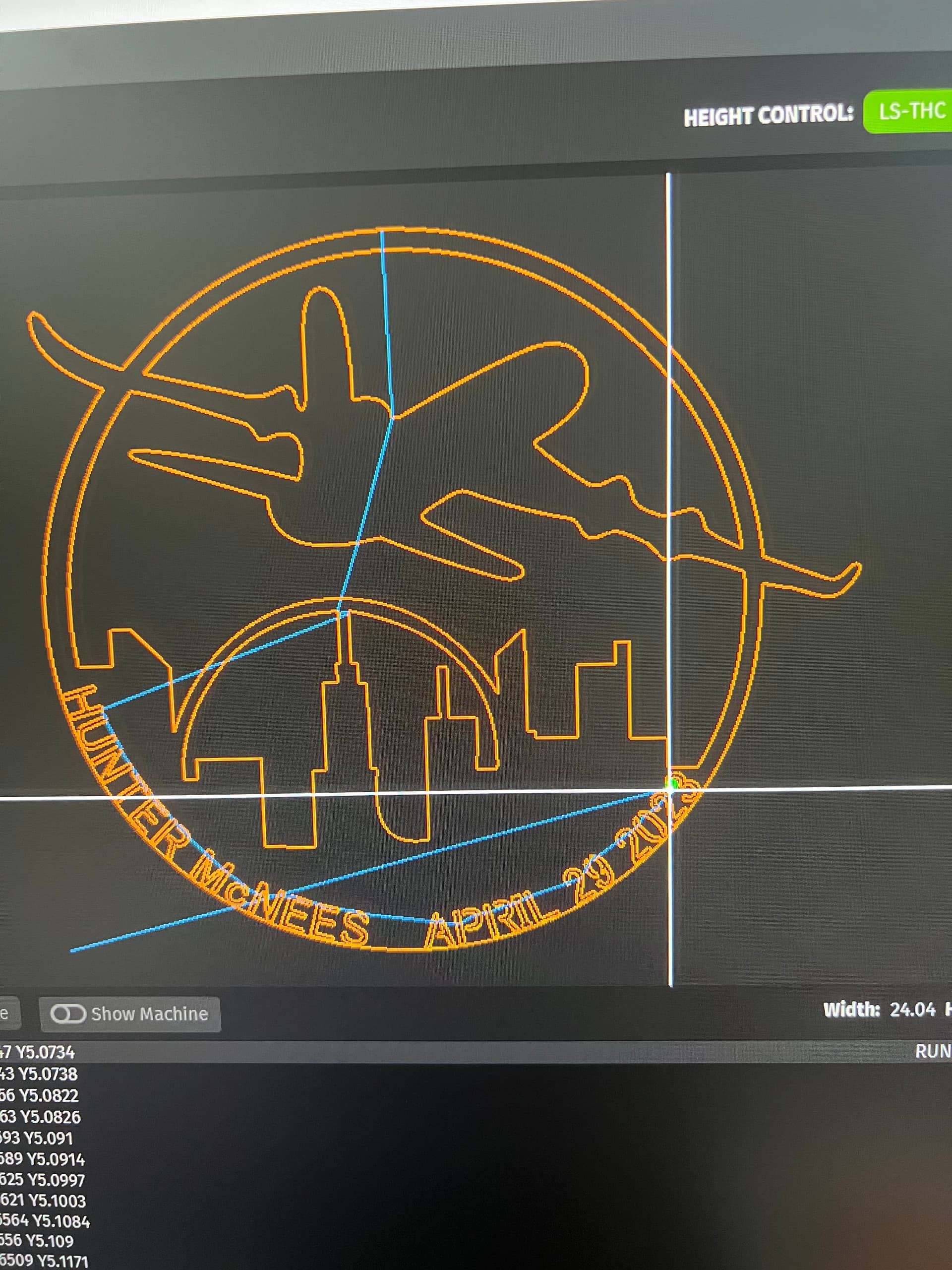

i started cutting a file with the persons name and a date part of the letters cut but others just do a pierce and stops i adjusted the pierce delay and ran from another loop it cut fine could the lettering be to small
anyone have a suggestion this a new problem for me
did you try simulating a cut in the cam software? if so did it show everything cutting?

No I didn’t try that I’ll look at it when I’m back in the shop I just don’t know why it will cut out the other areas and some of the lettering then it will only do a Pierce and stops I changed the font and enlarged the size and spacing of it still same problem

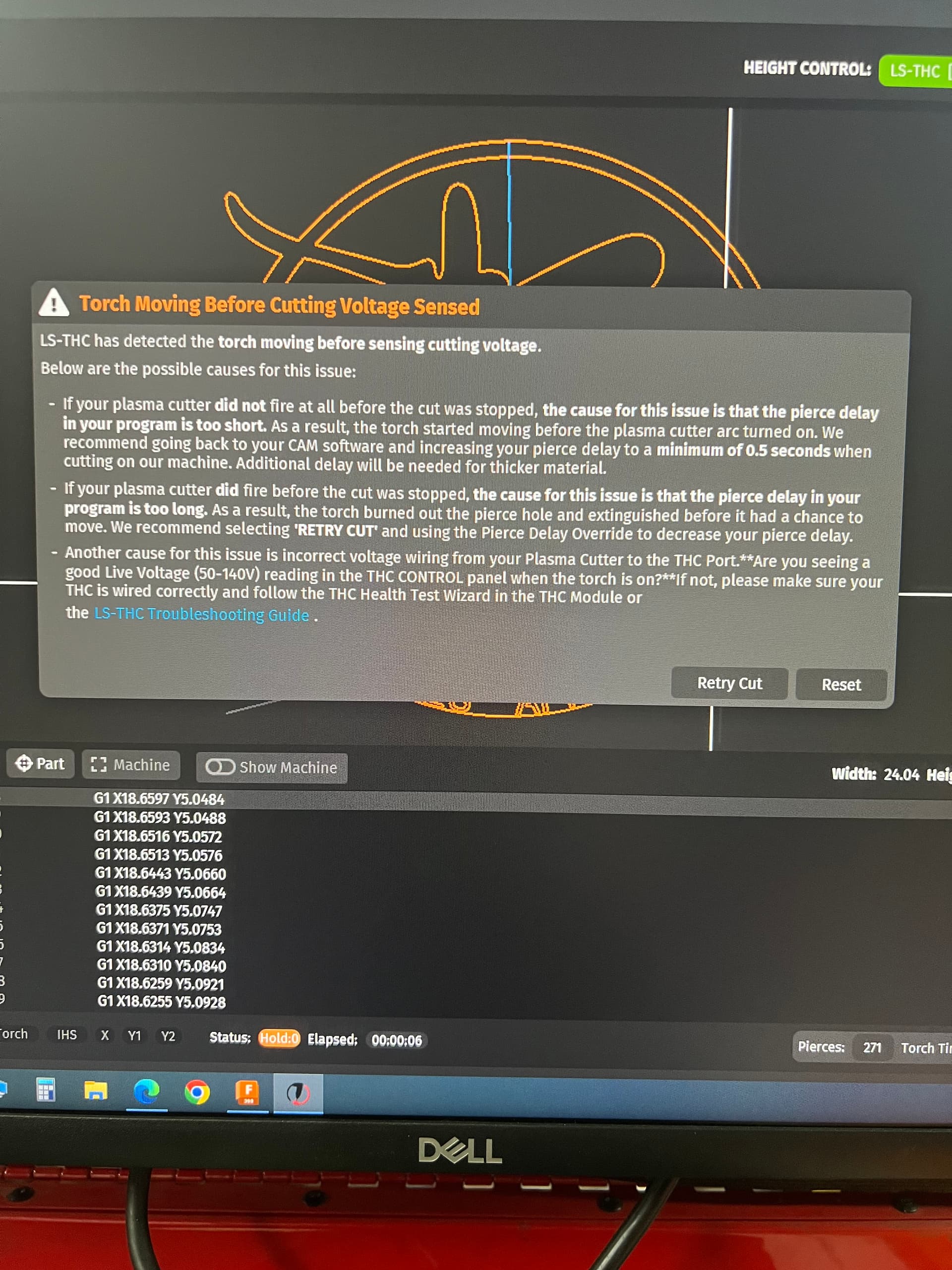

im using razorweld45 on crossfire pro with fusion 360 and firecontrol with thc pierce delay is at .5 and cut height .063 i ran simulation and it done fine i can cut most of the lettering and all the out line fine it will randomly stop and error comes up that i lost voltage during cut

i ran the manual torch fire and i dont show live voltage which i dont understand it looks like it wouldnt cut anything without live voltage
I would try increasing the pierce delay to .6 or even .7 seconds. Realize that the first pierce always has an additional delay built in. Without redoing your gcode, you could have FireControl increase the pierce delay: try increasing by 15 or 20% so that would be 115% or 120%.
I have Hypertherm so I have to set it at a minimum of 0.64 seconds or I get that message a lot if it is anything less. I am thinking I need to go to about 0.67 seconds.
I am not entirely sure that FireControl monitors the voltage during manual firing so it probably won’t show any voltage.
ok ill give that a try i watched the voltage on the first pierce it goes to 2.8 does that seem low
i changed the pierce delay but that didnt help i did run the test and shows i no live voltage so im guess i have something wrong with the cutter or the vim box getting a little frustrated at this point thanks for the help so far

it is more than likely in the vim have double checked wiring? You could have a short in your wiring. you should see well over 100 volts in most cases.

You could always work your way from the plasma cutter to the THC output barrel connector with a multimeter and make sure your voltage falls within the expected ranges, 1.2-3V at the cutter, then that number multiplied by .685, as the VIM further reduces the voltage 73:1. Figure out where the issue is stemming from and we can aid with the resolution. Feel free to review the THC troubleshooting guide for additional information.

Update on I my problem I went through the flow chart and it came to showing I needed a usb voltage isolator has anyone had to put one on their machine and did it actually work

Good morning everyone a little update on my losing voltage I’ve been talking with Langmuir but we haven’t been able to narrow it down yet but we did figure out that I don’t have enough air supply coming out of the Razorweld no matter how high I raise pressure at the regulator I only get 60-65 psi out of the plasma has anyone had this problem with their Razorweld plasma Langmuir wants me to get this issue fixed before we try to resolve the loss of voltage issues it seems like when it rains it pours in my world Thanks
You’re referring to the built-in regulator located inside the RW45? If it’s under warranty, then you should be able to get the RW replaced, just contact their support. If you’re no longer within warranty, you can take the built-in regulator out and bypass it with a short pipe nipple in its place. You should have a regulator installed off the back of the RW so you have better control anyway - it’s a PITA to fuss with the built-in one anyway :slightly_smiling_face:
