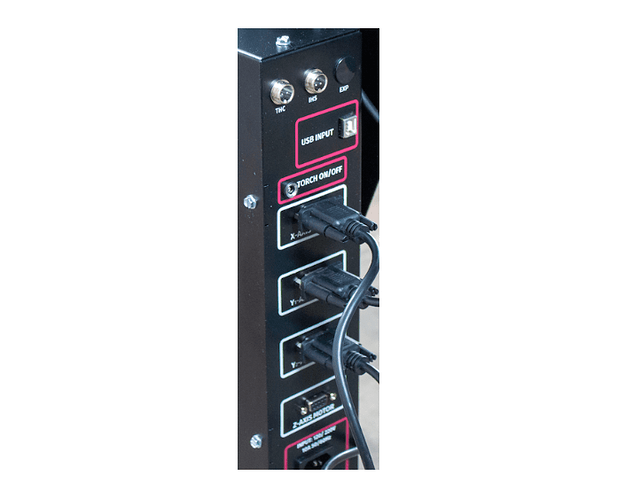

Has he tried jumping the trigger input by hand to see if it will consistently fire at the input connector
I don’t know how to do that.
He just means disconnect the cable going to the enclosure at the [Torch on/off] port:
And short across the two parts of the barrel connector with something metal (wire, screw driver). It is low voltage and just completing a connection of the wire to show that the torch would respond if it got an actual signal to fire.
Note: make sure that the torch is not going to damage something if it were to fire.
I gotcha, let me get home and I’ll try it
Tweezers work good or needle nose. Maybe flat blade screwdriver.
I did that test with the barral connector. It triggered the plasma cutter.
That tells us that the problem is inside the electronics enclosure. Either a bad relay or one of the wires from the relay to the port is disconnected.
That isn’t good then is it?
How would I narrow it down
Start with opening the case and checking the connections on the two wires at the back of the torch on/off port.
If those are good, locate the relay on the board and make sure it is fully seated.
Press the torch fire button in Firecontrol and listen for the relay to click.
Fully seated relay with no click means bad relay. Contact Langmuir for replacement.
