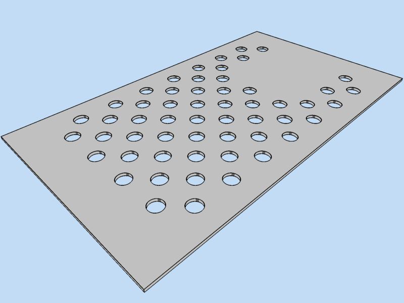

A heat exchanger project I’m designing will require 55 holes, 1.06” diameter cut in ¼” thick, 29” x 16” steel plate. With piercings, I estimate the program will take about 6.5 minutes.

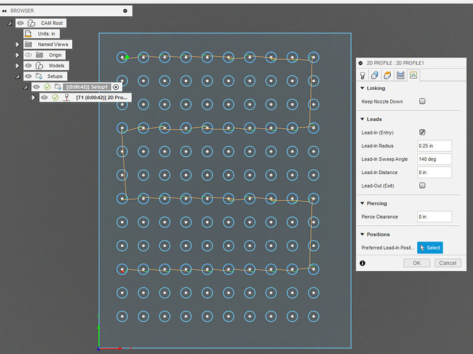

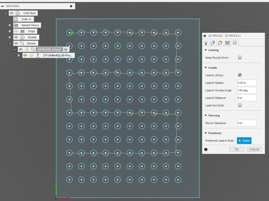

If you using Fusion 360, you could use the sketch (a body is not necessary). Pick a third of your holes (spread the choice out to limit thermal distortion of the plate). CAM that tool path:

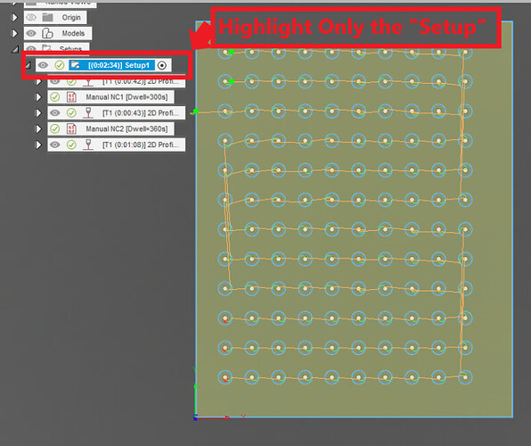

Now add a pause, known as “dwell” to Fusion 360. Right click on the “Setup” of your program and pick “New operation>Manual NC>Dwell”.
Now add the number of seconds that you wish to “pause”.
Repeat this process until you have everything. On the last toolpath, you will pick out the outer contour. For the additional toolpath for cutting you will right click on the “Setup”: “New Operation>Cutting>2D Profile”
All toolpaths and dwells are finished:
Before you go to “Post Process” you must make sure that no toolpath is highlighted, otherwise, that is the only feature that will end up in your gcode file. The only thing that should be highlighted is the “SetUp”
