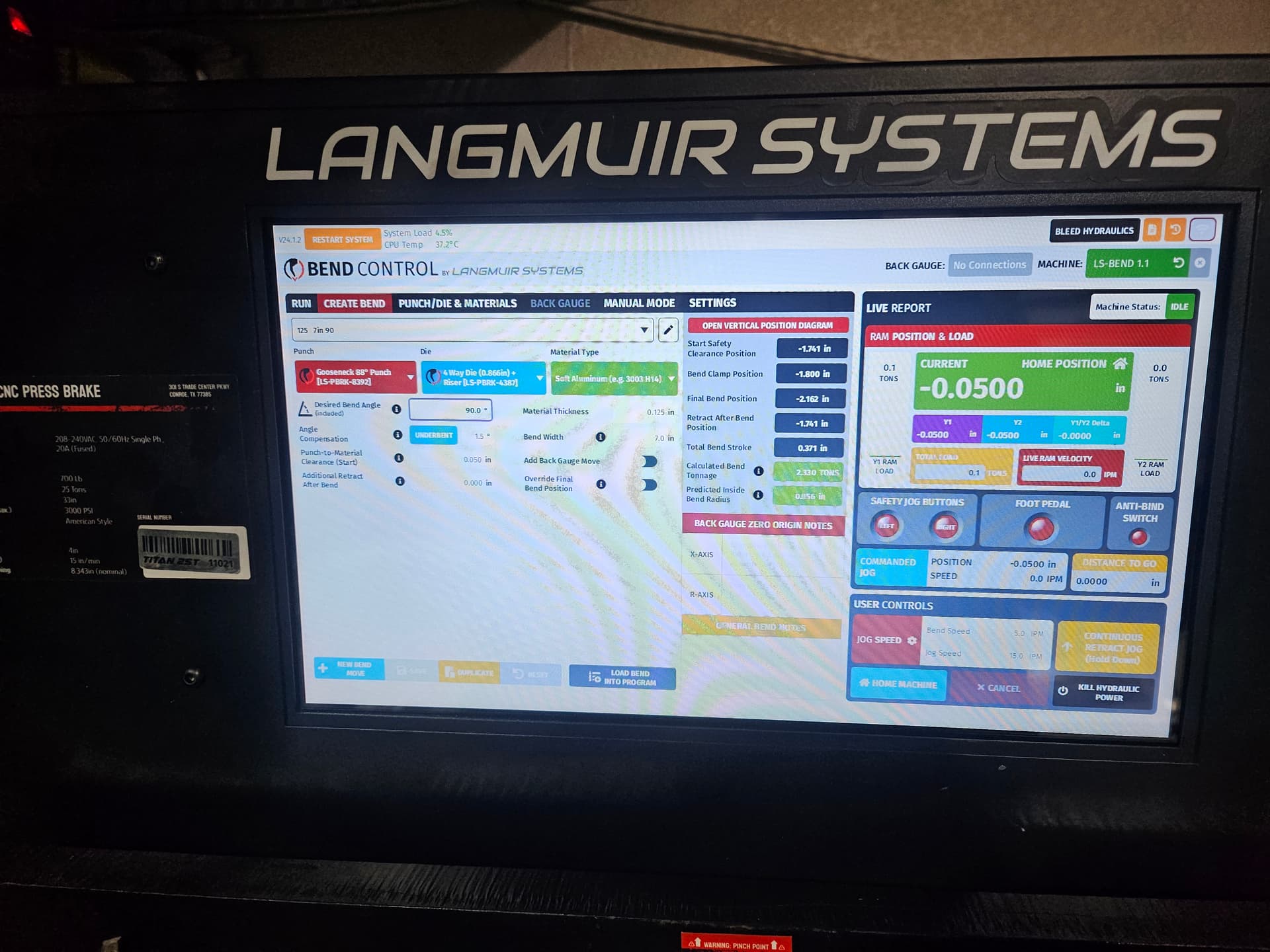

Load bend into program
I have set all bend parameters, punch and die+ material. Everything for bend should be set. When i hit load program it doesn’t do anything. I don’t see anything in missing
Try going into the run tab, making a program, and adding the bend on that tab.
I think I’m starting to figure out the program. Pretty slick​:grin::metal:t2::metal:t2:, thanks
