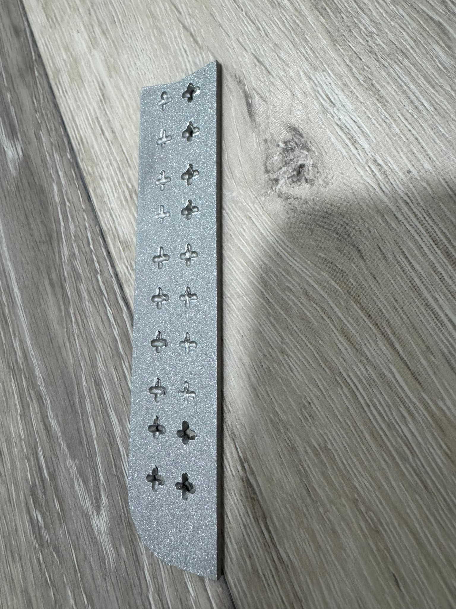

I am trying to set up a peck operation so looking for a pause. I did’nt know if there were many snippets or only a few…
You can set a pause in your jet cutting tool. It isn’t a pause that will stop the program until you tell it to resume, but you can set a length of time for pause after each cut. You can set it for a long enough time to let you pause the program and resume when you are ready.
you will need to set up a drill/centerpunch toolset and create a separate operation to do the “pecking” only.
So the first operation will do the pecks then the second one will start the cuts.
I just tried it with a pause code of m0 and simulator shows it works correctly so now I will make up a small test part and play with the amps to get my “Pecks” just right…
Pecks should be short bursts so ‘Amps’ isn’t all that important. 25A-45A the result is mildly different.
I couldn’t get my Pecks to peck so I set it up as a marking layer and got best results between 9 - 13 amps. This is 50 IPM so will try some at 100 and 150 as Hypertherm calls for…
