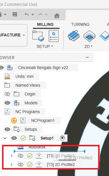

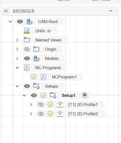

I tried this with a drawing with closed and open lines, and it seems I had to make a new cutting profile for the open lines, and when I POSTED the file, it only saved one of the paths. If I have two profiles (Setups), how do I save both in the same drawing? (NC program)

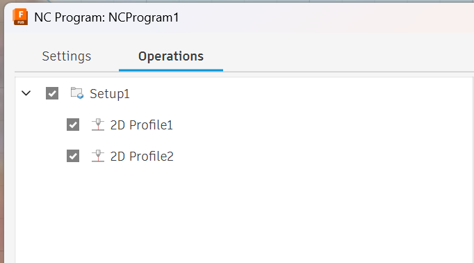

A g-code file will be created based on your selection.
If you have a profile selected, it will create g-code based on that profile.
If you have setup selected, it will create g-code with all profiles within that setup.
And yes, it is absolutely normal to run 2 or more profiles to implement different rules to different geometries.
Make sure that second toolpath has the contour that separates the entire piece from your metal sheet or you might lose the electrical connection with the cutter. You can easily move them by long press and drag into position in the browser.

Secondly, make sure you don’t have either/any toolpath highlighted (only highlight the “setup”) otherwise when you go to the gcode process, Fusion will only process the highlighted toolpath.
As Jim said, you can re-sequence so the outer border (or whatever maintains work clamp connection) by clicking on a Toolpath, hold down the mouse button, and drag and drop (when blue line appears) in the order you want the Post Processor to sequence them.
Thanks, that worked! I also noticed in the set up you can choose the profiles.

But as mentioned, just select Setup and it will automatically include all the profiles within it.
