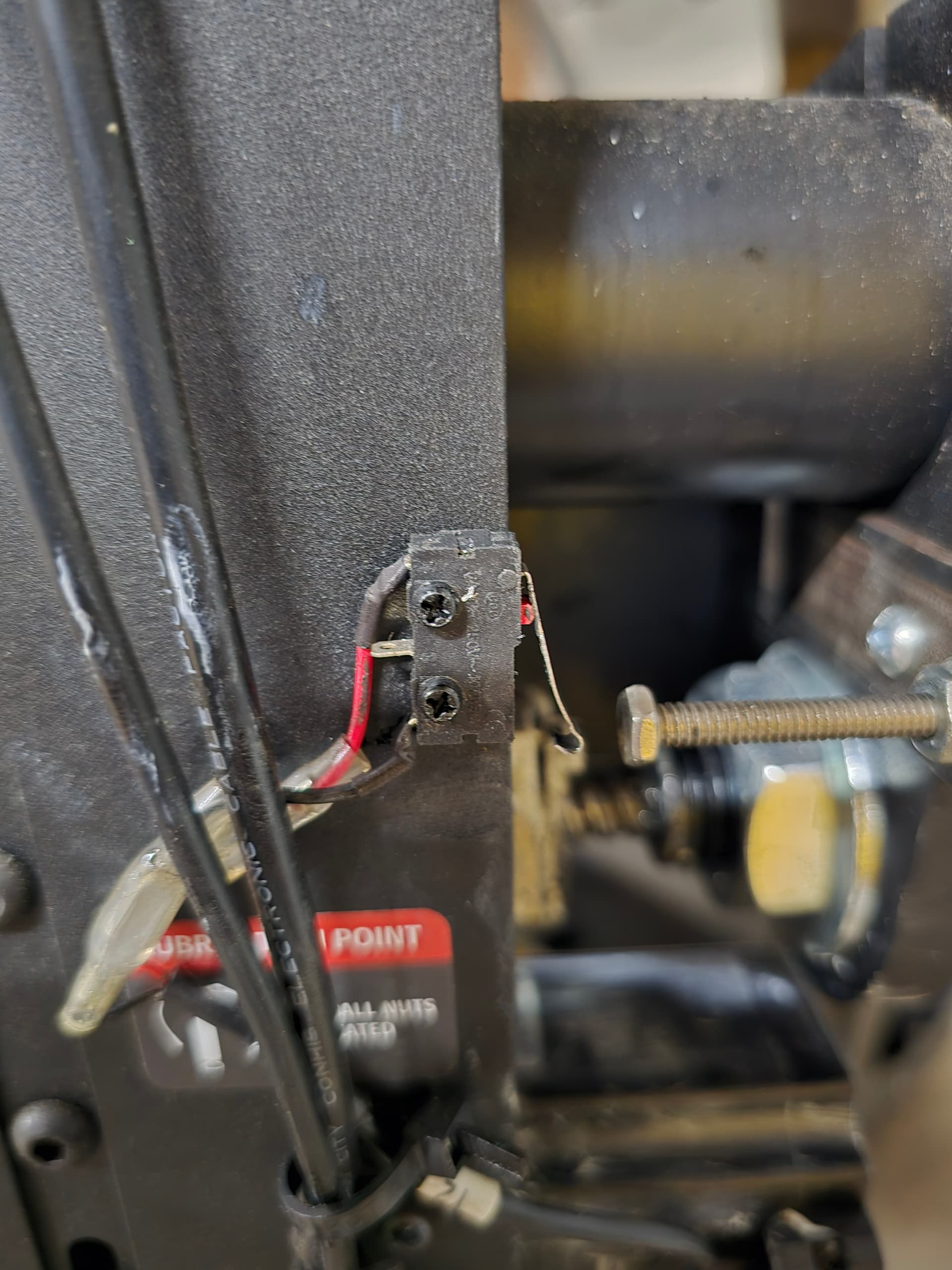

Have a look on Mouser and DigiKey for switches.
Kinda funny you say that. I was just next door on the MR1 site and they seem to be having the same issues. They posted a link to some better switches that can take fluid. I think my original post is correct that these switches are garbage.

Nothing is impossible, could also be a bad lot from the mfg, or the mfg changed the spec on the internal components for some reason and it is prone to being unfriendly in other than clean environments.
I used the same switch to control my exhaust brake on my 02 Dodge Ram for 15 years. On the throttle pedal subjected to dust, mud, snow…never had a problem other than literally packed with nature and had to be cleaned out around the detent portion and the lever.
This is a comment in regards to those of us who have had trouble with the limit switches or who will have trouble in the future
I was getting a live voltage reading like so many others on one of the limit switches and purchased some new ones that one of the other members shared a link for. I reinstalled them but noticed i was still getting a live voltage of around 5 volts even though it was a new switch. I know it was something with that particular switch because when i depressed it the live voltage went to zero. Puzzled, i took it off again but left it plugged in and noticed my live voltage went back to zero. So it dawned on me that maybe the screws are grounding out the switch somehow creating a voltage reading. So i purchased some nylon screws from amazon and installed those instead and so far i dont have a live voltage reading which is a relief.

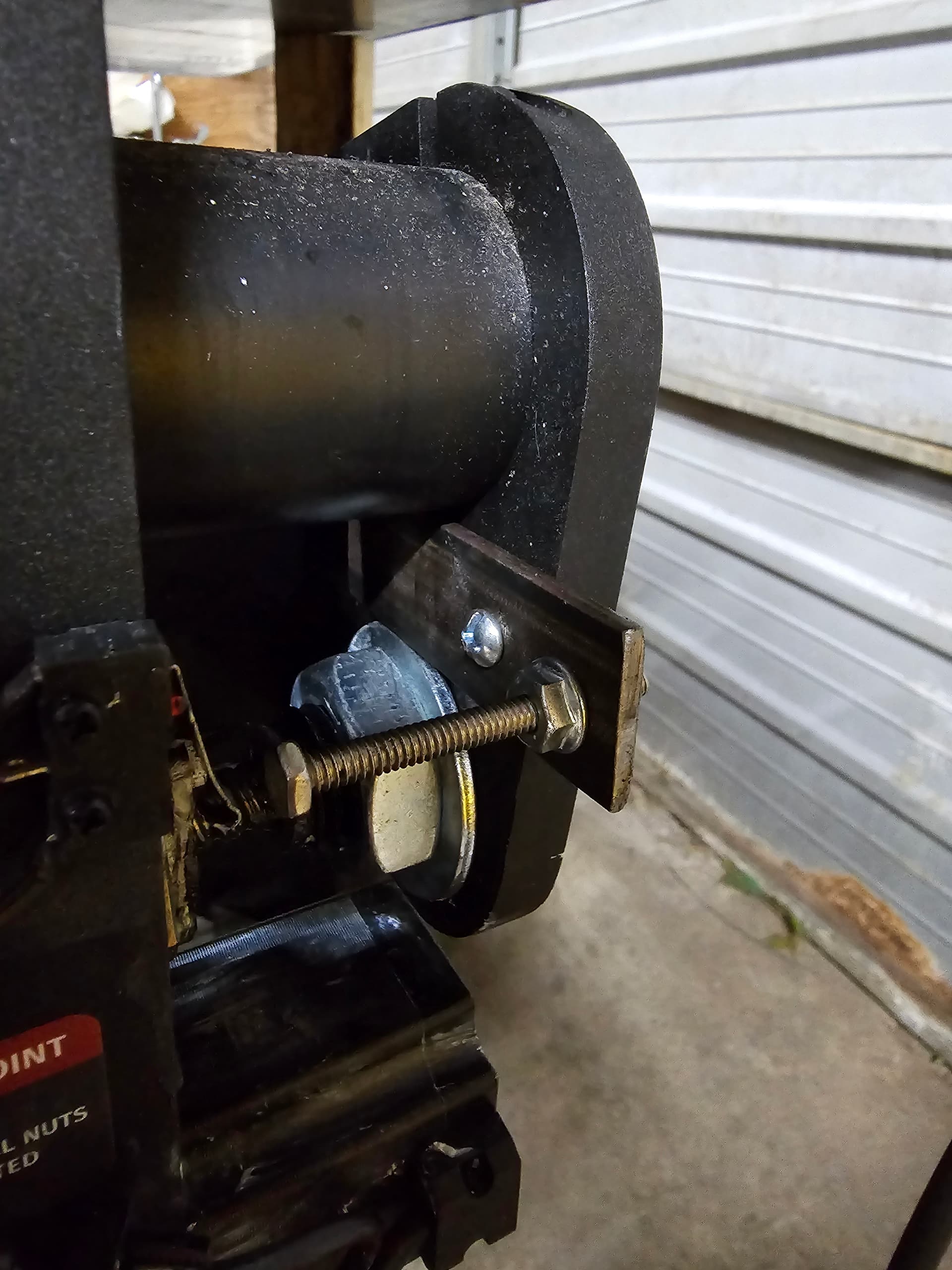

Another thing i changed was the limit switch location. I got tired of cramming my big hands in a tight space to try and unscrew them so i moved them to the outside of the gantry uprights for easier access and used a piece of flatbar to move the limit switch stop further out
Here is the link to the nylon screws on amazon, this was an assorted box since it was the only one i could get overnight, the nylon screw that i needed was the m2.5x10 mm and you can order just that but it might take longer to get in from amazon
MCMASKE 750PCS Metric M2 M2.5 M3 M4 M5 M6 Nylon Phillips Pan Head Screws Hex Nuts Flat Washers Assortment Kit(Black) Amazon.com
Great info. Might give that a try.
