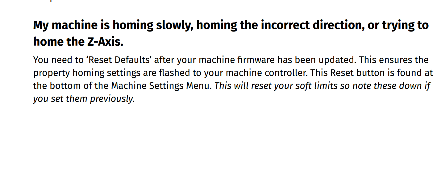

I installed the limit switch kit, I enabled limit switches in settings. When i activate home the z access just runs up forever and grinds. The machine works fine otherwise and cuts no problem. I tried a different laptop and updating the software but same results.
Thank you, I guess next time I will use the search function. All is well now
