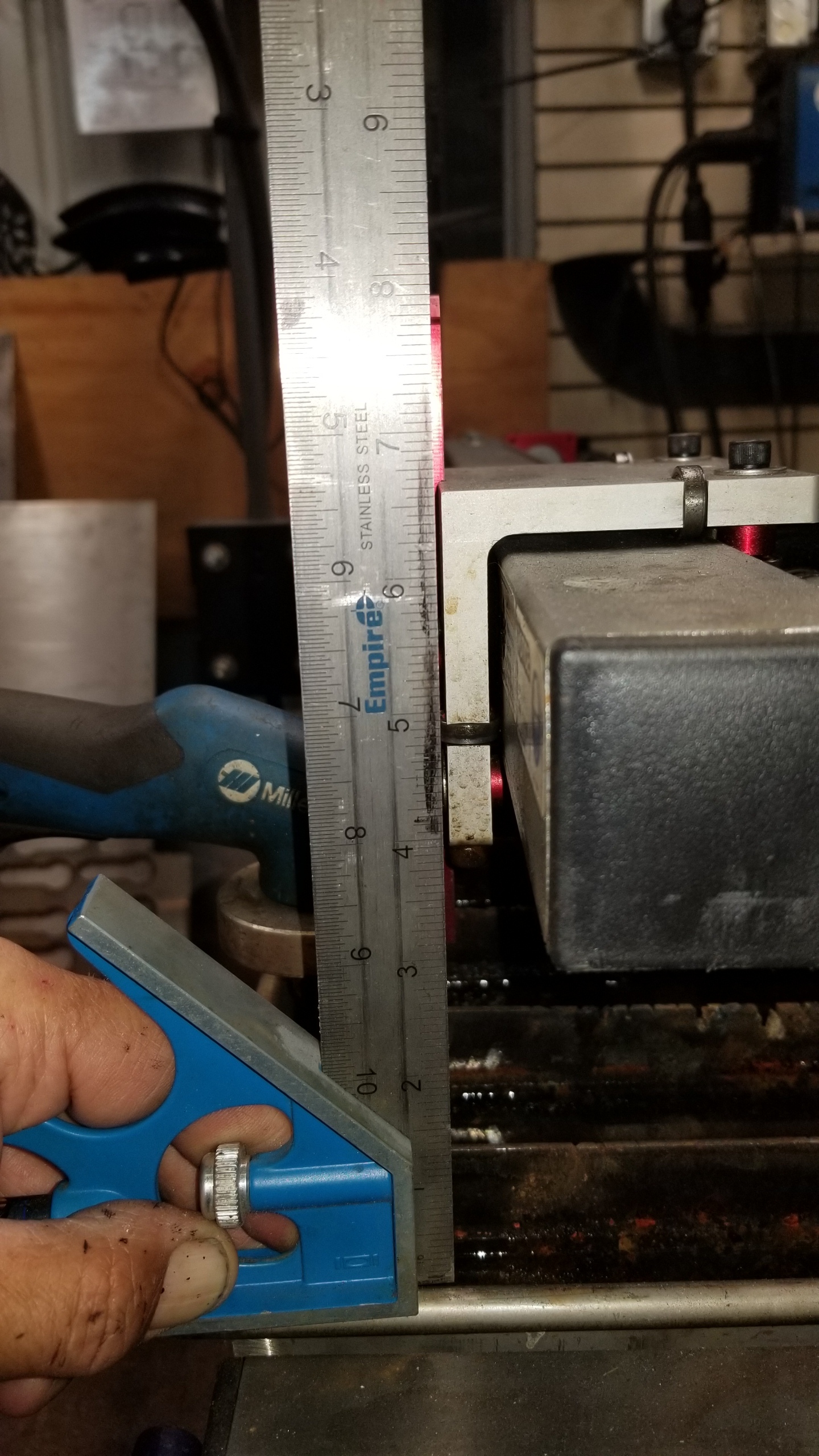

So it sounds like your torch holder is not square to you table. If the bevel on a circle is one way on one side and the other way on the other side then it is most like your torch is not square to the table.
Check this on you table:
It is pretty easy to square that up, I did it last week. There is a video on it on the assemble series.
this is from checking the above
That’s looks square from here, don’t know what else your troubles might be.
