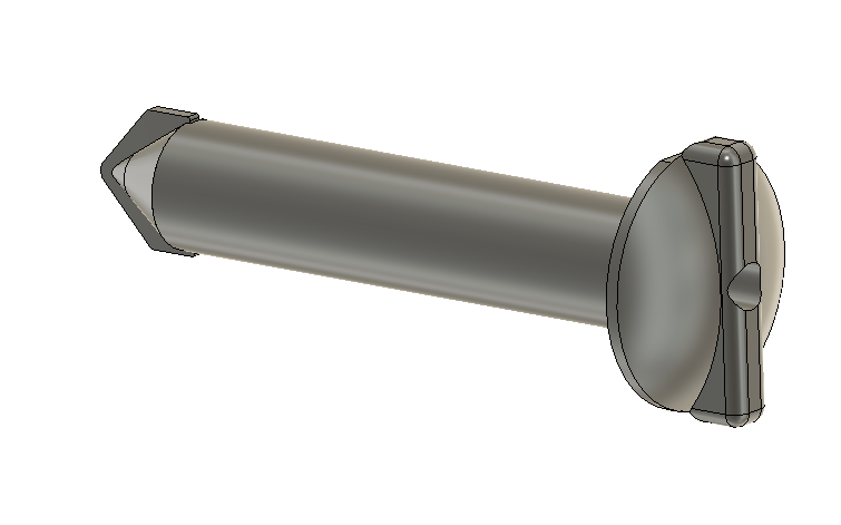

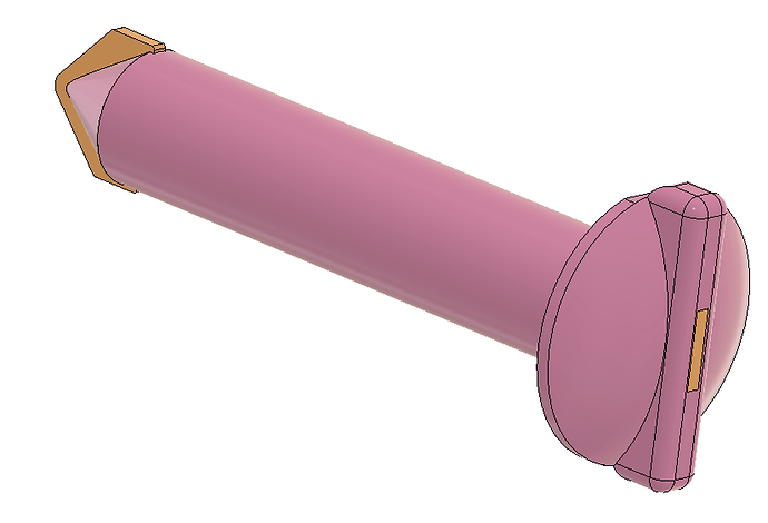

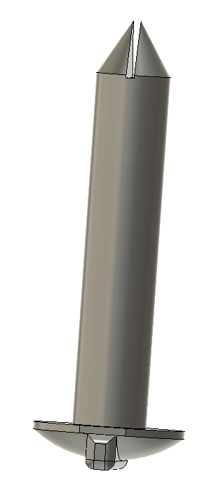

Print it on its side. Use the appropriate filament (ASA or ABS).
Where there is a “will” there might be a “way.”
What Tim says is very true. I am new to 3D printing and things that don’t need to be so strong will come out much stronger than necessary and then those things that need the strength, sometimes fail my enthusiasm.
Printing something like this on its side, would definitely be the way to go. The layers would give the strength in the long direction.
If you used something like ASA CF or NYLON and then glue a metal pin down the middle it might just do the trick.
I have not printed with Nylon but I have printed with ASA and ASA CF. Both are very strong but a 1/4 inch thick piece of ASA will not hold up to repeated shooting with a high powered air soft rifle (firing at about 350 ft/sec). At 15 feet, it will survive one hit but after at 3 to 5th hit, it will break. So shock loading on it seems to be tough.
So it might not work if you are expecting it to hold like 20 or 30 pounds with lots of vibration.
It is a fun notion and perhaps others might weigh in on this problem.

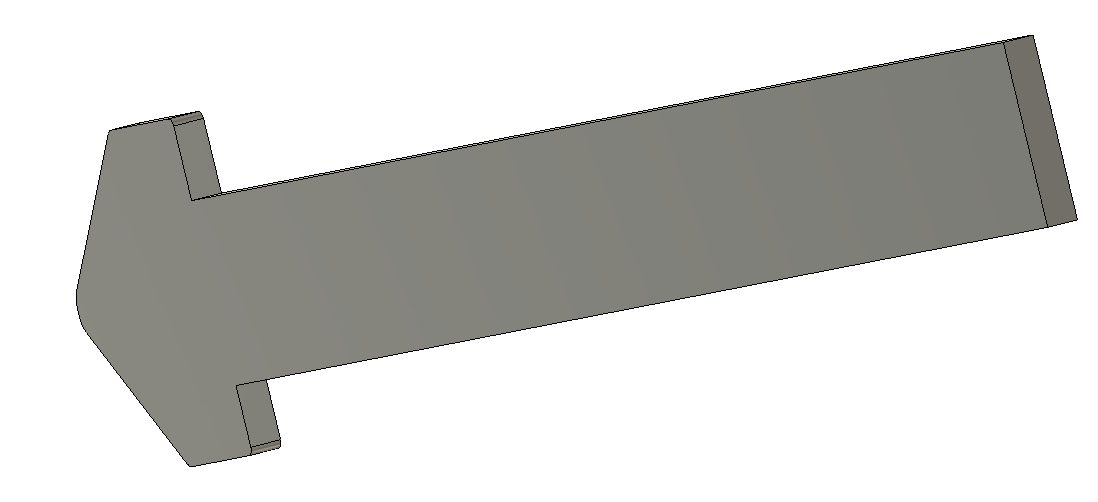

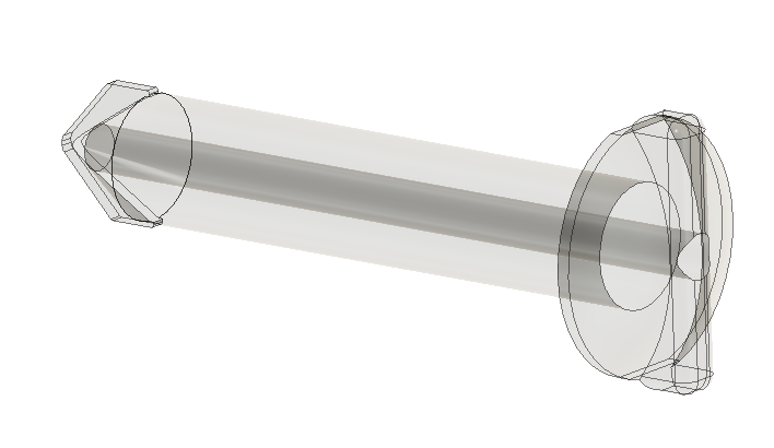

What about this idea?
The locking wings of the fastener is cut out of metal: hence plasma cut:
It fits into the slot that can be made since we have 3D printers. This shape hole would really need to be formed by the print to orient vertically.
Now you combine the pieces and you have the strength you need and the fit that is required…perhaps.

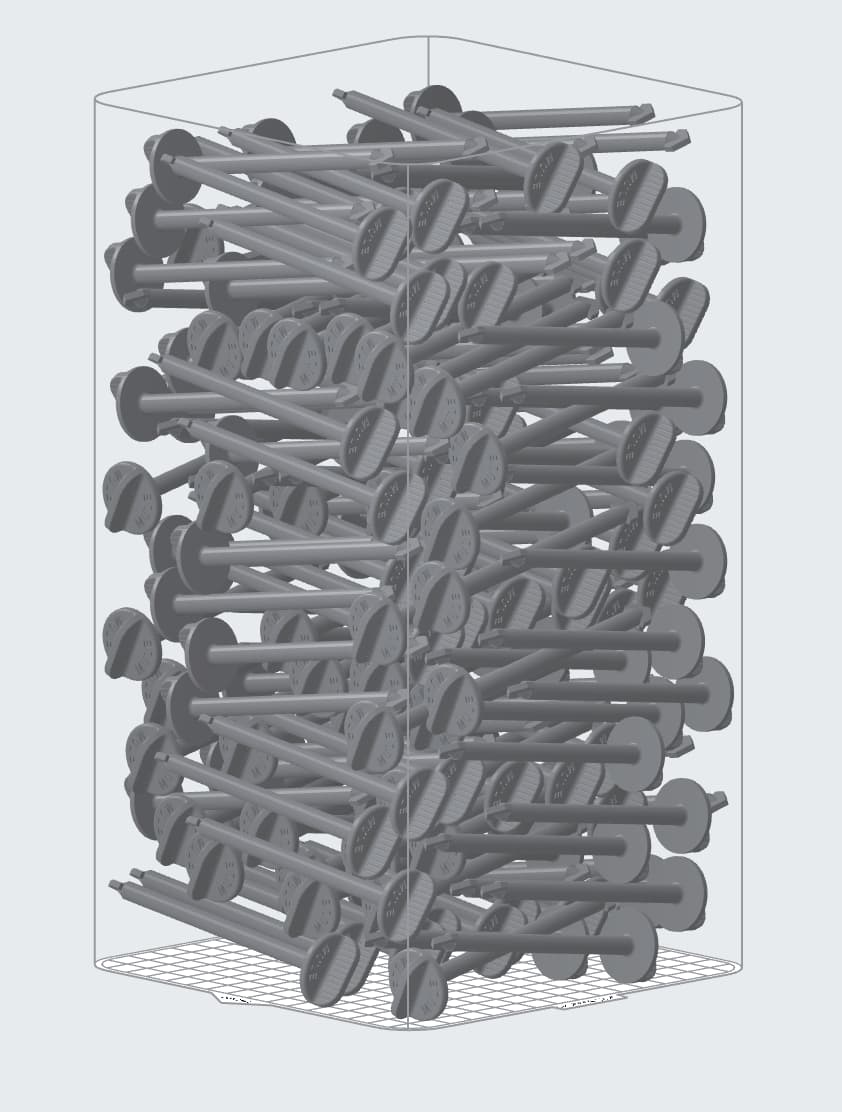

I have 2 x SLS printers. If you can send me a cad file (step, stl etc) I will print them free. I can do them in PP. I have some parts to print next week so I can include these in the build chamber.
Along with Craig’s offer, I would be willing to share my file or fine tune it for you if you gave me more precise dimensions.
I charge nothing for the design…just fun for me.

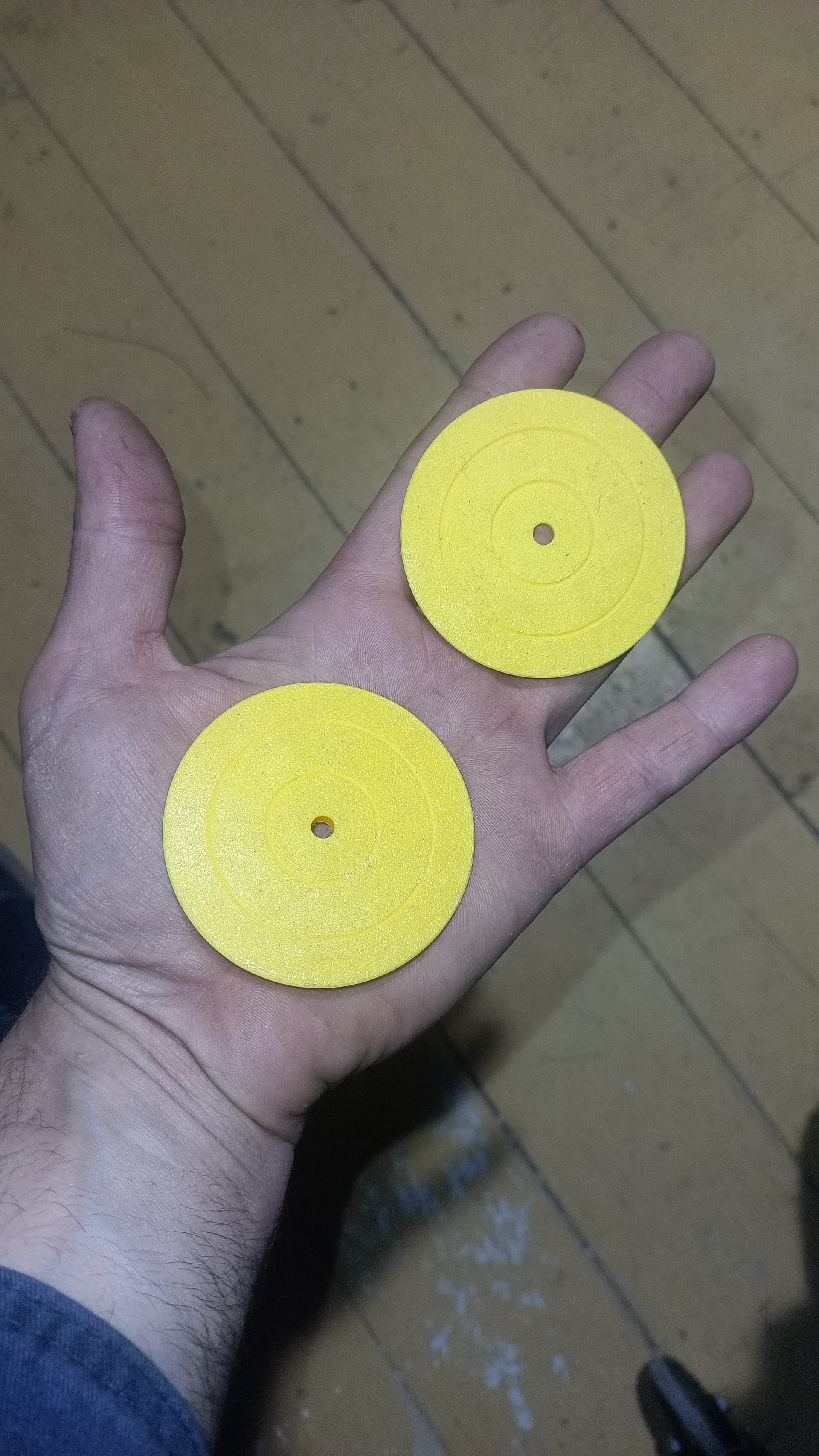

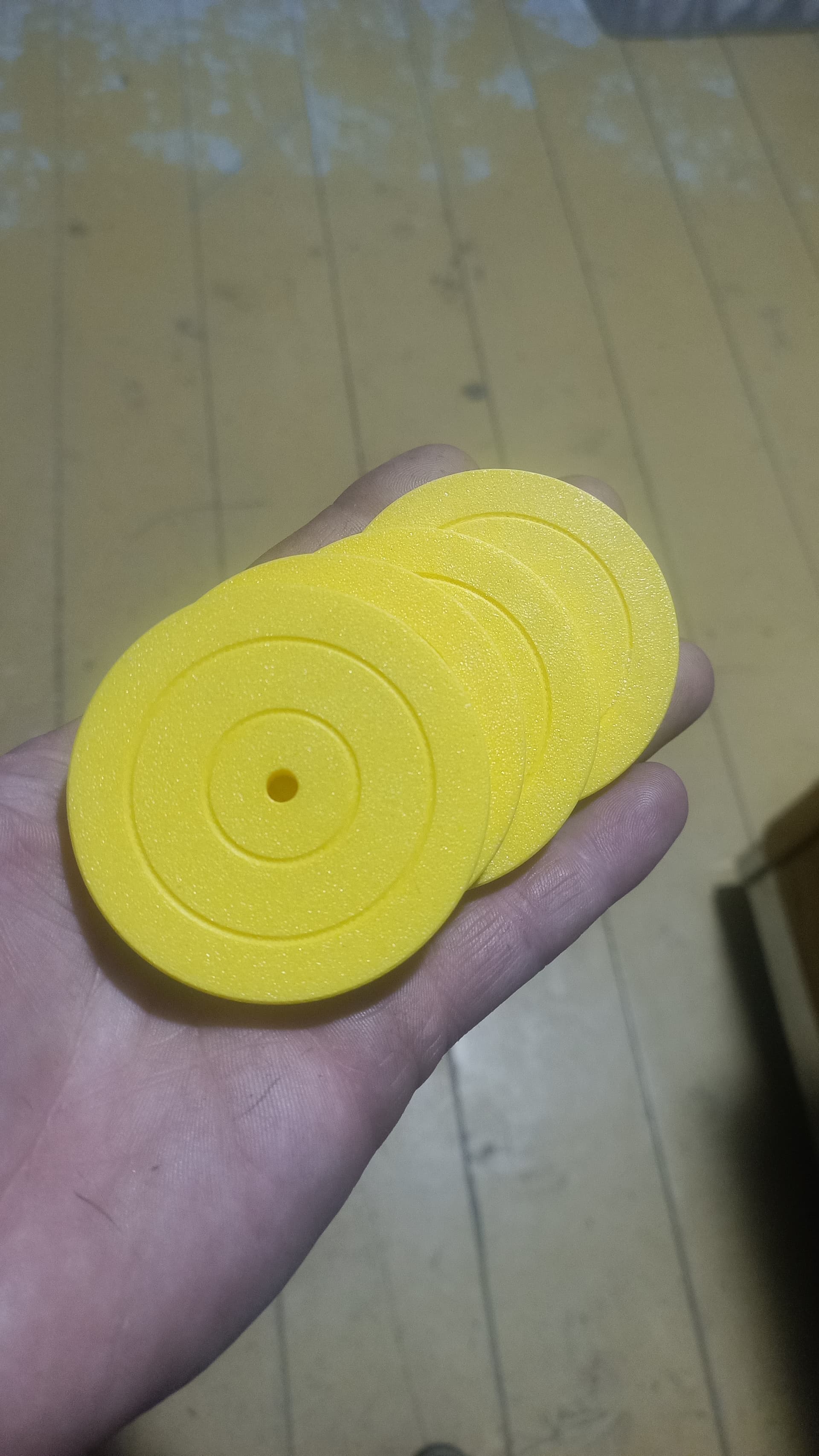

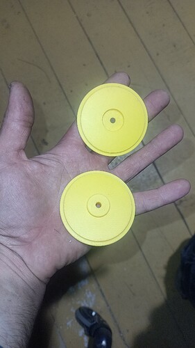

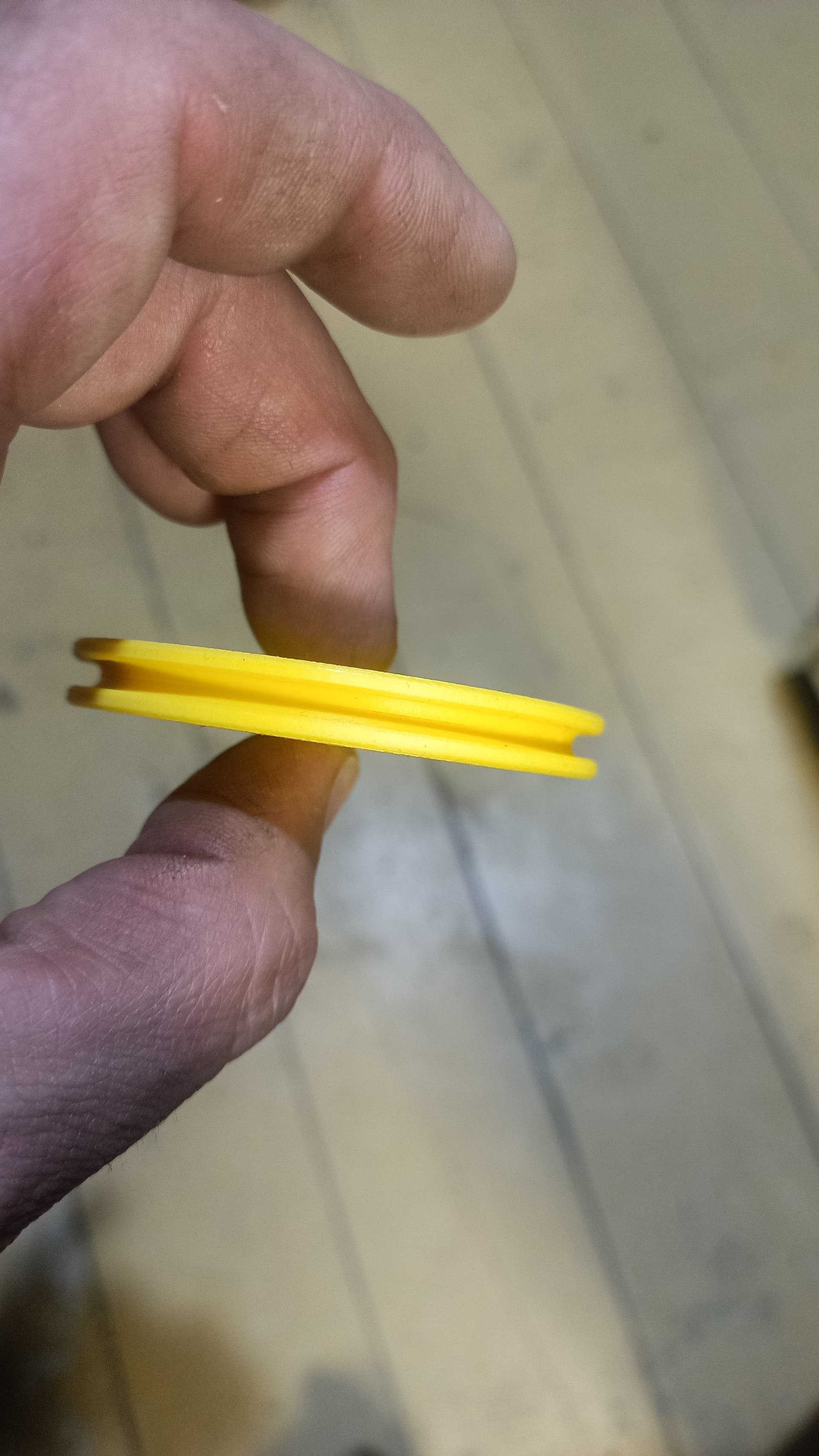

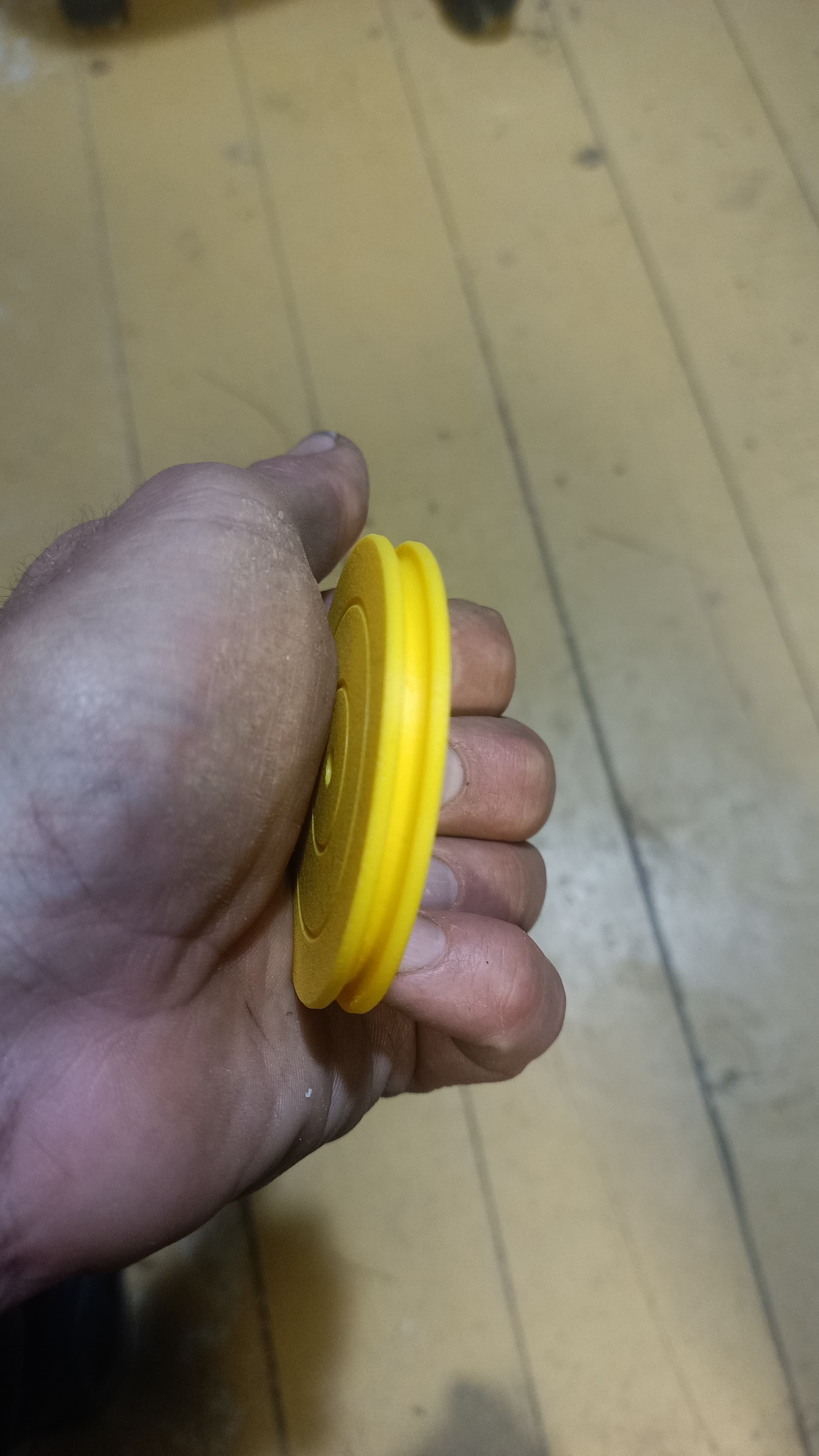

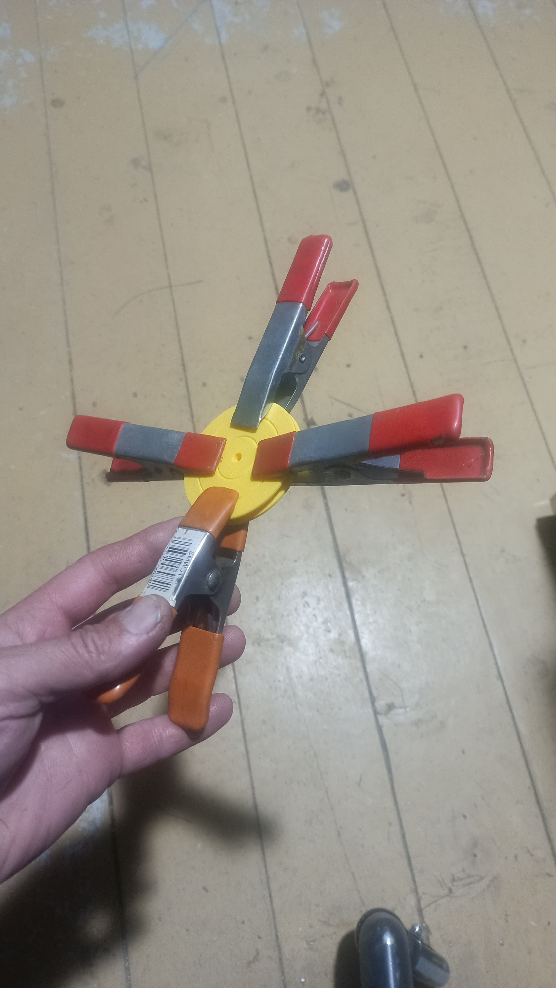

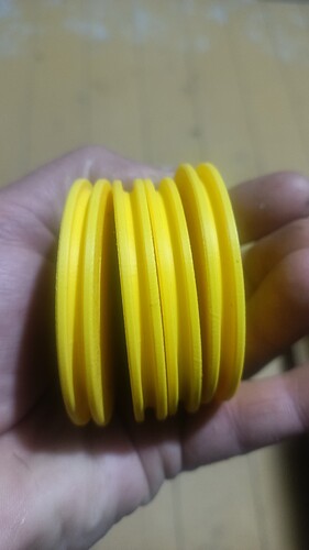

Printed a set of pulleys for a friend today.
The original model that I was sent was a single piece and it made it hard to print with the narrow channel and keep the groove smooth. I split the drawing up into two pieces with a bit of a keyway lock. Glued them together and they seem like they’ll work very well
Very, very clever. When I first looked without reading I said “Now how did you do that!?”

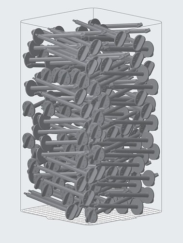

Thanks Jim, One of the neat things about SLS is the lack of supports as the powder is the support material.
Take Marty’s pin for example, I could print 172 at once, It would take about 24hrs to print the entire build camber. This how I’m able to help Marty and anyone on the forum. If I’m printing a part for a client and its a big part, I’m able to place smaller parts inside, print time is no different as its based on layer height.

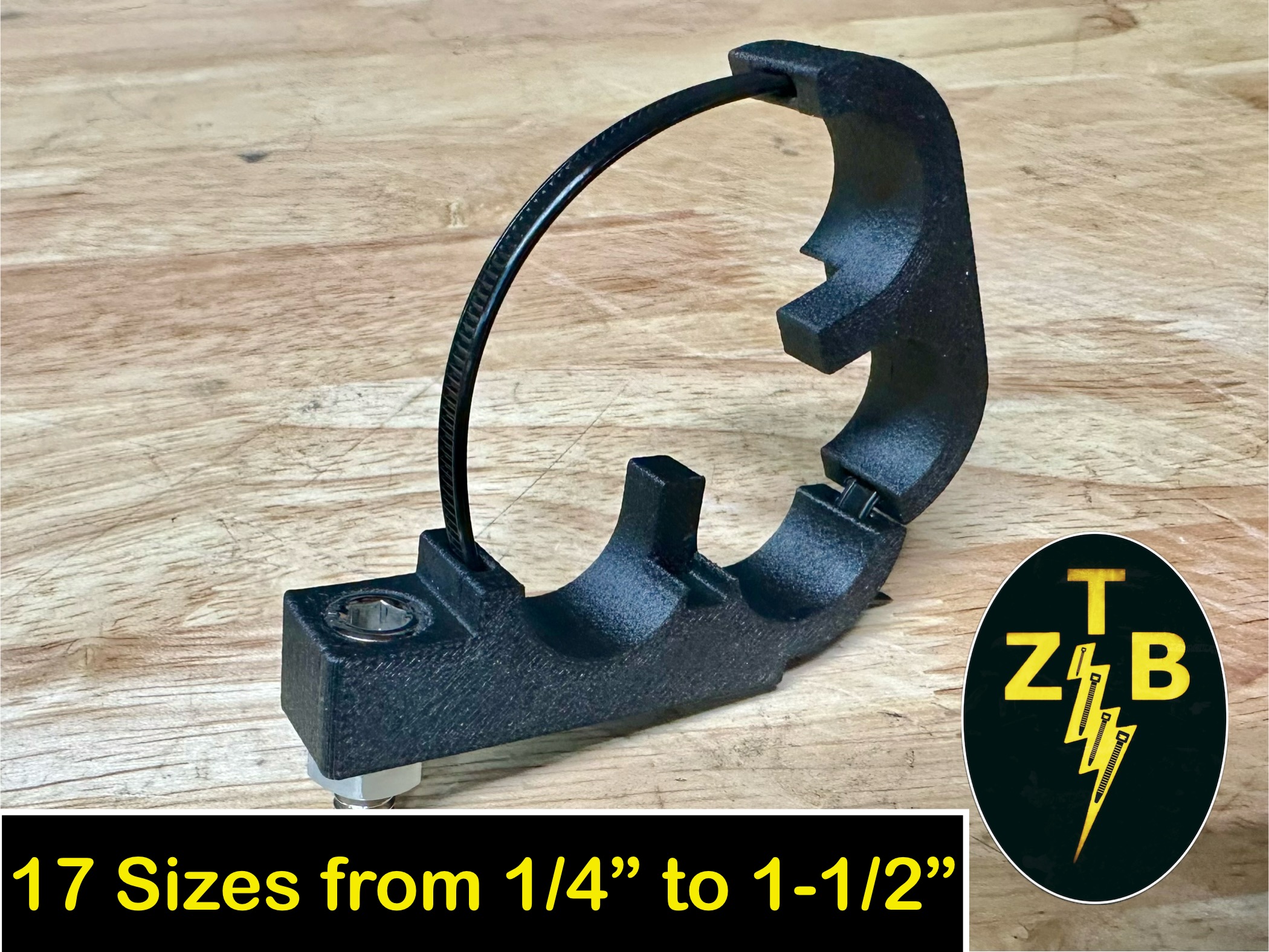

So, I call this thing the “Zip-Tie Buddy”. It’s a stupid simple little interlocking two-piece cable (or hose, or…) clamp, available with or without a built in mounting tab, that secures in place with a single zip-tie. It provides firm clamping AND separation of your work, and I modeled it parametrically so that I could crank them out in any sizes and/or combinations that people wanted to have.
And the “Zip-Tie Buddy” is actually kind of taking off; I’ve had a couple hundred downloads in the first week, which already puts me about 1% of the way towards my free H2D! :joy:
Anyway, there are a bunch of different versions of “Zip-Tie Buddy” available to download on my MakerWorld account, and I’m in the process of making several more versions right now. I can see literally limitless applications for these things, and I figured you guys, who ALL deal with a fair bit of cable management, might appreciate them. All I ask, if you dig this design, is that you share it with someone else.

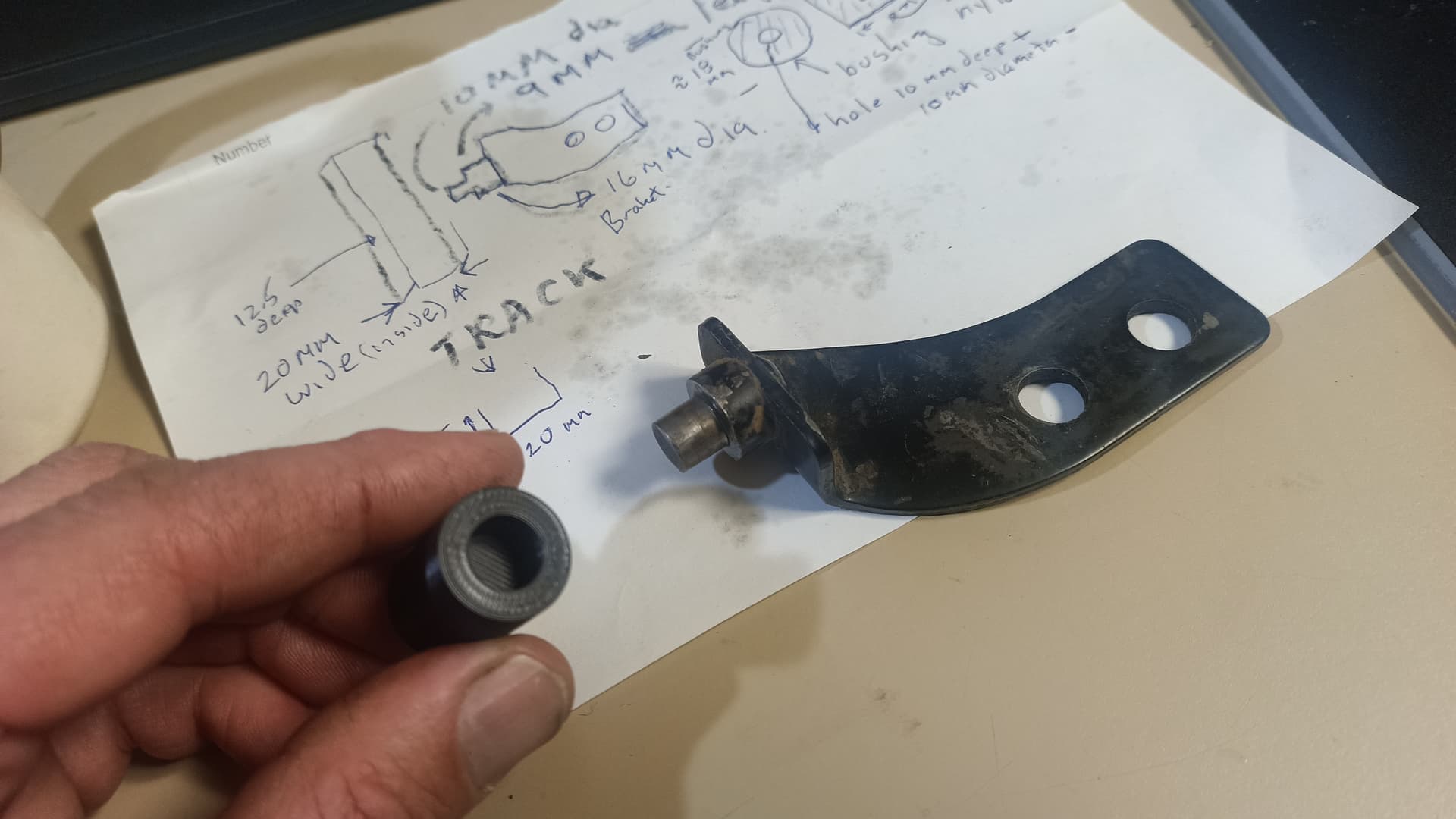

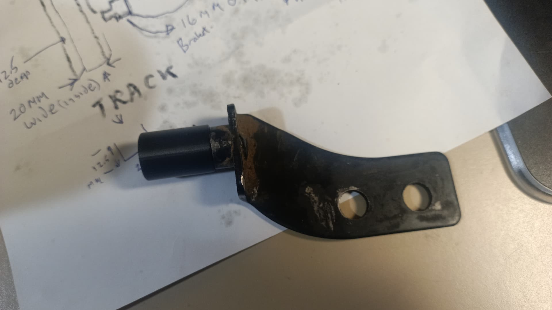

A replacement bushing for the roller on a mini excavator window bracket.
Printed at 100% infill.
I thought about doing it at ABS but we’ll see how long the PETG lasts
Quite set of measurements was dropped off with the bracket :laughing:
Perfect example of how the 3D printer proves useful.
