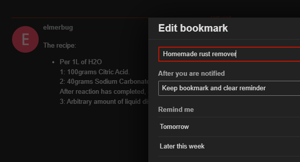

The recipe:
  • Per 1L of H2O
    1: 100grams Citric Acid.
    2: 40grams Sodium Carbonate / 63Grams Sodium Bicarbonate / 30grams Sodium Hydroxide.
    After reaction has completed, add final ingredient.
    3: Arbitrary amount of liquid dish soap.
NOTE: Sodium carbonate is the only second ingredient needed. The sodium bicarbonate and sodium hydroxide are listed in case sodium carbonate is unavailable.
You are now a book mark for me:
Cool. It’s just as good at mill scale removal as well. Amazing stuff.
Jim, it might be a good idea to add this note: NOTE: Sodium carbonate is the only second ingredient needed. The sodium bicarbonate and sodium hydroxide are listed in case sodium carbonate is unavailable.
