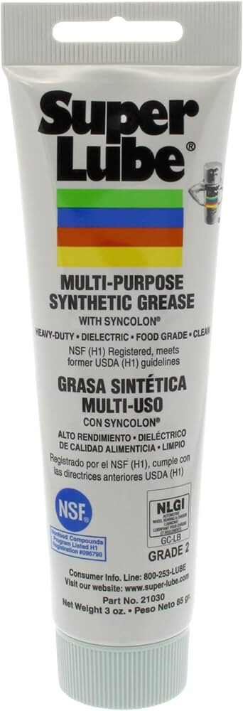

I use Super Lube 21030 (also use on my 3D printer screws). I buy at my local Ace.
Super Lube Grease is a patented synthetic NLGI grade 2 heavy-duty, multipurpose lubricant with Syncolon (PTFE). Synthetic base fluids and the addition of Syncolon (PTFE) micro powders combine to form a premium lubricant that provides longer life protection against friction, wear, rust and corrosion. Machinery lasts longer, downtime is reduced and productivity is increased. Super Lube is compatible with most other lubricants and will not run, drip, evaporate or form gummy deposits and will not melt or separate.
Super Lube is what i use as well. I get off amazon for cheap. Use on all my 3d printers, good stuff.
