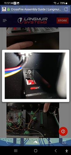

Langmuir Xr y axis motors not traveling the same distance
If it does, move to the other side. The dip switches on the drivers may be incorrect on one. Have you checked the coupler for slippage? Mark them with a sharpie and see if it is moving on the lead screw.
