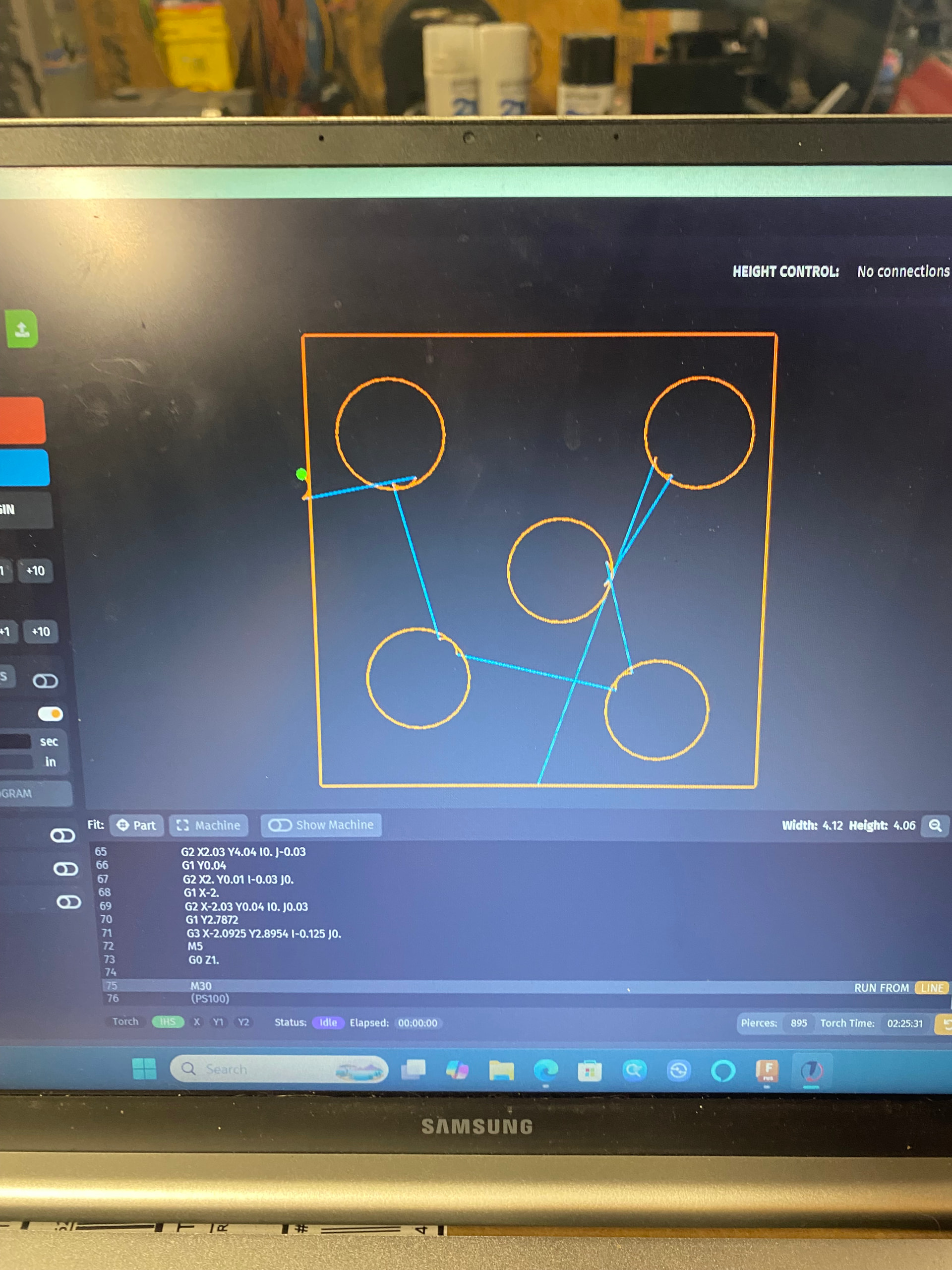

If I post the cut file can you see the g-code that way? No I don’t have THC . That’s what I was wondering if they would help with this not necessarily fix it but would it cause a pause when the torch goes up after the cut . But was also wondering if it would just cause another problem like when it goes up would it keep cutting material.
Still learning how to post that stuff on here.
bris volleyball.nc (50.2 KB)
This is the cut file. What else would you guys need?

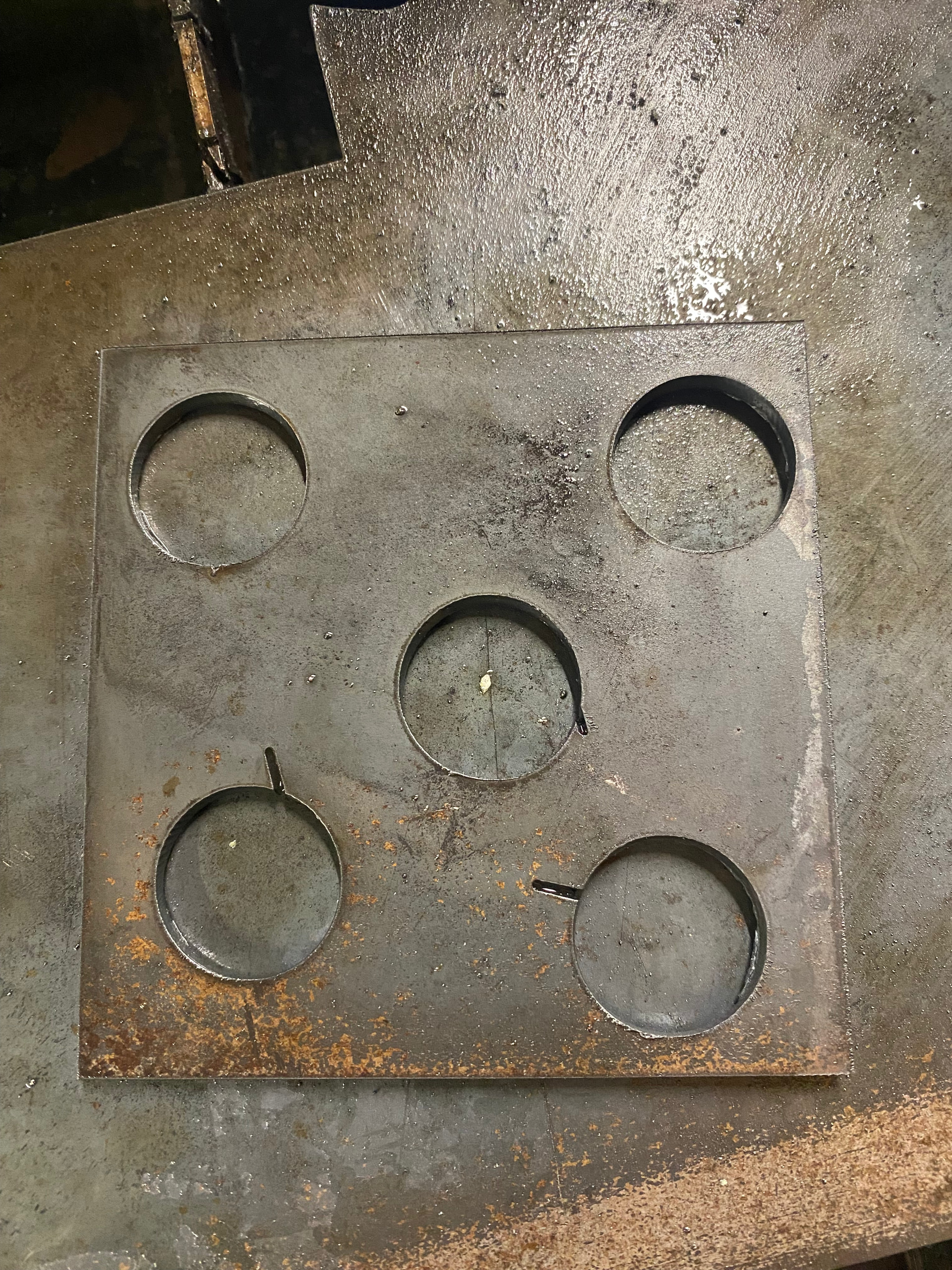

made a plate with some holes in it. Took pic of the post process. Going to go out and cut it. And ill video it.
test plate.nc (1.3 KB)
I don’t see any issues with the file. Either the torch relay is being lazy and not shutting off or your plasma is doing it ..
The control box has a new board and relay for the on and off .
I am starting to think it’s the plasma cutter doing it.
New parts malfunction all the time. Can you listen for the relay to see how fast it snaps out ….. with your old plasma not doing it I would lean towards the plasma as well…..

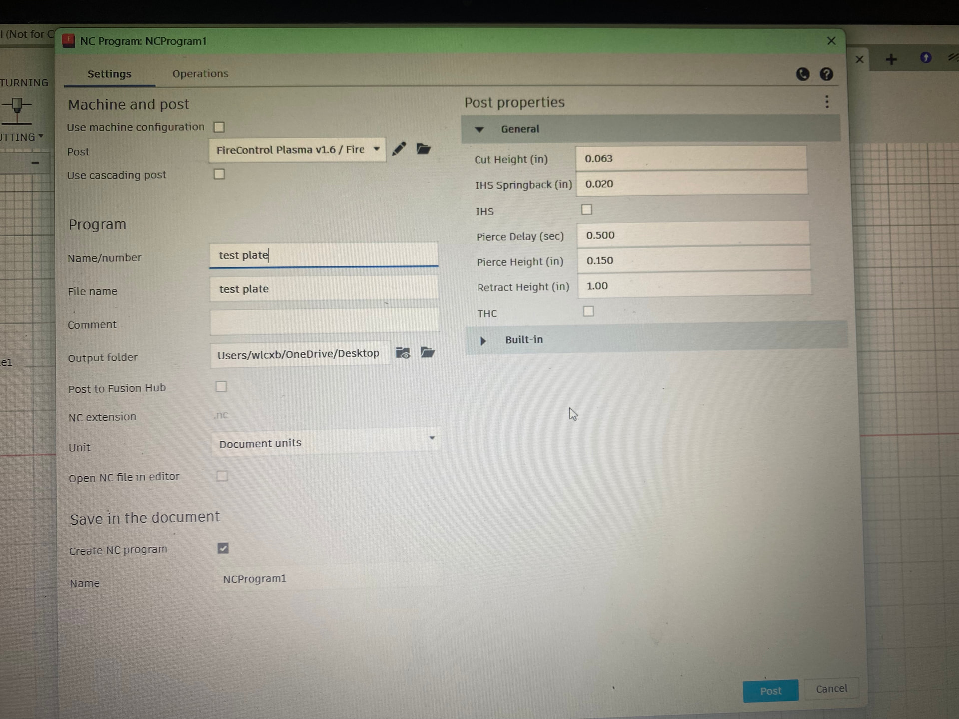

Question for others does fusion have a setting that could delay the torch off?

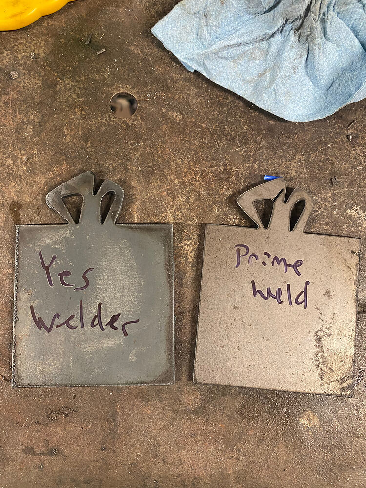

It is the plasma cutter. The Yes welder works. So that eliminates the Langmuir controller. Get in touch with Gene at Primeweld and have him send you a new one. I’ve been busy today, so I have not followed this thread. You switched to the old, yes, welder plasma, and it cuts correctly? At least it does in your picture. I have a hard time thinking it’s the torch. Primeweld will help you, I would think. You shouldn’t have to replace every board in the thing.
That pic is what I send them before I sent it back to them. About 3 weeks ago. They put a new cnc board in it. And they said it ran flawless on there table over a hour. The only thing I think of is that there table had THC which gave it time to when it goes up for it to shut off. I don’t have THC on mine. But I am going to call him tomorrow.
