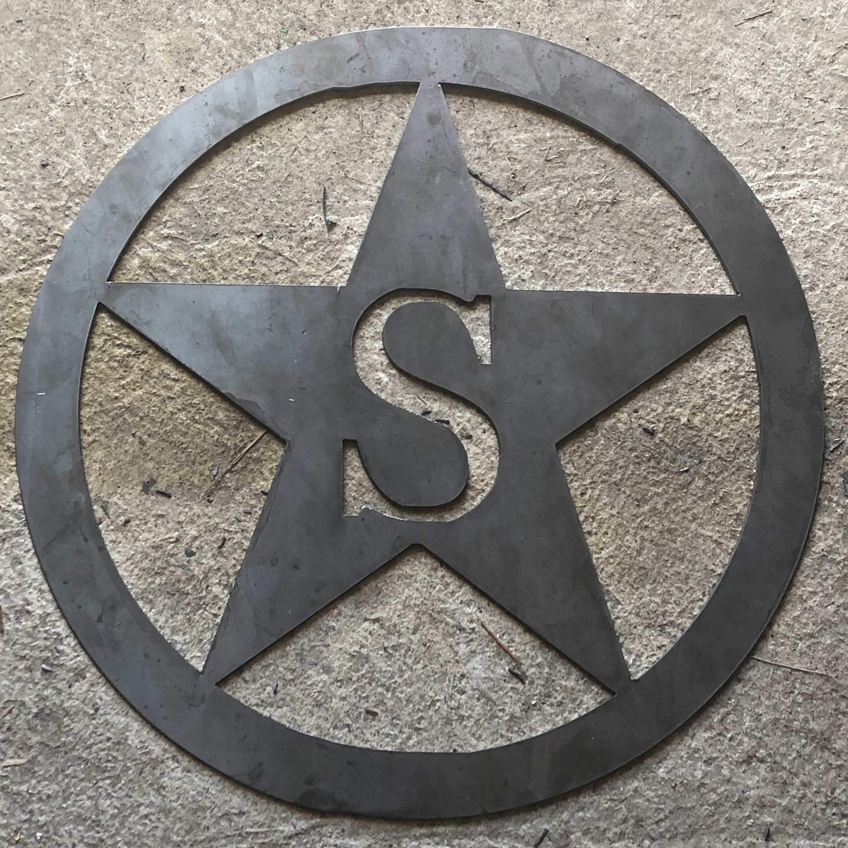

Just a Reminder to Always keep a Eye on your lead screw set screws. If your circles are having flat spots or offset check them.
Great post! And a great reminder. Typically the set screws will come loose when they are not tightened securely enough intitially.
Yea i cut a 23” circle out of 1/8th and noticed the border out of round but it’s definitely tight now and ill always be thinking about it in the future.
