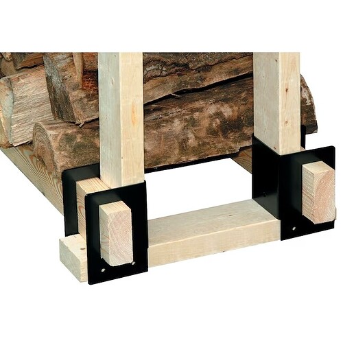

Here are a few examples of the yard structures I was thinking of.
Yes…very familiar with it! NOT! :rofl:

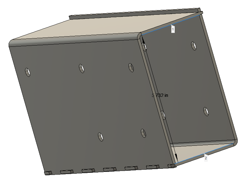

Swing Sets: Who doesn’t need one but hates the hassle of assembly and moving them. This little bracket requires some welding and you might close in the space that surrounds the leg but basically this is just 3 flat panels made out of 12 gauge steel. I have put nominal amount of bend relief that can be welded up once bent.
The original design calls for a 4x6 going thru the top. Well, I changed that to doubled up 2x6’s. It might not look as nice but I was going for economy and the (2) 2x6 will have similar strength once bolted together. You could use this support for a swinging tire, hammock or pot over the wood stove. Maybe even a swinging target for football or soccer drills.
Hardware needed:
Each bracket will need eleven (5) 3/8 x 4 inch bolts and (6) 3/8 x 4-1/2 inch bolts Use loctite on the bolts and you won’t need to worry about the lock nuts.
The support will be adequate for two swings mounted on 2 - 2x6 beams and 4 - 4x4x8 feet posts.
SwingSetBracket v6.f3d (1.4 MB)
SwingSetFlatPanels v3.f3z (2.0 MB)
Directions:
  1. The primary housing bracket is meant to engage each other and the teeth lock into the counterpart. I specifically gave extra room top to bottom to accommodate variations in lumber but this might be a bit generous. Be prepared to put a shim of metal in between the wood and the bracket if it is too loose.
    (Note: I had thought of making the slots for the tabs deeper in the metal to allow for adjustment for variations in wood dimensions but this would alter the holes that are suppose to line up with the ‘thru’ bolts. Note also that most of the brackets for sale only rely on screws to hold the bracket. These bolts will have much more strength.)
  2. Once it is sized properly, spot weld as you see fit.
  3. I am anticipating that the width of two 2x6’s will fit tight.
  4. The leg support bracket will require more delicate bending. I would suggest bending the outside of the bracket first. Hopefully you have some type of brake to do this. There are relief cuts in the flat panels that will assist.
  5. The inside bend will be more difficult. Just get the bend started and then clamp a 2x4 to hold the metal and continue the bend of the metal. If you can get this second bend to 45 degrees, you can then put a C-clamp over the metal and cinch down until you have a reasonable completion of this second 90 degree bend.
  6. The leg gusset assembly is meant to sit on the primary housing bracket at a 10 degree angle. Here is where some spot welding inside the housing would be advisable. And some welding outside of the bracket once you are satisfied with the positioning.
  7. Drilling ‘thru’ holes. The trick to that is to drill just past halfway from each side as perpendicular as you can. Eventually the drill bit will find the other hole and will follow the path of least resistance.
  8. Remember to shim the primary housing bracket before drilling holes.
  9. Install the horizontal 2x4 or 2x6 supports on the legs.
  10. Install the swings. Since you are using two 2x6’s for the beam, I would advise bolts sandwiching the 2x6’s together near where you drill holes for the brackets for the actual swing. There are various brackets and bolts available online for this purpose.

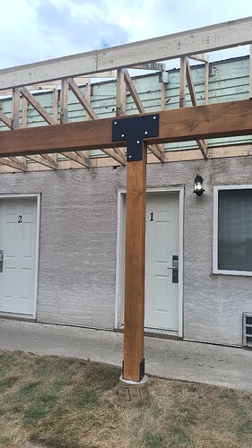

I happen to have a order come in for some post and beam brackets that need to be done for the beginning of next week.

Here are the files true 6x6 inches post and beam brackets
IMG_20240617_153732
IMG_20240617_153736
IMG_20240617_153734
These brackets are done and off to the customer. I believe they’re being installed tomorrow. It’s for 6x6 posts and 6x10 beams. I’ll take some pictures once it’s all installed.
I was using the hypertherm PowerMax 85 with 65 amps shielded consumables. I used the cut chart parameters it ended up being a little drossy but very Square edges and good hole profiles. The cup brush immediately knocked it off.
were those to deep to bend? so you welded them?
I just did a bunch of similar stuff for a pergola in Florida last summer.
My welds did not look as pretty
sob
was that sheet already rusty? or did rust after you cut it?
Yes we did a 90° Bend on one side and a weld on flange the other.
That rust is mainly from grinding dust when it’s racked, you could wipe it off with a towel if you scrubbed hard.
My welds also do not look that good but my business partner does a nice job of it.

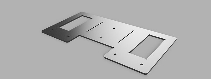

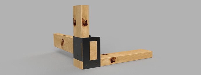

I going to do a walkthrough video today of constructing a 2x4 corner bracket like this.
It will be straight forward .
We will use the sheet metal tools of Fusion .

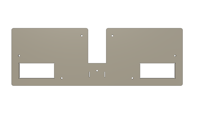

The goal is to recreate this product and create a cuttable file for FIRESHARE
I’ll start in half an hour 7am pst
2x4 Corner Bracket Forum Example v17.f3d (611.3 KB)
2x4 corner bracket example forum .dxf (5.7 KB)

Perhaps those notches helped for positioning the metal plate in their press for forming the bends?
It is always helpful when I see you encounter a problem and then work thru it. That helps me learn almost more than if everything goes without a hitch. Thank you as always for this time you give.
Hope your back feels better soon. It is probably one of the 7-10 day recovery things.
good eyes , probably exactly what they are for .
Cleaned up this F3D some more.
Use the parameters to change the lumber size
and use the Sheet Metal rules to change the thickness
Here are few examples , all are 1/8 1/8" metal thickness
Standard 2X4 (1 1/2" X 3 1/2")
2X4 CORNER BRACKET FLAT.dxf (6.1 KB)
Standard 4X2 (3 1/2" X 1 1/2")
4X2 CORNER BRACKET FLAT.dxf (6.0 KB)
2x2 (1 1/2 x 1 1/2) I may try this in aluminum
2X2 CORNER BRACKET FLAT.dxf (5.9 KB)
4 X 4 (3 1/2" x 3 1/2")
4X4 CORNER BRACKET FLAT.dxf (6.1 KB)
I may make a version of the fusion F3D where all 3 pieces of lumber can also be different sizes
