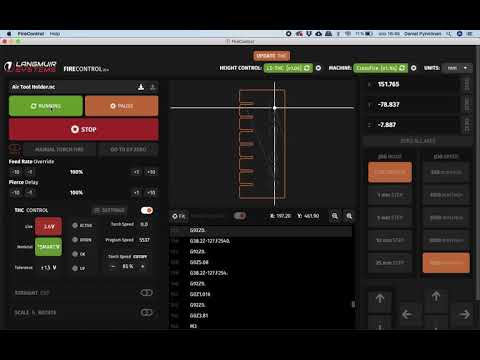

Still might have an issue with THC and possibly the X-axis. This was cut prior to point 3 was corrected so might in part explain the offness of the cut. However, it doesn’t explain why the torch was plunged into the material.
Recorded the screen of the cut so would love to har your comments as to what THC is up to around the 50 sec mark.
I noticed you are on a very old version of THC, update to 1.09! There were many bugs in earlier versions of the firmware.
Thanks Daniel, will do as soon as I get hold of a PC. There’s no way to update with a Mac right?
can you post
.tap?
What I see as weird is drawing looks good, parts looks good and then it looks like it rescaled itself to try to finish part?
Even if plate moved the X distance should of been the same, also plate doesnt look skewd?

program looks fine for the outside cut, I would check the setscrews on motor couplings they may be slipping, that would account for the short line
also make sure you have slack in torch cable
Let us know
Thanks! I’ll give this a shot tonight

Updated the firmware and tightened the motor coupling setscrews which took care of my problems.
