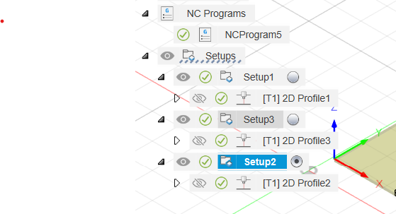

you can also do multiple setups in fushion 360 then combine the setups into one nc program
that way you can tune each setup lead in angle cut speed for each setup so you can get every thing to cut.
