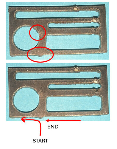

I’m trying to figure out what is causing this issue. Any ideas? This is 16ga hot rolled steel. I’ve tried adjusting all of the settings.
Could it be Torch Height Control? I use smart voltage, but I see that I should only use Smart Voltage for 14ga and larger. I turned off THC and it seemed to fix the above issue. Does that even make sense? But I need THC for cutting larger 16ga cuts. What do I set my voltage to if I can’t use Smart Voltage?

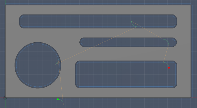

I’d venture to ask that you post a screenshot of your CAM so we can see those lead ins/outs. They don’t look the cleanest, and also having a Z-axis assembly with some play can do funny things to it on touch off/pierce.
Here is the cam. BTW, this is just a design I’m using for testing and troubleshooting.

The one slot you have has the lead in touching the other side of the slot, So you need to shorten that one or change the angle/radius it enters the cut path.

I use smart voltage on everything and it works fine on 16ga material. What I see in those pictures looks like a torch that is moving around on a loose Z axis carriage. Most of the lines on those rectangles are not straight.
I definitely have a loose Z axis. I’ll fix that and see if I get improvements.
The wheels that ride on the rods on the right side are adjustable. Loosen the nut on the back and use the flats on the end of the threads to turn the eccentric mounting bolt.

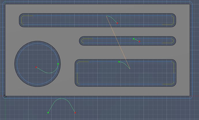

I have tightened up my z axis. I have adjusted my lead-ins / outs. I now a have a clean outside cut.
I’m still trying to fix the divot on my inside cuts.
Thoughts? I see a lot of talk about it on the internet, but I don’t really seem to see any clear solutions.
Might be too long a pierce delay, too steep an angle on the lead in, to much amperage on the plasma cutter, worn cutting tip…
Post your post process screen shot that shows the settings for that, and a screenshot of the cutting details that has the lead in/out, angle…
