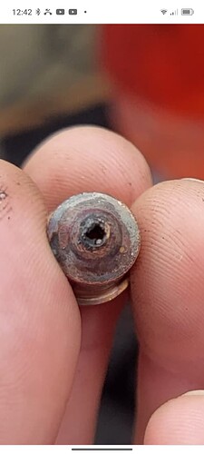

Yes my nozzle is pretty toast, I think. I can’t really say if the electrode is as well. I’m just on the same components that came out of the box with my RW45. I bought a set of tips and electrodes from Amazon yesterday, they should be delivered any time now.
I turned power down to 25A and air to 40PSI and it did clean up some, still not ideal though.
That nozzle is absolutely destroyed.
Replace those bad parts and double check you have all the right consumables for your assembly.

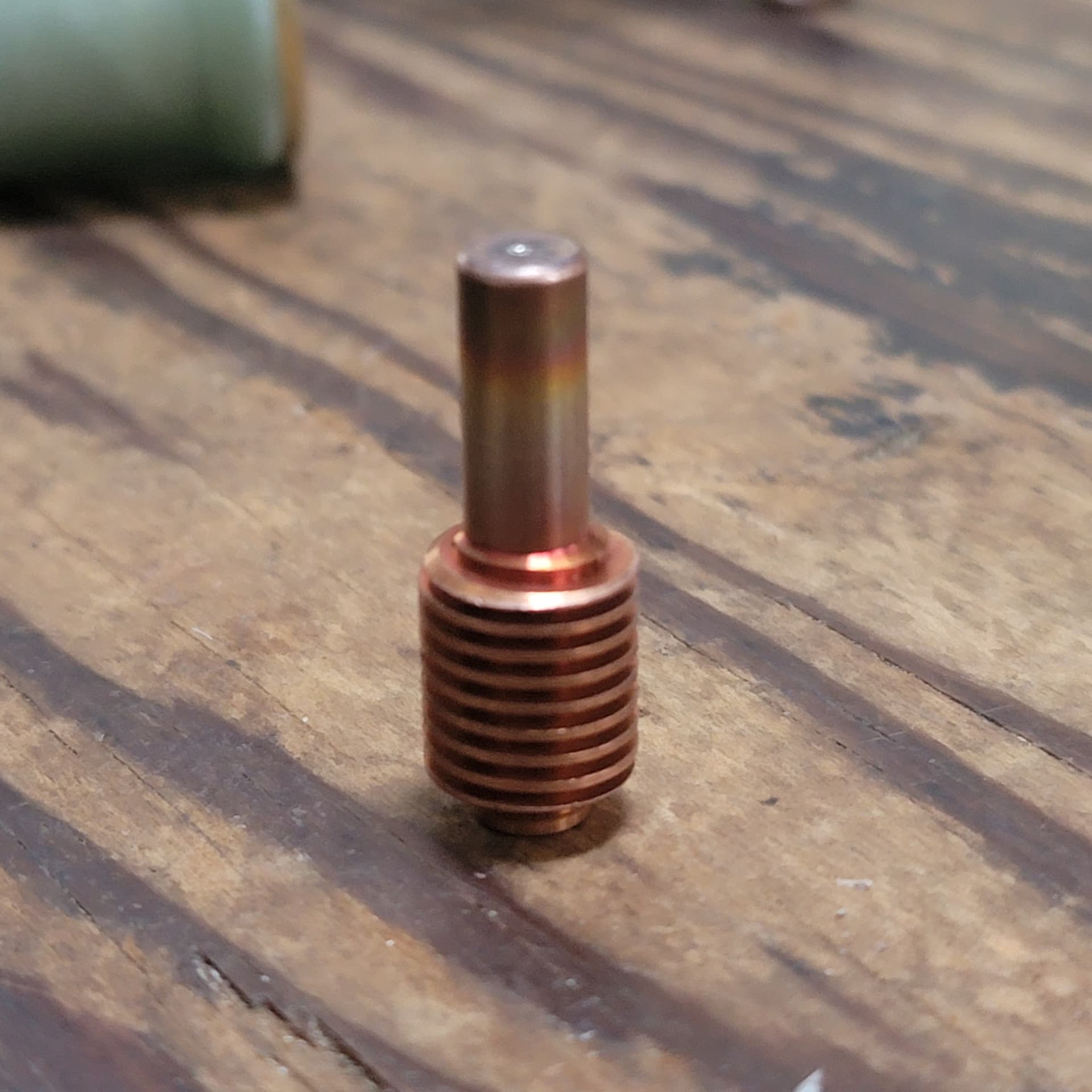

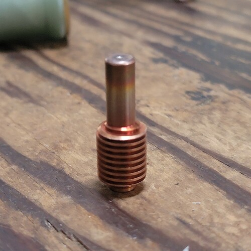

Hopefully they’re here within an hour or two. I’ll absolutely get firing tonight after replacement. The parts I ordered match the part numbers listed in my RW owner’s manual. Quality… Couldn’t say. They are Amazonian!

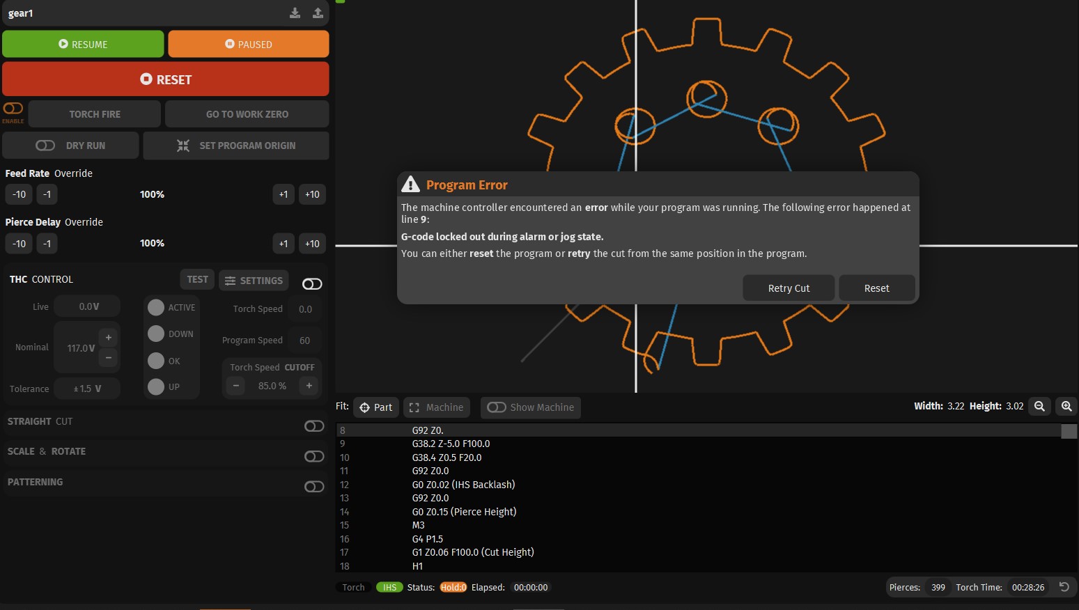

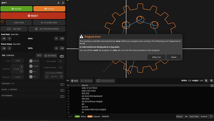

Air does come out of the torch, although it may not, depending on if I’m fiddling with the torch on plug or not. I can hear the relay click (control box cover is still removed). Firecontrol throws the same “torch moving before sensing voltage” error. I did also get this one time earlier:

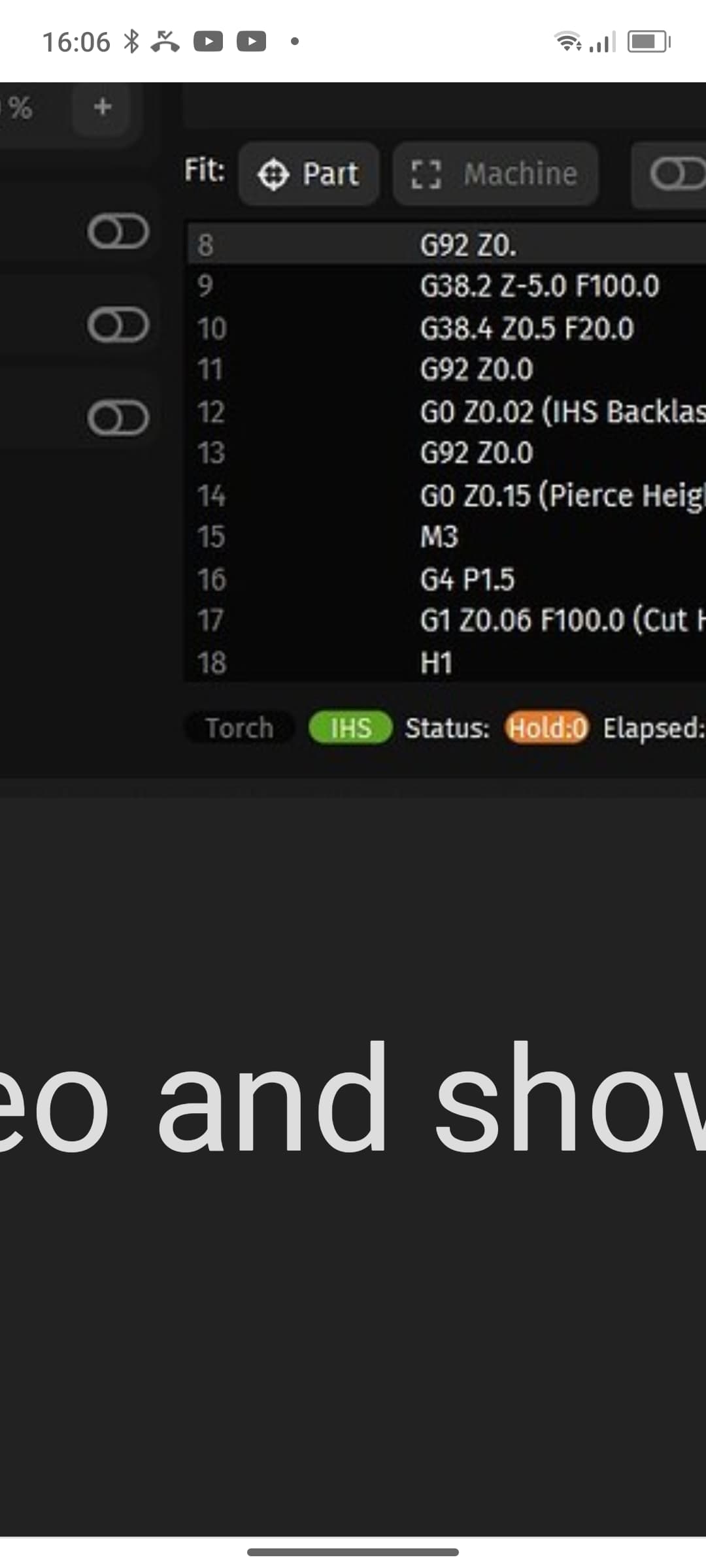

Is the green IHS light always on?

I’m not positive. I’ve only seen that error one time and it may have been due to something I was doing in my troubleshooting.
If the issue was the torch on/off power plug as I believed earlier, then possibly I’ve boogered it. But visually it appears fine, all connections behind the box are secure that I can tell.
I tried to fire with the THC off and voltage in manual mode. No dice here. You’ll probably here the plasma machine popping on and off while it thinks it’s firing, and I suspect that sound is coming from me fooling with the torch on/off plug while the program is running. Also, the air doesn’t necessarily come out of the torch until I fiddle with the torch on/off plug.

The pierce delay in the screenshot is 1.5 seconds.
As noted, that IHS light should only be green when the torch is in contact with the metal.
40 psi may not be enough pressure to blow back the electrode to fire the torch. Razorweld machines seem to work best at 70 psi.
So, this is interesting.
I can confirm the 1.5sec pierce delay was just for testing. The programs that ran successfully were on a .5 or 1 second. Additionally, i can confirm thee green IHS light is only on for a split second when the torch touches material.
But i did bump air pressure to 60psi. It had been running great at 50psi, but upped to 60 from 40 this morning. Wouldn’t you know it, she fired on both the old and new consumables!
