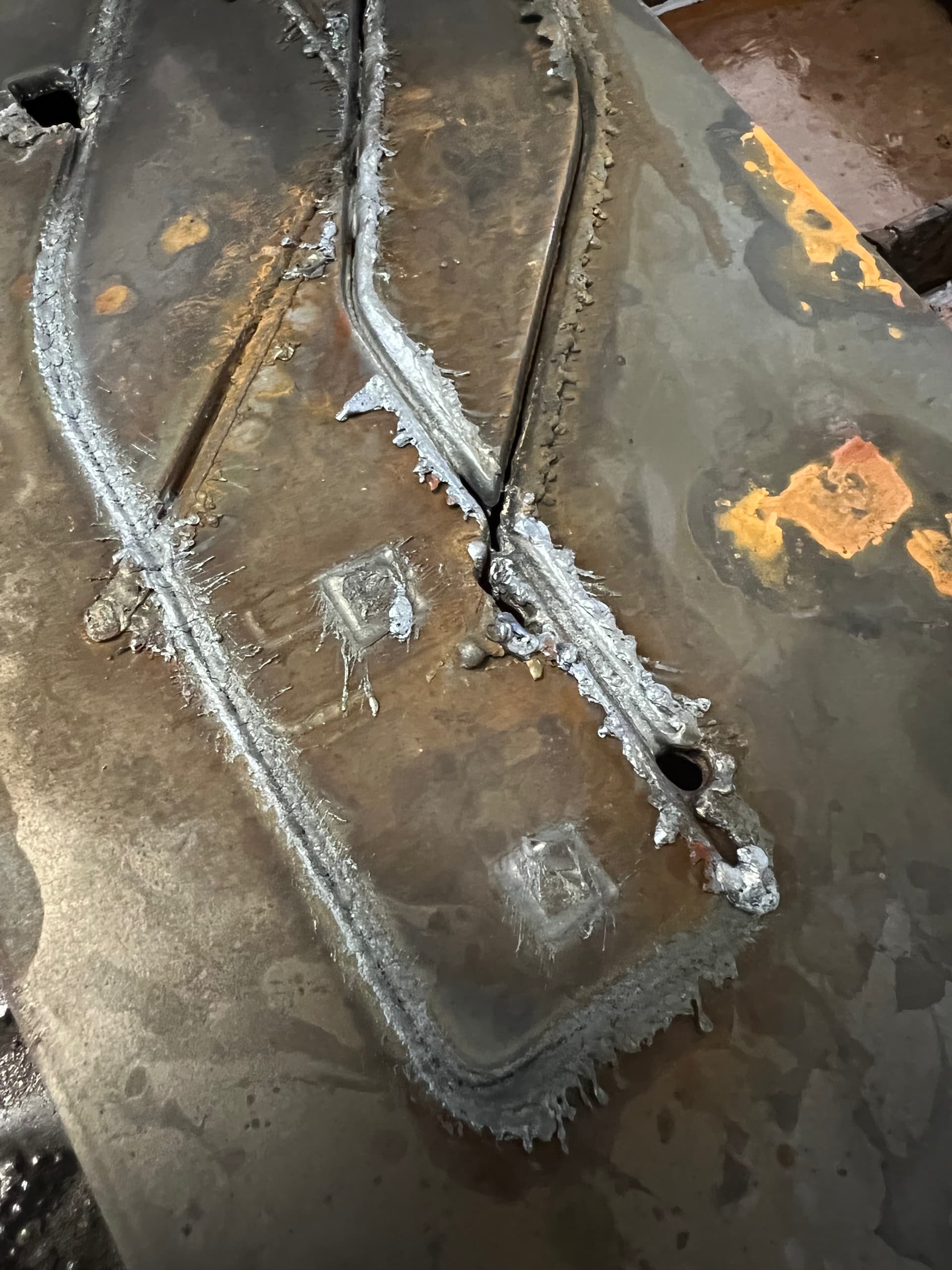

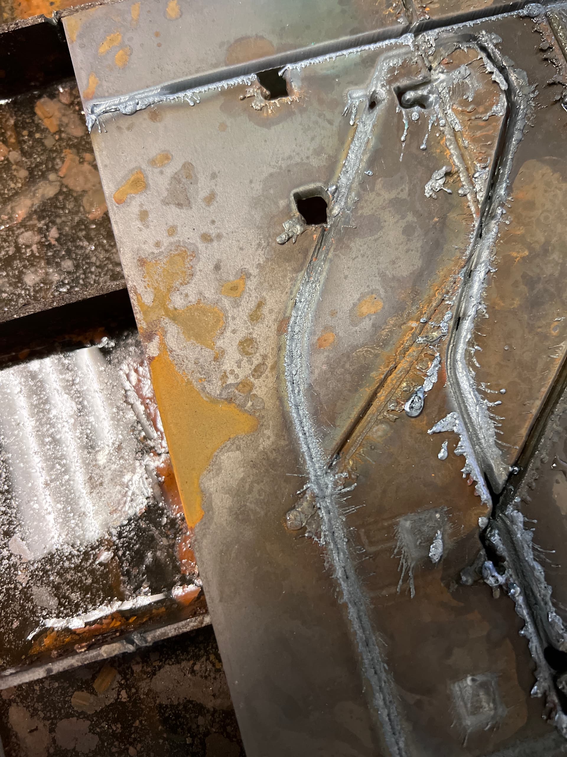

Do you have Pictures of attempted cut?

There is something wrong with your torch, if it won’t cut through. Those pictures on your other post look like what happens when you try to cut with an electrode that has burned away all of its Hafnium core. If the arc looks green, the electrode is past its useful life and you may be causing damage to the torch by continuing to use it.

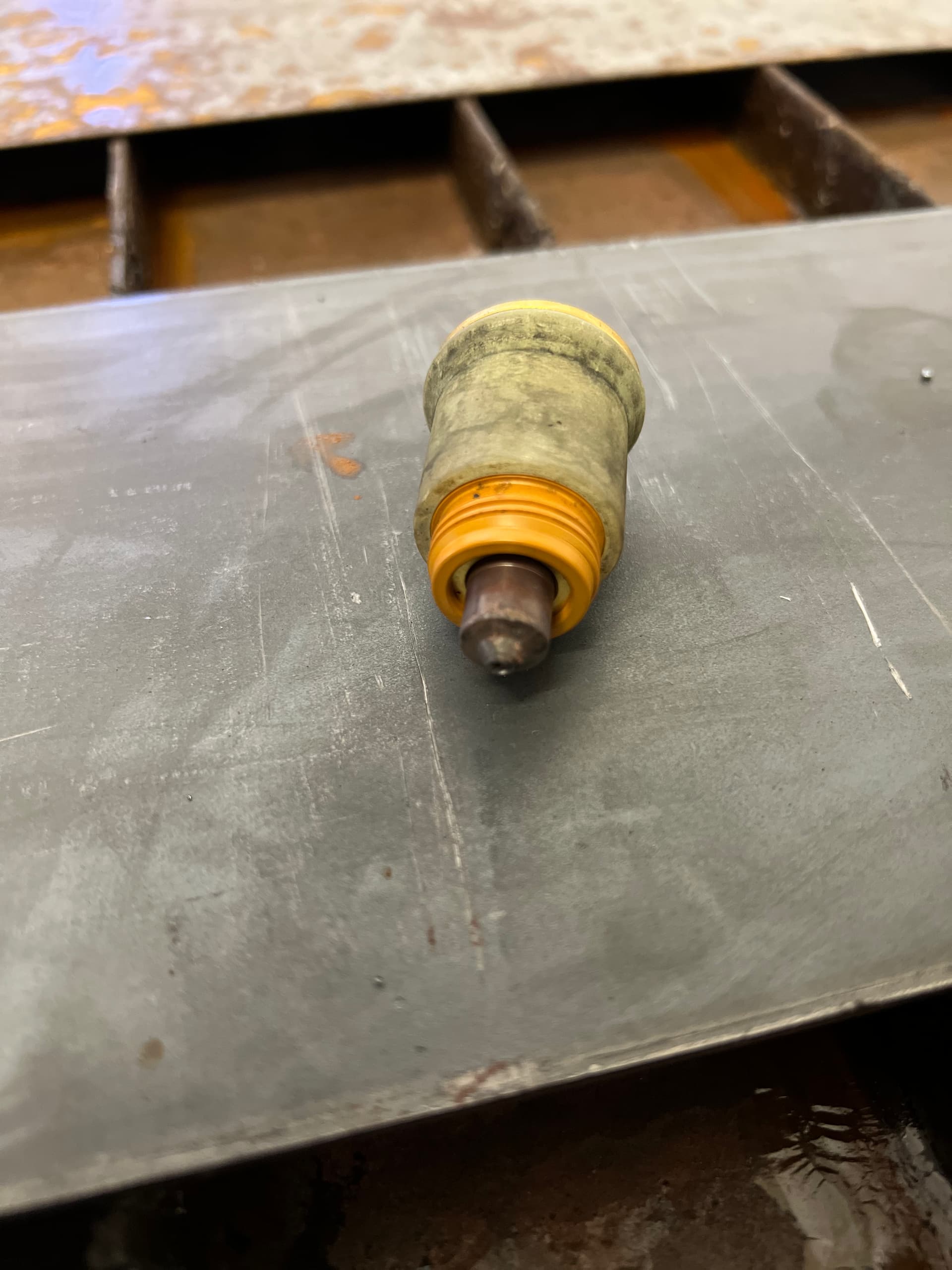

Take out the consumables and take pictures of what you have.
Here are the pics from his other thread about his problem
I would say shot consumables. Wouldn’t you? If work clamp was issue I don’t think it would try that hard.
I agree. If it was the work clamp it would barely be etching the material… In these pics it looks like it is getting about half way through. I think @ds960 is right its an electrode.

Maybe the op can post some close up pictures of the consumables?

We need to see the electrode that is inside of that.

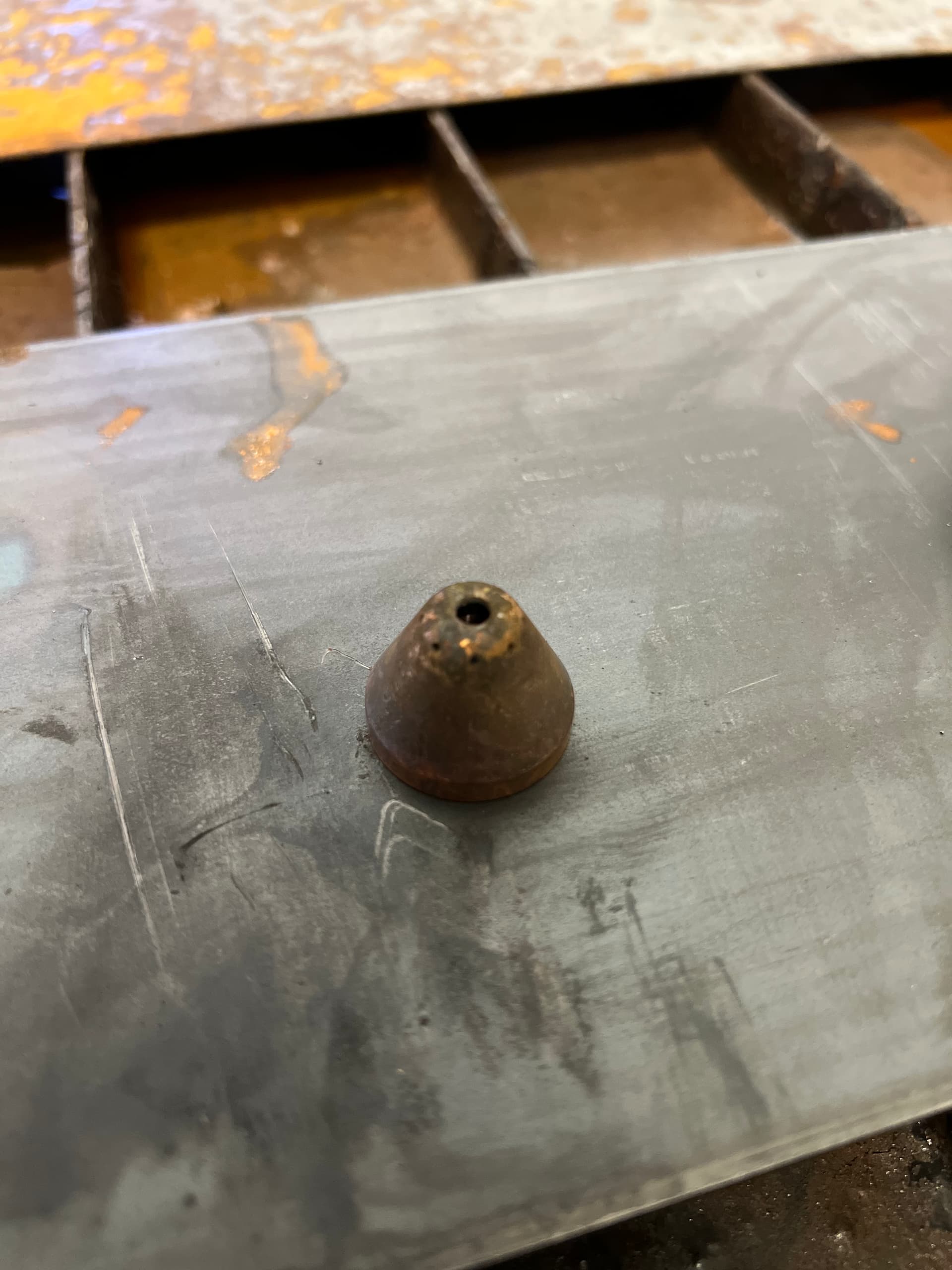

And take a good clean picture of the tip of the electrode and the hole of the nozzle.
from the last picture that nozzle look suspect but a better picture will help.
That’s what it was thank you so much
