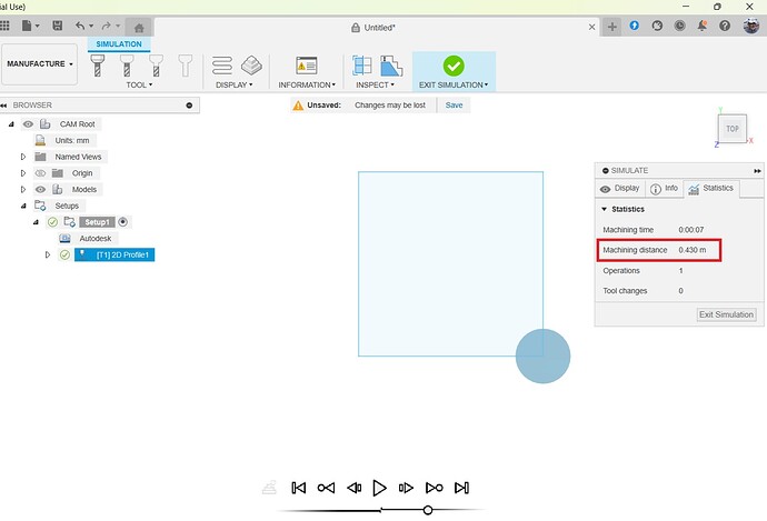

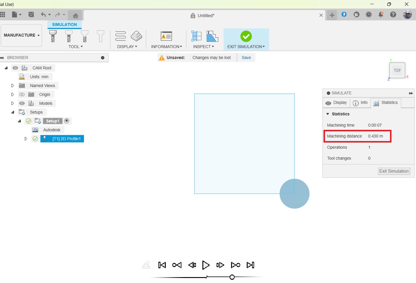

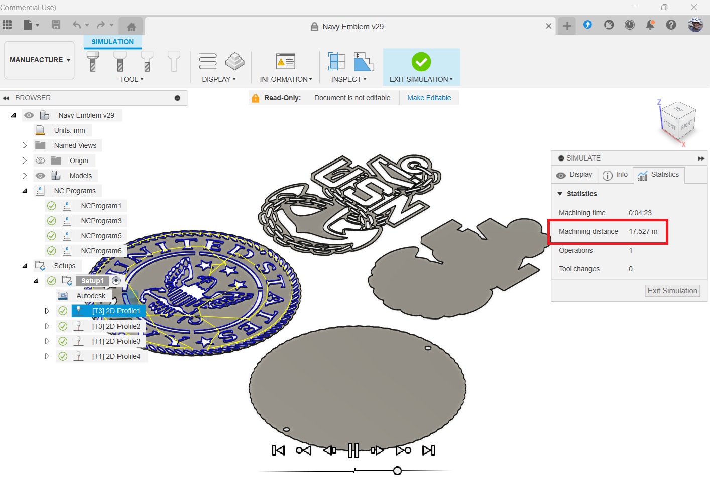

Fusion 360 in the Simulate function after creating Toolpath is what I assume to be the cut length although I have never verified it:
Couldn’t resist. Went back and made a 400mm square and ran Simulate. Measure says 0.430 meters. Not sure where the extra 0.030 meters came from. When I set it to Center Compensation on the second toolpath it reduced it a fraction, so it is actually taking that into account. Was also set for zero Finishing Overlap and no Lead-in/out.
It likely calculated in the tool moving from the stock box point location to the first cut.

I am thinking it is probably accounting for Kerf width as well as lead in and out.
