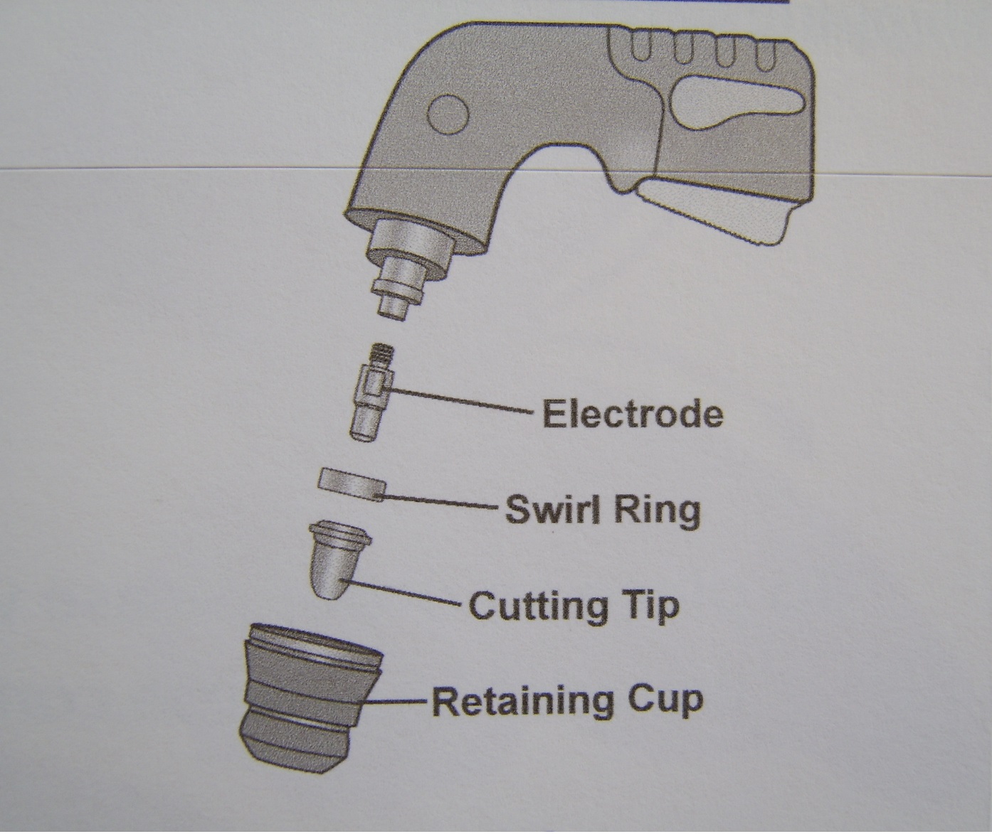

Random question. Should the tip on the machine torch move in and out (spring loaded) the same as it does on the manual torch? My gut says yes, my PTM60 Torch from @mechanic416 says no.
The electrode moves. The tip does not.
Basic torch set up for the S45 and IPT torch
Gotcha. For some reason I was thinking it was the opposite.
