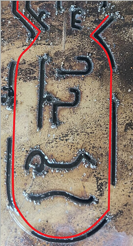

I have never cut out the F-bomb but I suppose If you look at this one contour, this is meant to be cut as one continuous line. It breaks almost in a rhythm of on-off-on-off-on. If it was cut height it would extinguish and not come back on. If it was bad consumables, it is doubtful to have this rhythm and EMI would have been much more random and likely stop cutting all together.
This is likely something with the air because neither the torch or FireControl is giving the signal to turn off the torch. Once the air pressure is up to critical threshold, the electrode moves into position to ignite again.

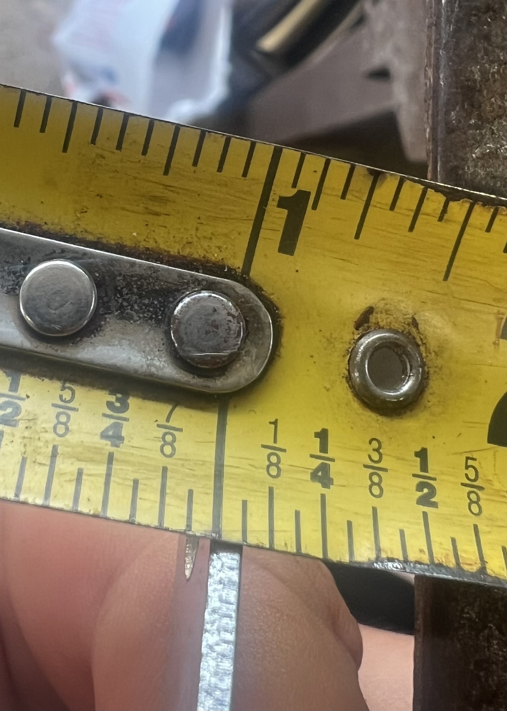

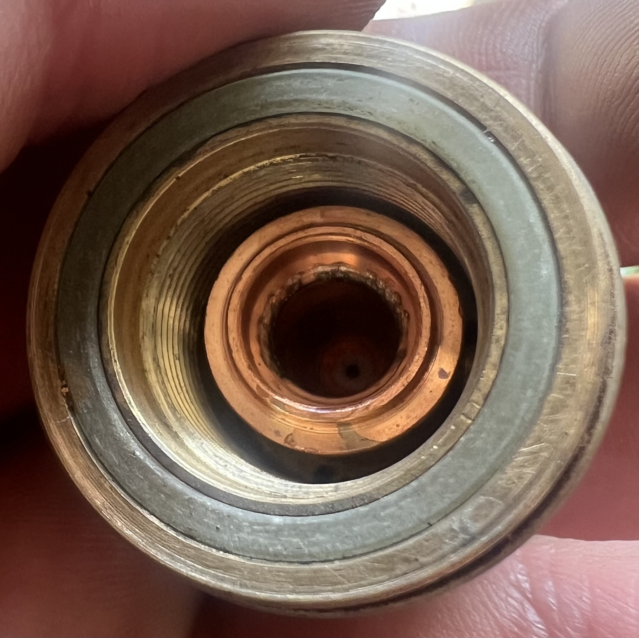

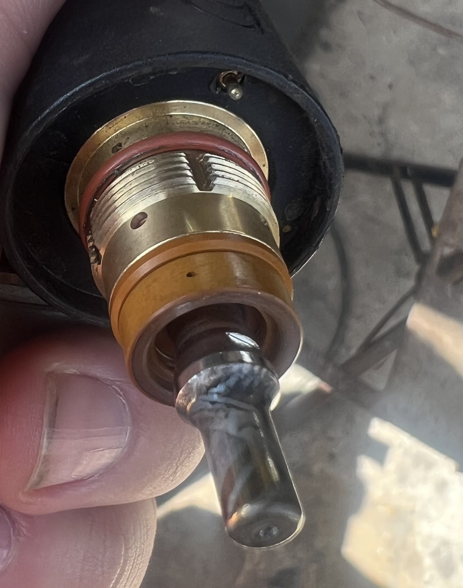

So I ran the THC test and here are the results. Also, these are how my consumables look after trying to troubleshoot that “maybe” it was the file (switched to sheetcam). That wasn’t the issue.
Assuming it’s an air pressure issue which you can see I’m getting moisture on the electrode but also on the tip I’m getting a “arc looking” deal. Any ideas?
For my compressor is a 60gal husky (11.5cfm at 90psi)

But yeah, you can see it yourself that you do indeed have moisture in your air. The swirl marks on your electrode are evidence of that, and it’s pretty bad if that’s a new consumable set.

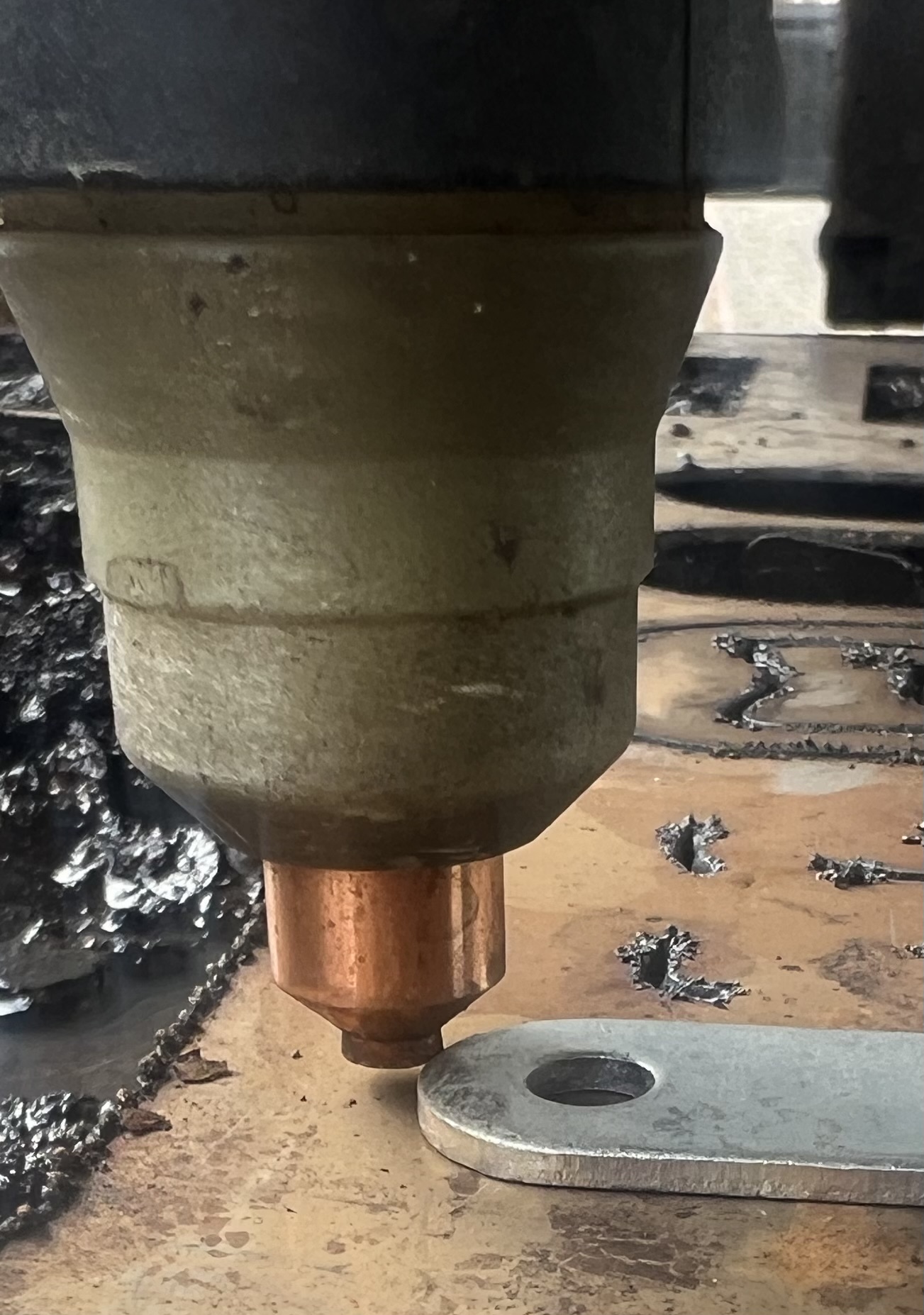

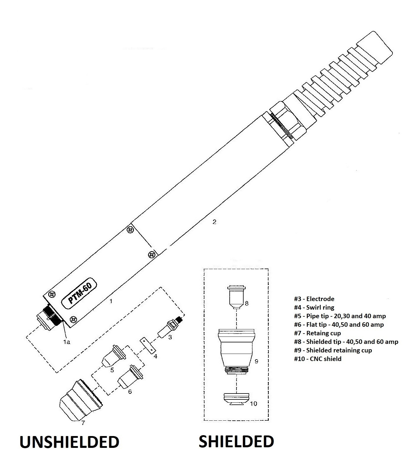

The electrode is toast. The problem that sticks out to me is the tip. It looks like a shielded version of the tip being used without the shielded-style cup, but I could be wrong.
I’d say you’re correct, looks like a shielded tip with that projected end.
edit and to Caz, stick with the shielded tips, but get the shielded cup too (@mechanic416). It WILL help you not chew through expendables as fast. Keeps the gunk and schmoo away mo betta. However, your air system also needs more moisture control.
The arcing on the tip is also from the moisture. Water providing a current path between electrode and tip.
Moisture in the air, Yes. Wrong cutting tip for the application, Yes. Wrong size cutting tip for the plasma setting or burnt out tip, Maybe. Air pressure may be low, Yes. But none of these will cause what is going on.
If it was air pressure dropping out it would not re-fire on its own. This would have to come from a command from the program. The plasma cutter can not re- fire with out something telling it to. Also if you blow up the picture the starts and stops are to clean.

The gaps in the cut appear very uniform and looks like some “tab” setting has been implemented to leave uncut sections.
tab settings? Meaning in the gcode?
In your CAM setup, there is sometimes a setting for leaving tabs(uncut sections) to prevent the part from falling out when it is cut.
If you could post the G code, someone could look at it and see if that is what’s happening.
If you’re using Fusion, post the f3d file and one of the Fusion users can look at it.
Edit: I haven’t been following this whole thread and I see you posted the code earlier. That doesn’t look like it has any tabs in it.
