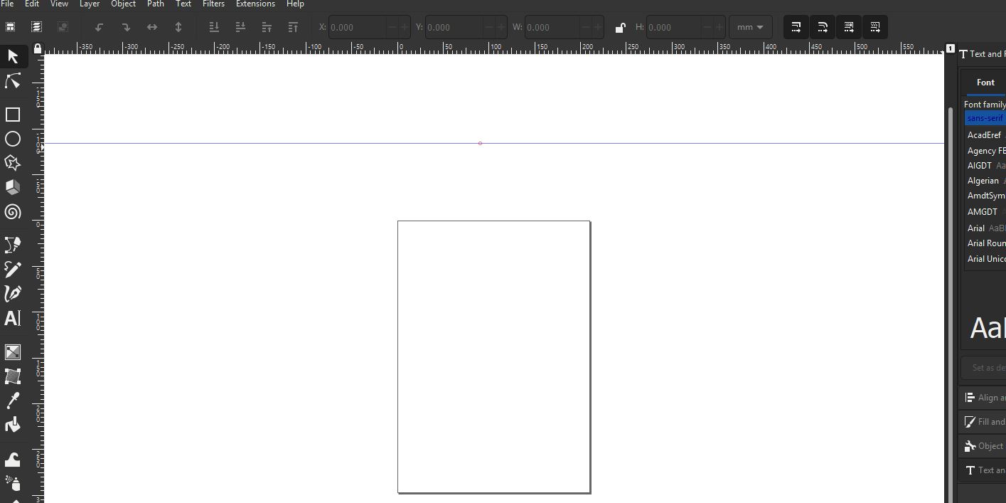

here is a question about something that happens and I get pisse doff…
working away…you are holding the Crtl key…and you press your mouse and hold the mouse wheel…the the whole screen rotates…how can you reset it?
in design mode normal

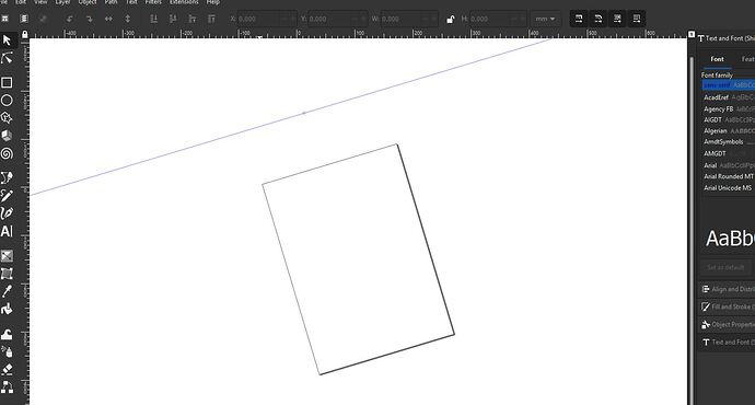

now after the Ctrl and mouse wheel tilt…
Is it Rotation you are looking for?
R: x.xx down in the right corner or Ctrl+Shift+Scroll
well…look at that…I never saw that…
Thank you for pointing that out…I appreciate it…
There is also View->Canvas Orientation->Reset Rotation
No hotkey that I know of. Of all the new feechurs in Inkscape 1.0 this one gets the most complaints.
