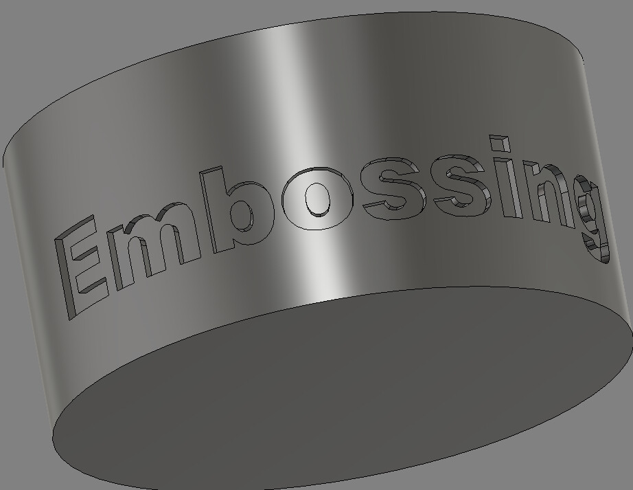

I probably should not weigh in on this (because I don’t know my way around Inkscape)…but could you be asking about something like the emboss command (in Fusion)?
Yes but having uploaded another and got the same, its a problem with images greyscale or photo’s i think. i even think its happened before and i needed an add in. i just cant remember which
