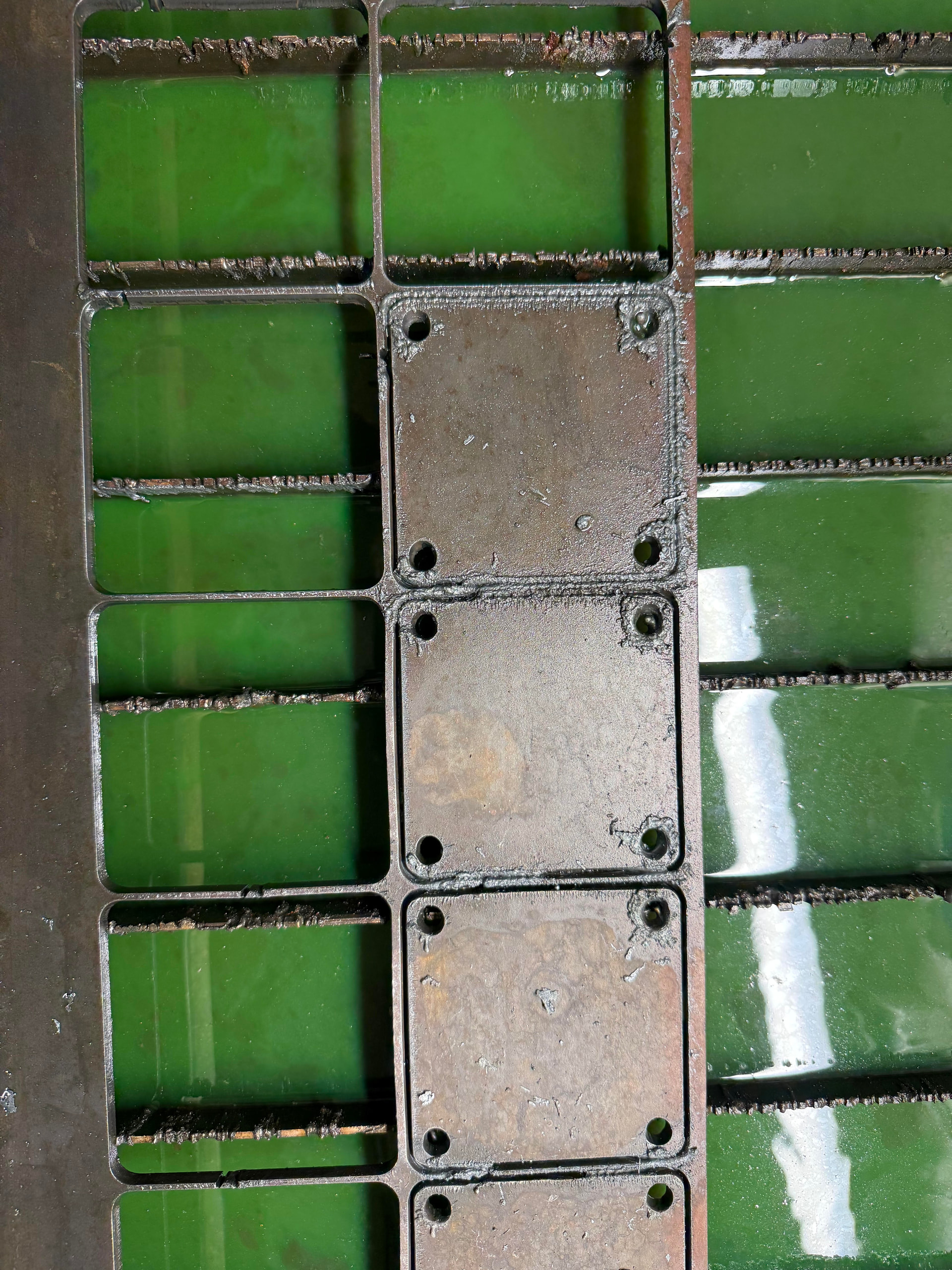

Inconsistant Incomplete Cuts
Our shop has been utilizing the Crossfire Pro with TCH in conjunction with the Hypertherm Powermax 45. Parts in smaller batches (1-4) usually have satisfactory results, but when a larger batch is being cut, the parts tend to be partially cut. The Z axis seems to grow mid-cut, and the cut is characteristic of an ungrounded part. I’ve messed with the limits for z axis and measured the actual Z axis height, and it checks out. What am I missing?

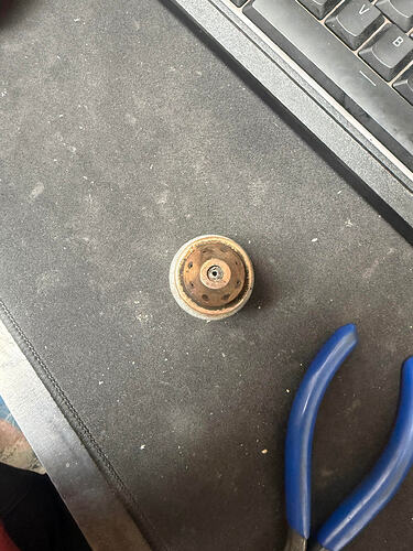

First are you using REAL Hypertherm consumables? The picture shows the CNC shield and cutting tip is bad.
Yes, these are authentic Hypertherm consumables. The mech consumables are a one-piece design. This issue I’m having seems to foul the consumables because of the spatter being produced due to the incomplete cuts. The cut height is increasing on various parts, sometimes up to 1.5”
You said it was a powermax 45 not a xp or sync., this information would have helped. First thing is to clean and lube your Z axes and check your IHS to make sure its working properly. Use anti splatter on the CNC shield part.
That consumable is long done.

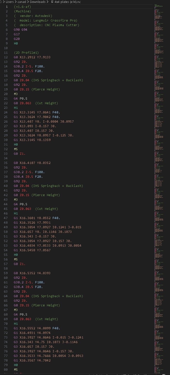

Can you upload a code from one of the larger batches? Do you have separate code for the smaller and larger batches or are you running the small batch code over and over again to make a larger batch?

  • For large batches of parts I have all the parts on one NC File. The file attaches corresponds to the photo of the Miscut.
    4x4 plates (x14).nc (30.6 KB)

in your program you’ve asked the cut height to be .063
and you want it to be 150% of that of that .15
but it’s actually cutting at 200 to 250% of what its programmed to be?
These consumables you’re currently using are already cooked but running a high standoff cutting height will cook consumables fast.
I’ll attach a snippet of the code for everyone else who’s following along.

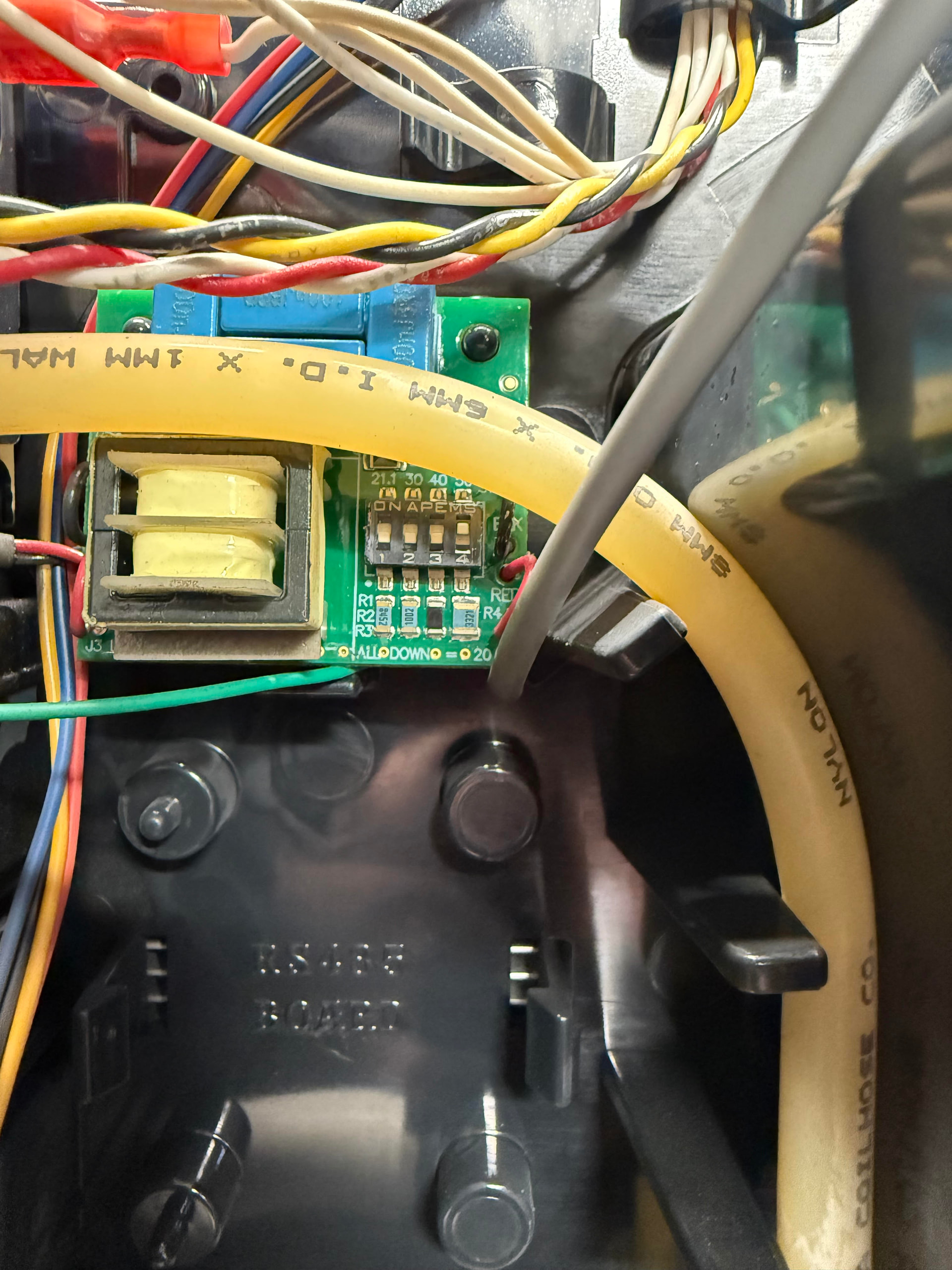

You verified that the CNC circuit board inside the power Max 45 has been dip switched to 50 to 1 voltage dividing if you’re using the divided voltage?

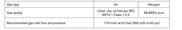

And being that it works on a shorter cut and doesn’t work on a longer cut have you verified that you don’t have too much pressure drop and are starving the machine for air?

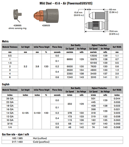

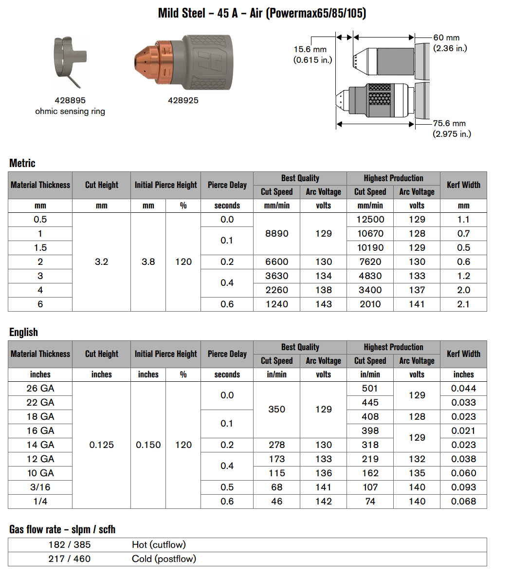

I was referencing the hand-cut consumable chart, and that’s where that .06 came from. I’ve adjusted to the mech cart recommendation of .125” cut height.
The CPC is using a divided-voltage connection, and the switch is in the desired 50:1 position.

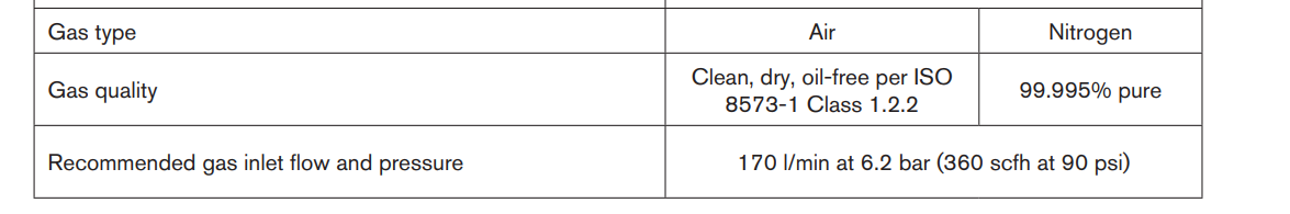

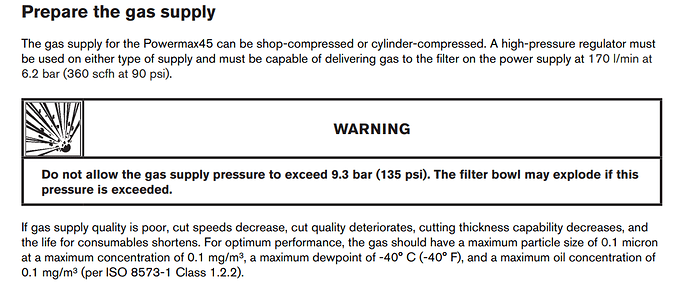

The voltage while cutting a part that doesn’t get affected by the issue is 124-130V. When it gets haywire, the voltage can get as high as 150v. The machine is running on good outlet power: 220v, 60 amp breaker, with 6ga wire. I have plenty of air pressure and have it regulated at 80 PSI at the machine.
I may be wrong here but the 124-130 volt reading is high for 50 to 1. Also up the air to the plasma cutter to 100 to 120 psi.
This is the current orientation of the switches

here’s from the power Max 45 manual
80 is the bare minimum input
here’s a clip from the cutting chart for the adapter guide
https://forum.langmuirsystems.com/uploads/short-url/1L4jCWETE1H7QARrfgyXX1vP8Bb.pdf
I still don’t think those voltage reading are for 50 to 1. They seem more like raw voltage readings.
I’m pretty sure he’s talking about what voltage he’s seeing in fire control.
The plasma torch is putting out 50 to 1 to the vim. The vim is taking that 50 to 1 signal and augmenting it into a 73 to 1 ratio then fire control takes voltage and applies 1 to 73 to it to display it.
He’s probably two to three volts at the plasma cutter. If he were to take a direct measurement there.
