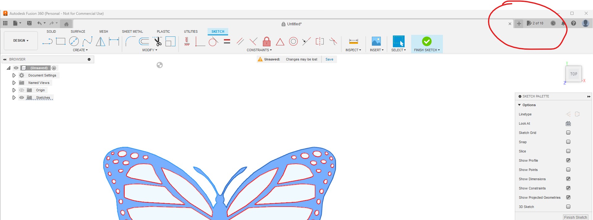

I clicked file, upload and brought it in as one of my 10 saved files. Thank changed it from read only to editable.
I am now getting a banner at the top that says your graphics card may be affecting performance. i’m going to see if i can update the graphics drivers.

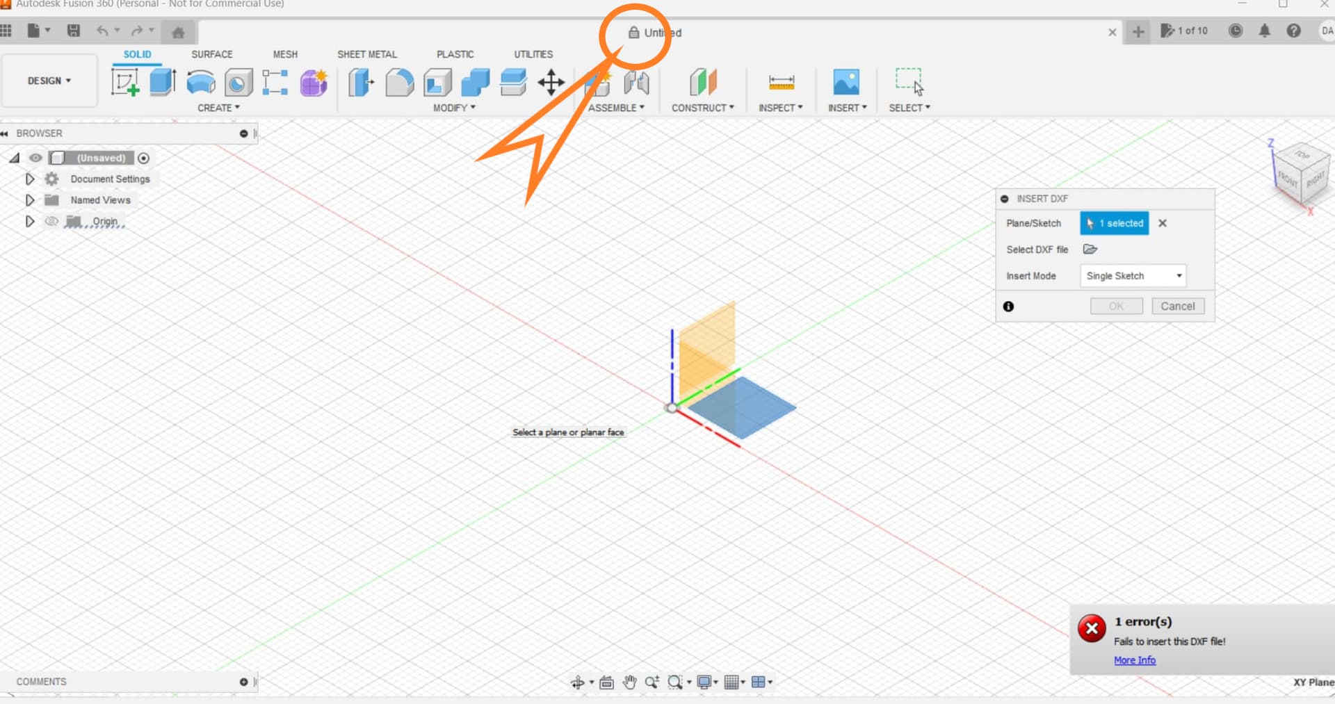

i AM GETTING THE SAME fail message all of a sudden
I’m now getting the same error… never had an issue inserting files before. I even tried previous files I know worked and still got the error. I tried the way danzick did it and it worked, it’s just a pain in the a…
Anyone got a fix?
Been trying for 2 days to get dxf to load into fusion with no luck. I tried the upload option and it is working.
I have had the same thing happen a few times with downloads frm FireShare. The error happens immediately and just flashes the message box so fast there is no time to read it.

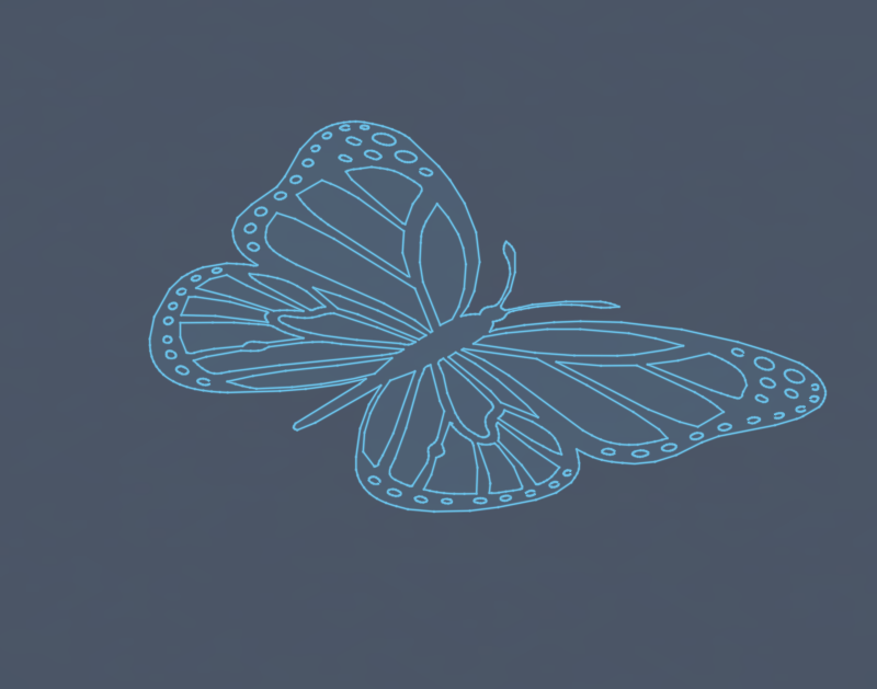

Here is one which fails to open for me. Like I said, about 2 seconds after I select the file, flashes error and fails to open.
butterfly.dxf (211.0 KB)
@Wsidr1 works on my machine

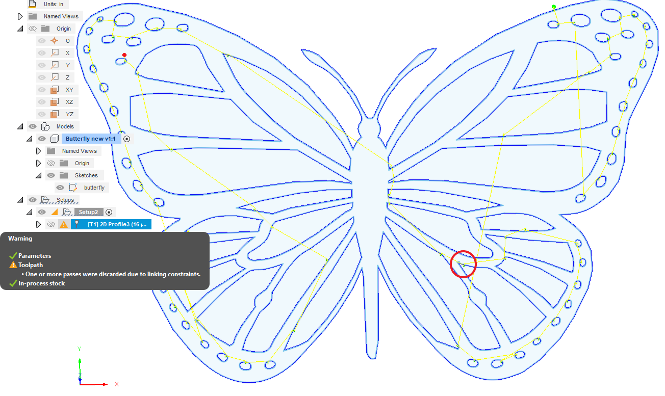

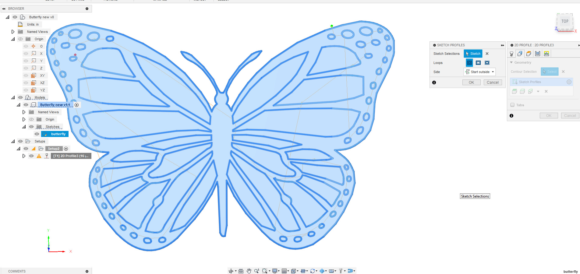

This new selection of ā€œsketchā€ for the contour selections is a game changer. This seems very ā€œSheetCAM esque.ā€ Tin, you were right: Fusion 360 is improving. I imported Bret’s butterfly and made zero changes to it and immediately went to ā€œManufacturing.ā€ I initially had some issues with it trying to cut everything on the outside but somehow made the right correction and this is the results.
Butterfly new v1.f3d (624.9 KB)
The only contour issue, I believe was the red circled area and I was going to correct in ā€œdesignā€ but no need. Fusion made the correct choice:
This is very exciting!!! I guess I will put the $140 back in my pocket that I was thinking of spending on SheetCAM.

@DonP are you currently using all 10 read only file and it shows a padlock on your top tab?
I’m at 2 of 10 active designs currently but it wouldn’t allow them to add more if they had 10.
so i am having the fail to open a DXF as well on my shop computer, my design computer has no issues. i tried all the ways suggested on here and also read through a ton of the autodesk help forum online. man what a pain, anyone have a fix or am i stuck until fusion updates it again?
super annoying to go into the house to do anything with a old file. even old stuff i drew wont open. cant add dxf to my projects or insert it.
As Tin found, AutoDesk is aware of the problem. Those of us that can still do it, don’t know why we can. And those that can’t, have not found a work around.

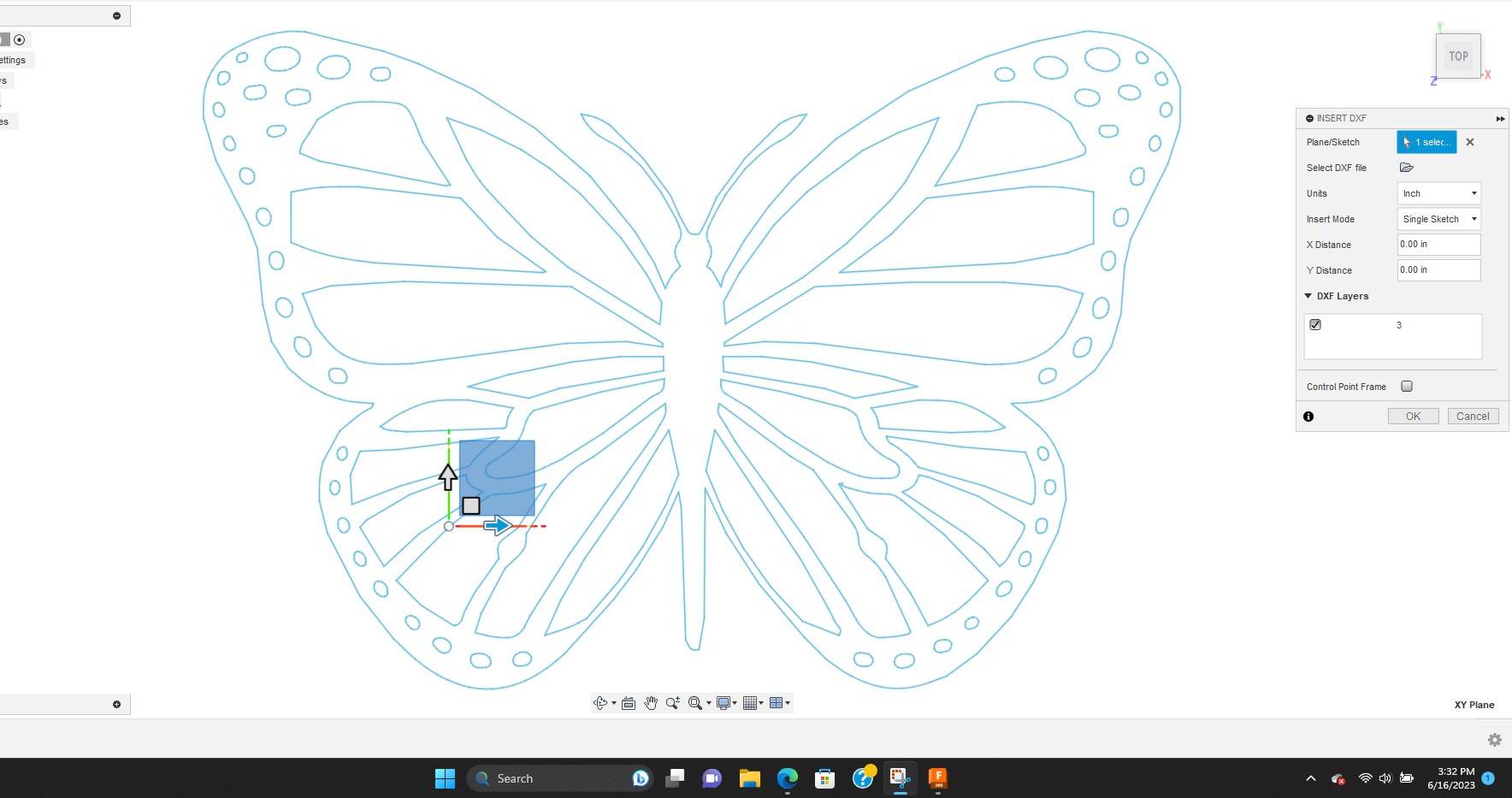

Here is a new post from the autodesk forum I linked above saying they may have solved their issue .
Hello, issue finally resolved!! ok so first make sure you have updated fusion.
Then you need to make sure you have the up to date drivers for your graphics card.
We did this and tried it but it didn’t resolve so we then had to wind down the UAC permissions, don’t forget to put this back up after you have installed the drivers.
When installing your graphics card driver once its downloaded, right click and run as administrator.
This should resolve the issue.
If you’re struggling with this let me know and I will go into greater detail.
The guy at fusion said that there were lots of issues with dxfs and fusion not liking out of date graphics drivers when importing into fusion."
