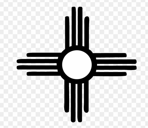

Can Anyone help me out. I have a Mac so sheet cam is not supported on Mac. I’m trying to get this ZIA Sun image made into a G Code file to cut. total sheet needs to be 56 inch high by 35 Ince wide with the image staying 6-8 inches from the edge of the sheet. I have the image if anyone can help ill send it your way. Thank you
Do you have the settings needed for your cutter and the thickness of metal? (cut speed, pierce height, cut height)
What cutter are you using? Have you done test cuts and dialed in these settings?
I would be willing to run your design but not having seen it, I take no responsibility for the contours being dropped due to the lack of space for the torch. And if it is just a really busy, artsy design, Fusion 360 might get hung up.
But I would give it a try. (I don’t know SheetCAM).
If it is something like this, that should be easy:
