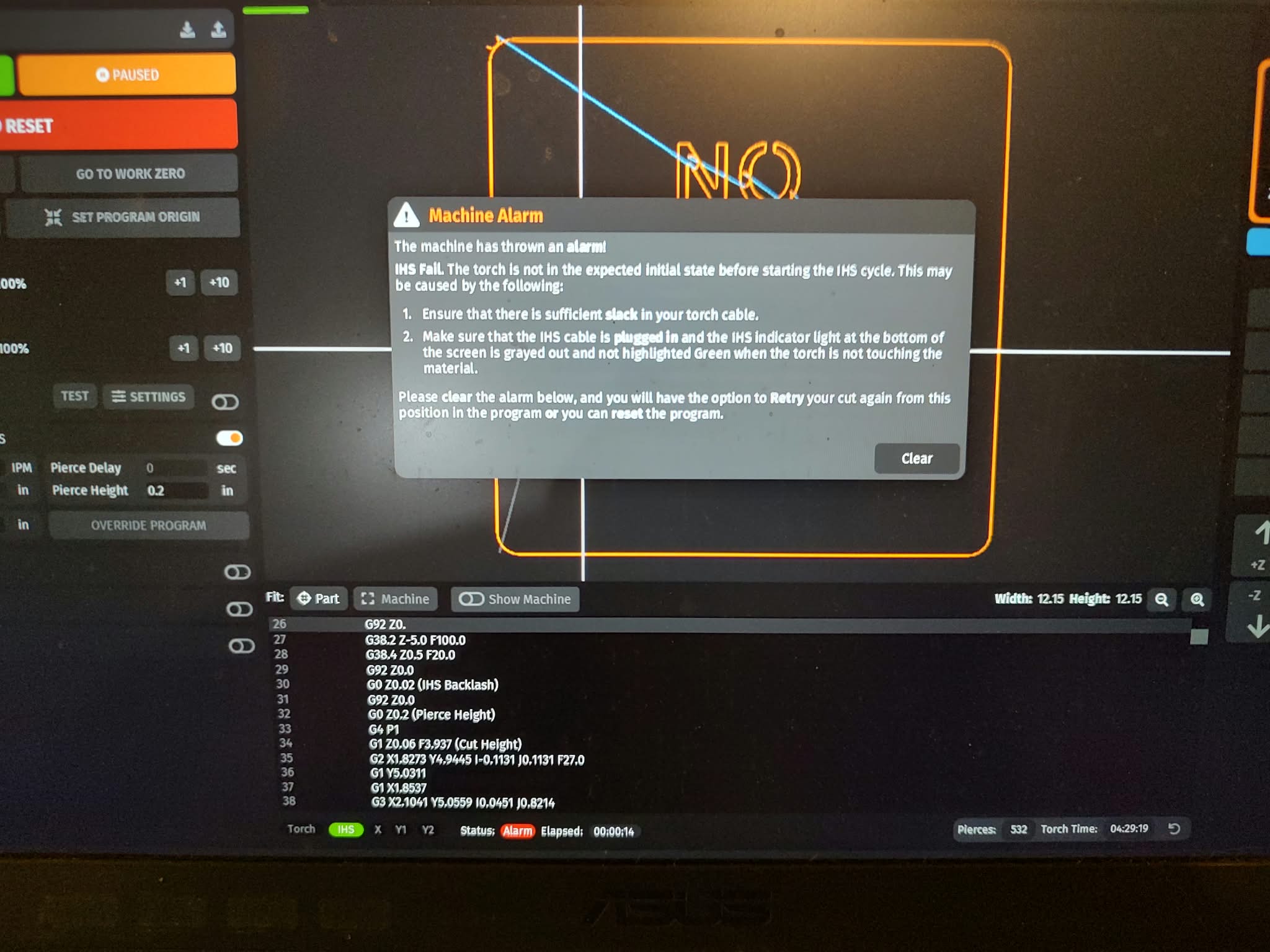

When I try to run a program on the dry run option it starts to go through then just stops giving me a warning (pictured below). If this is referring to the cable that goes directly to the torch. Yes that has full movement. I have tried this a number of times. It starts going through and randomly stops at different places. Also notice the bottom of the picture the light it mentions is green. I am using Sheetcam to generate my code. Can you help me figure out what I’m missing here. Thank you for your time on this.
I take it you’re doing a dry-run with Z axis enabled?
I ask because only the latest iteration implements Z axis movement, whereas every version before it doesn’t. You can select to turn off Z axis movement and try your dry run again.
With that said, you do have a Z axis assembly installed right? I ask because you do not state what table you have. Not to mention, your IHS isn’t stuck right? No foreign debris? No spring missing?
IHS can get finicky and trigger causing your Z axis to essentially ‘reset’ when in actuality, it should be running code in the form of X and/or Y movements.
Lastly, ensure your torch has enough travel (Z + and -). You want to have some remaining down travel left even after your torch touches off your material. Don’t bottom it out.
That green light means your IHS circuit is open. That could be a loose or disconnected IHS wire or the switch is stuck open.
That light should only be green when the torch is lifted, which opens the IHS switch. It should never be green at the start of a program.

I found a ground wire that came disconnected. I’ll come back after I get that connected. Thank you.

It was a ground wire that came disconnected. I have run it and seems everything is in working order. Thank you all for your helping me on this.
