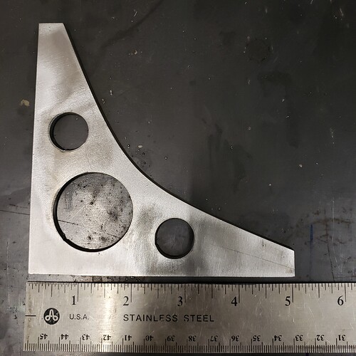

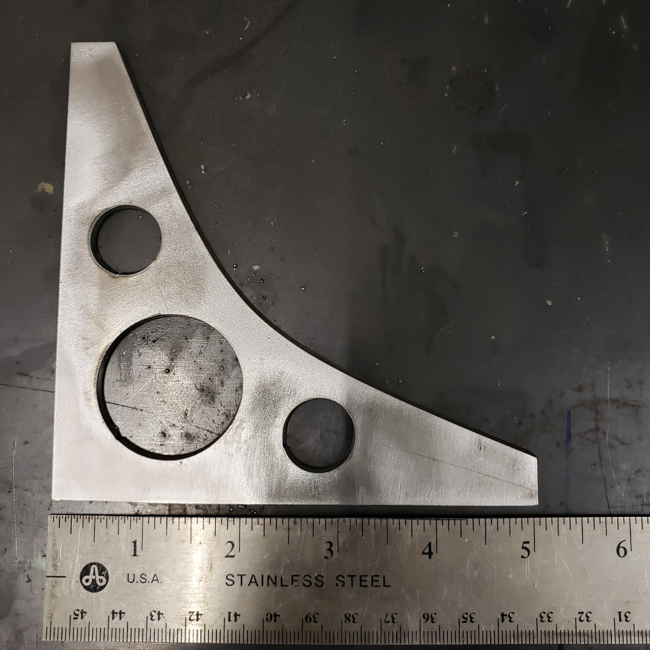

I'm looking for a review, how did I do?
So this is my 4th cut using the table. I’m looking for feedback based on my photos and video.
I noticed that each cut has a visible pierce point. What would you do based on the pics?
  1. Make Kerf larger or smaller?
  2. Change lead in value?
  3. I didn’t use a lead out, should I have?
Wiping my goggles off… Looks like you started the cuts on the outside of the circle maybe? Hard to see well.
I wouldn’t change your kerf, especially since those are pretty big circles. I would just make your lead in larger. I have been making my lead in twice the size of my kerf
Check your lead in and out settings you can make them longer to get it to pierce farther away from the edge so it will cut the start and stop out with the drop.
I’m changing my lead in to larger, I noticed later on my profile that even though my torch head appears straight it’s actually at a slight angle so I’m gonna correct that as well. Thanks for the feedback guys.
