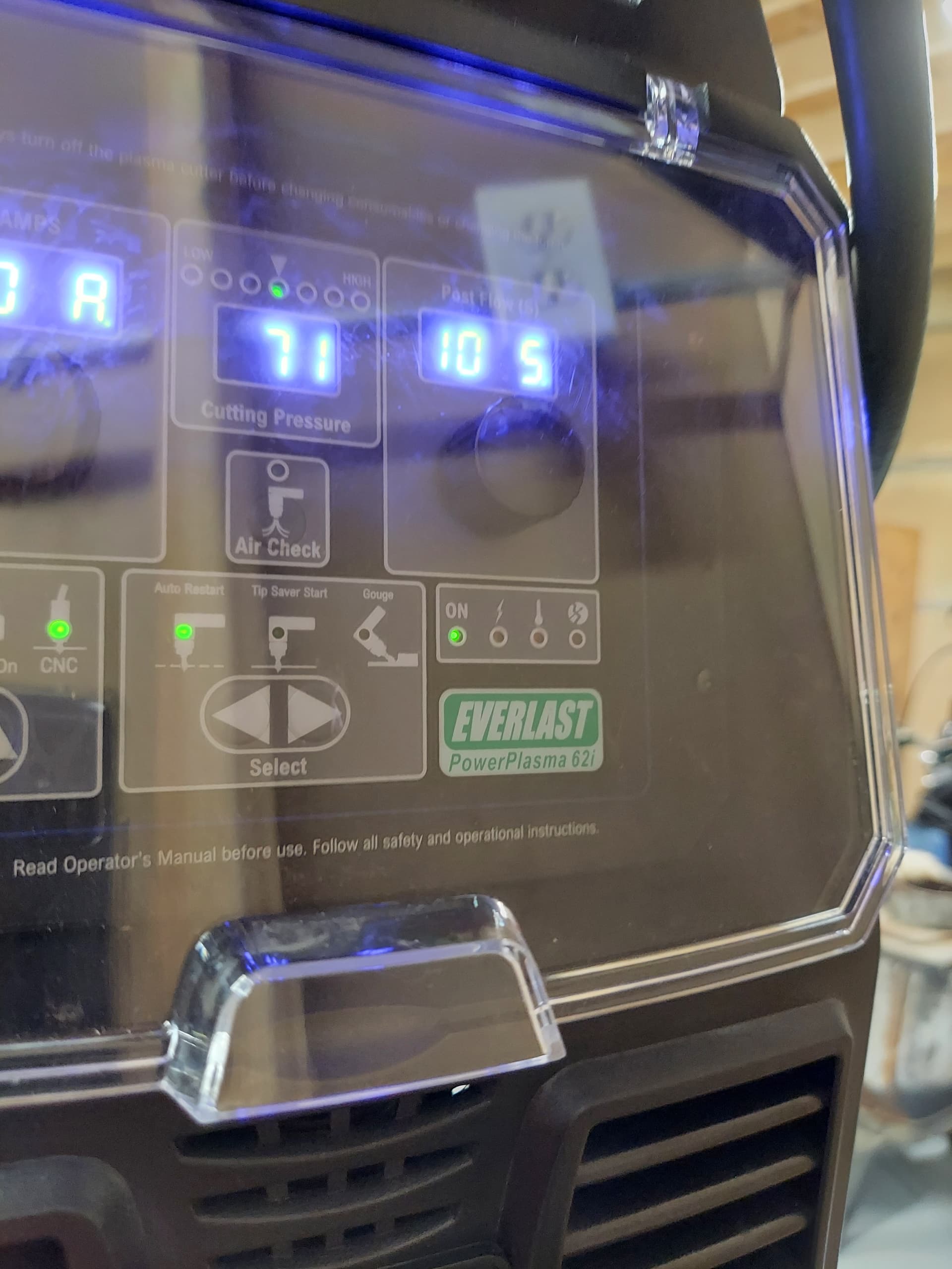

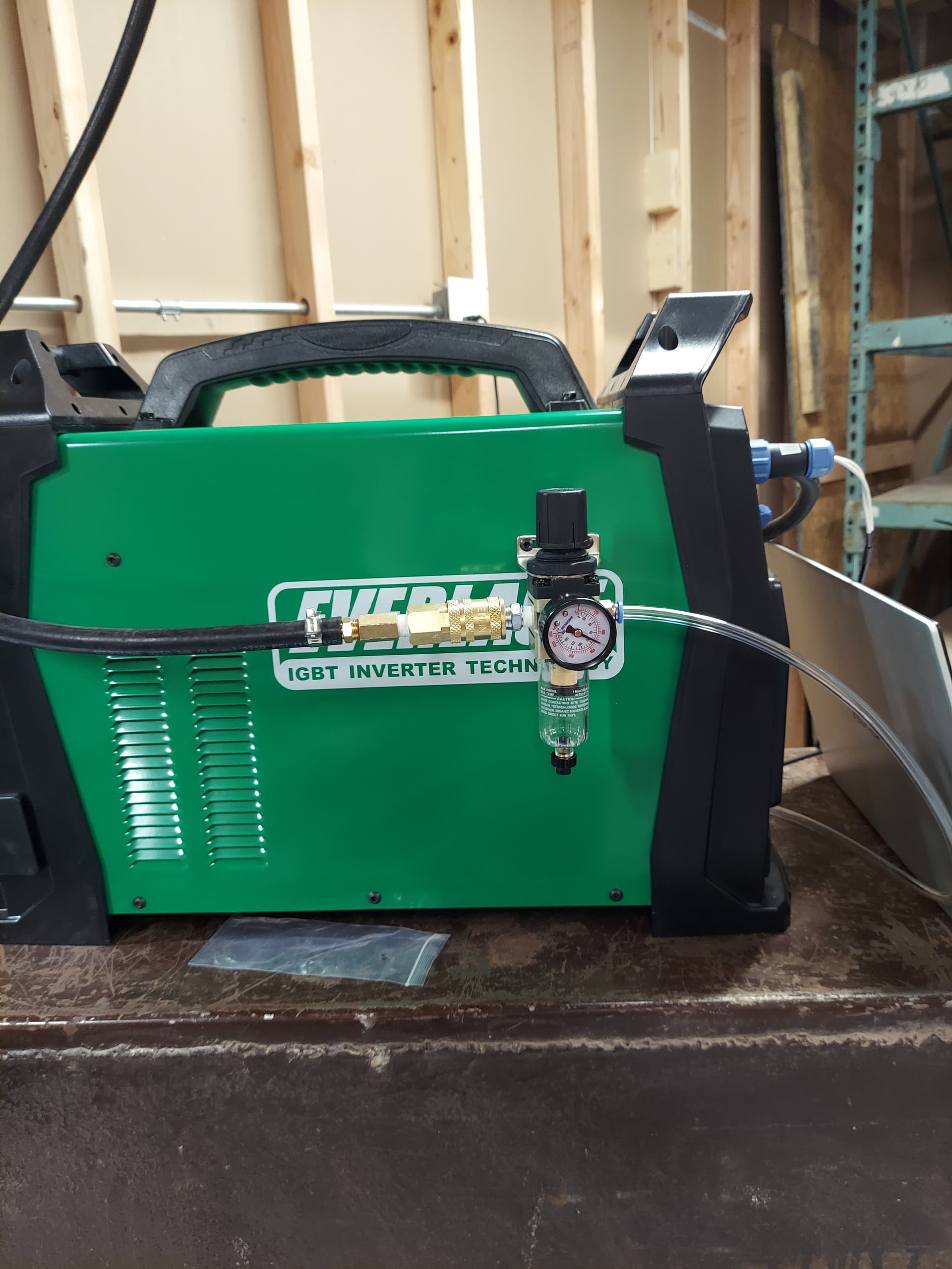

ok…yes…i can depress the piece inside the torc. yes my clamp is to t he work. I believe we can solve…i have read many threads where the solution comes…i decided to go raw voltage because of these threads. I appreciate everybodys time to assist. here are the photos you requested. i have a question about the air check. i press it and it goes down to 45…then back up…is that correct?
If your air pressure is dropping to 45 then that’s your problem. It should be sustaining much higher like 70. What’s your regulator set at from the compressor?
That’s your problem. It should only fall 5 to 8 psi.

Tell us your air line size and what all you have from the compressor to the plasma.

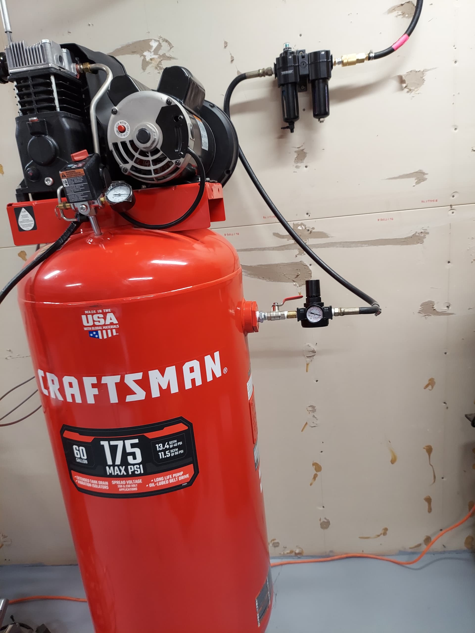

Since you have an “off the shelf” craftsman compressor, which model is it, specifically? Have you added anything in line between it and the Everlast?
from my messages
i am strugging to keep air pressure constant or not dropping so much.mill describe my setup…60 gallon craftsman…maintains160psi while taking a nap…then a pressure regulator…everlast said necessary…then air dryer.then regulator at th cutter…then on in to the cutter :sweat_smile:
Using 3/8 in hose…no leaks…probably wont be able to message back***
Maybe a cutter issue? I don’t see that air line or filters causing that much of a drop. We would need to know what each regulator is set to?

Run the air pressure as high as you can to the last reg. Use the last reg to get it to the 75 psi you need at the cutter. As high as you can is a few psi less than the max on either the compressor or your filter whichever is lower.
You could add a supplemental air storage closer to the cutter.

I find it hard to believe that a 220v Craftsman with 60 gallon tank rated for 13cfm is the issue.
I’d be suspect of a bad regulator (or one set too low) or air leaking somewhere in between. Or even inside the plasma cutter.
I say this having run a +30 year old 110v Craftsman with a 20 gallon tank rated only for 7cfm, for over a year without issue (not ideal I know).

I think this is likely the culprit. maybe try bypassing each one individulaly starting with the one off the tank, to determine which one (if any) is faulty.
My guess is it is the one on the cutter, I seem to recall someone having an issue with a new Everlast cutter some months back that had a bad regulator from the factory. He seemed to suggest that Everlast knew they had a bad batch and was quick to send a replacement.
Edit, this is the one I was thinking of… it was an air solenoid not the regulator.
Try bypassing the regulators first… then if you can’t resolve it call Everlast and have them help you trouble shoot the problem.

As said it could be a Everlast faulty regulator. I also see a few splices in the air lines. Also could be the regulator at the compressor or the filters. You can have good pressure but not the amount of volume to make it work.
