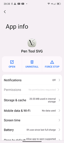

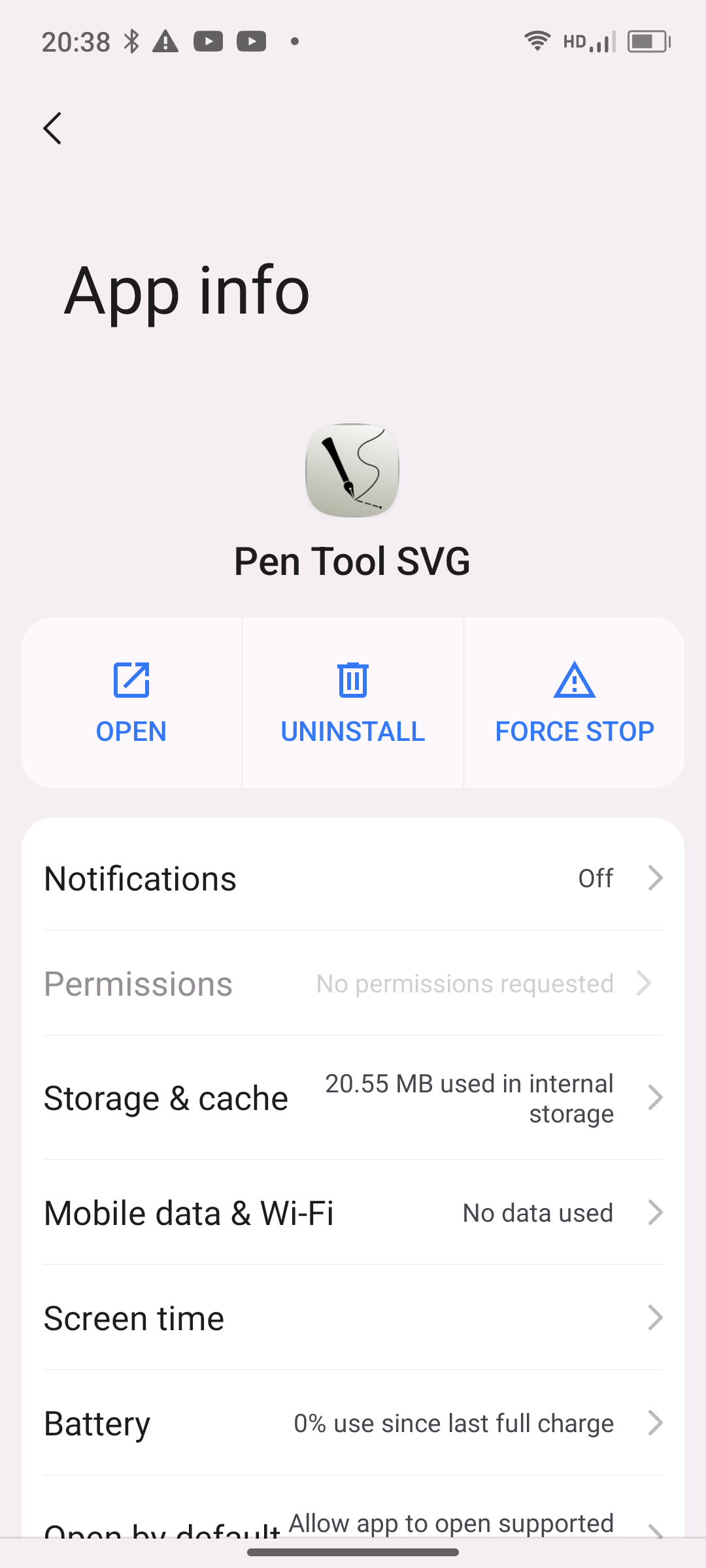

I’ve used this for drawing on my phone a little bit.
If you get something up and running let me know I would be a guinea pig.
