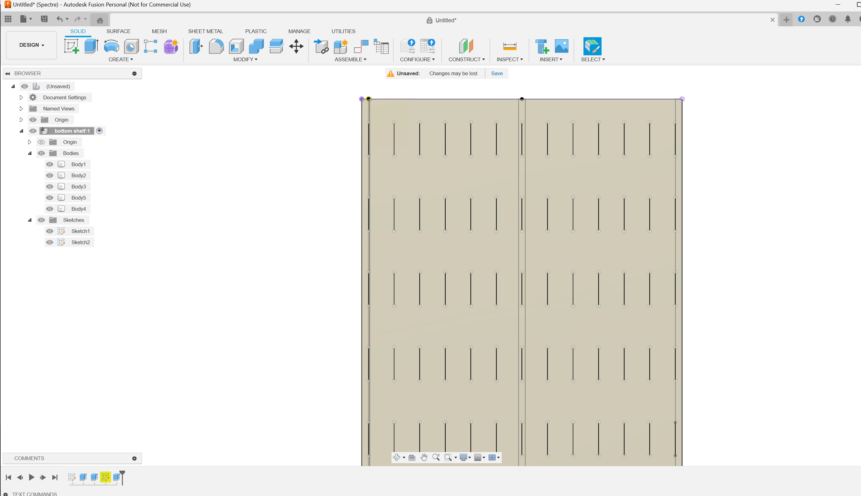

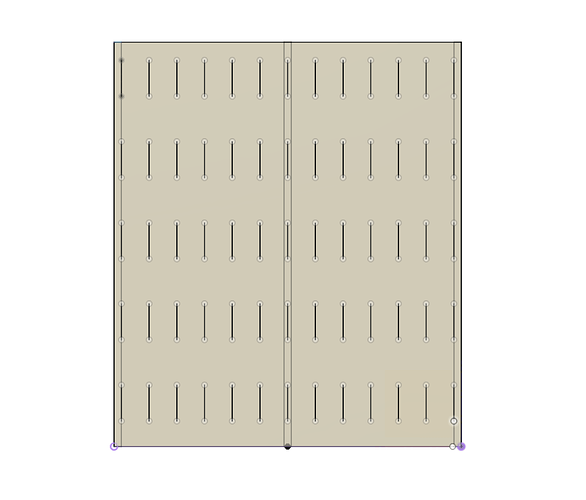

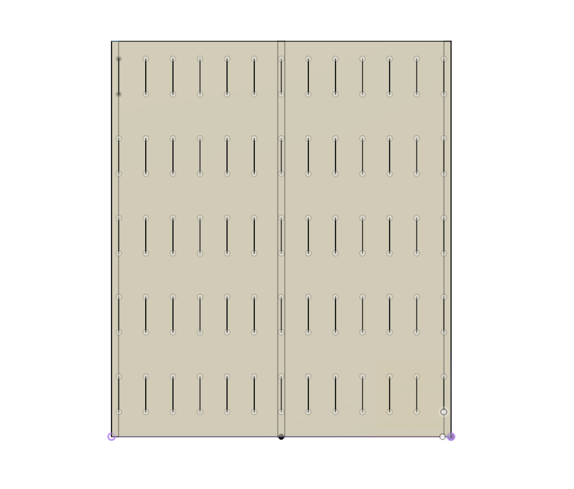

Any considerations to powder coat the shell and do those thin dividers to in stainless. I read in the drawing us TEK screws or self tappers for the dividers. So I would slot the bottom shelf and tab the stainless steel dividers. At the top of the divider I would fold over and a tab that would be screwed into the 1x1 tubing.
I would have to see a drawing, I cant picture it in my head. I did find out the zinc dipping is out due to size.

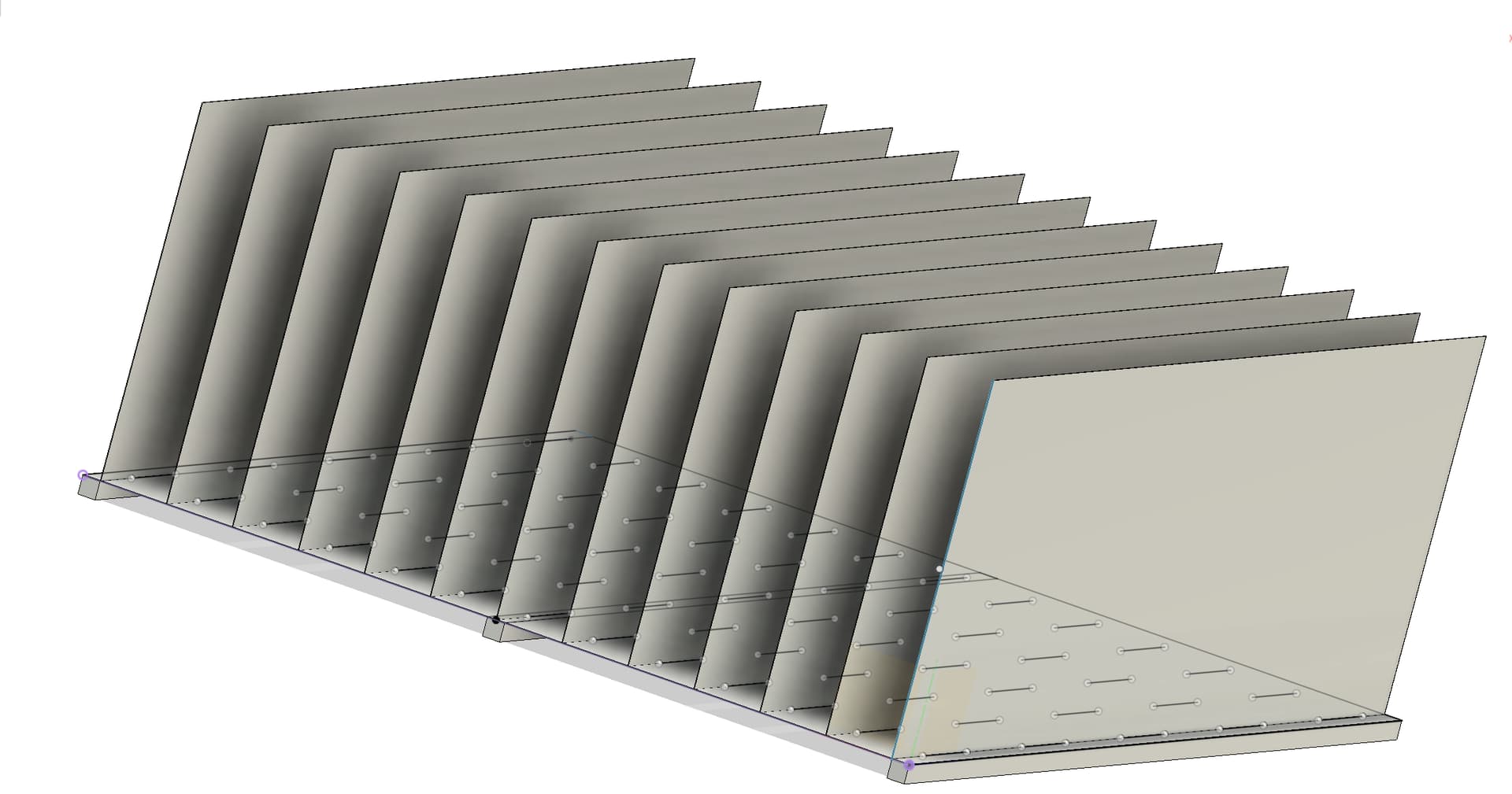

I would cut the shelf with tabs and powder coat the shelf. Then the way the cart is designed I would do the verticals in stainless. At 520# I’m assuming this is a cart to hold metal items.
Just a thought how to manage that space and not fight with fasteners

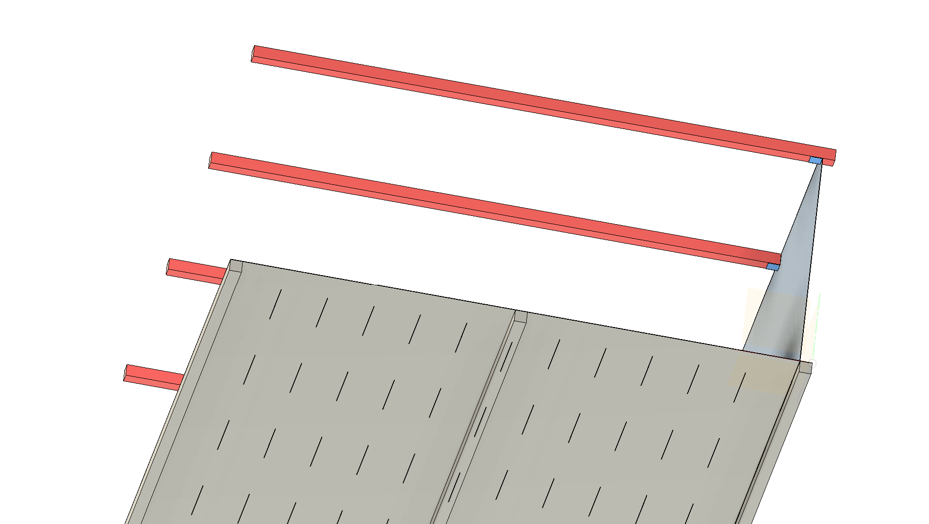

Red are the crossbars for the upper shelf and blue are the dividers and tabs that would be bent down to either screw or spot weld.
I like it, not sure how much that would add to cost. I have been giving this a lot of thought and have came up with making the top section removable from the bottom.
I am thinking of sleeving the 6 uprights just above the partitions and that would make it so everything can be finished and assembled afterwards. So each partition would have four fasteners top and bottom. once that is done slide top on and fasten.
What are your thoughts on that?
Thanks for drawing that, made a huge difference for me. Which I was that good!

Well… I’m not that good. I need practice and since there was a drawing I took a stab at it. I’m still learning.
