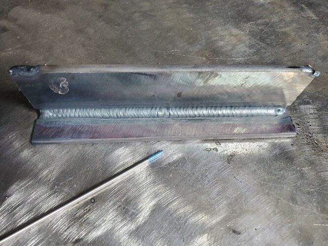

Welding went “just average” …For some reason I could not find my “Mojo”…I made a few stupid mistakes, but overall, it work just fine.
Here is a “vertical up” attempt…pathetic, but this ain’t going on the space shuttle, …its a paint rack… so it will have to do.
Not horrible, but I gotta learn how to “turn the corner” better.

You should put a nice little blob of filler when you tack it at each end. Let’s you get away with dabbing less when finishing your weld. Don’t go too big of a filler either, or too slow, as it’ll puddle up like you saw in your first pic.
Again I know not space shuttle, but establish good habits. If you establish bad ones, it’ll be hard to break.
Second or third attempt ever, lanthanated on mild
Thanks for the advice. I will try the “end blob” trick next time for sure.
I also think that you are correct about my choice of diameter of filler rod being too big.
I think I will have to “stock up” on a few different diameters so that I will have better choices.

The blob is less a blob really, just a little emphasis I’m trying to place :sweat_smile:
But that’s just in case you’re not used to ending your beads. When you do so using TIG, you normally want to dab a little more to finish the weld which by itself takes time to do right.
And that also depends if you’re using high-frequency, scratch start, or lift arc. If using either of the last two methods, a flick of the wrist to kill your arc but hovering over your weld to provide post-flow is important.
It’ll come in due time, especially with all your projects!
