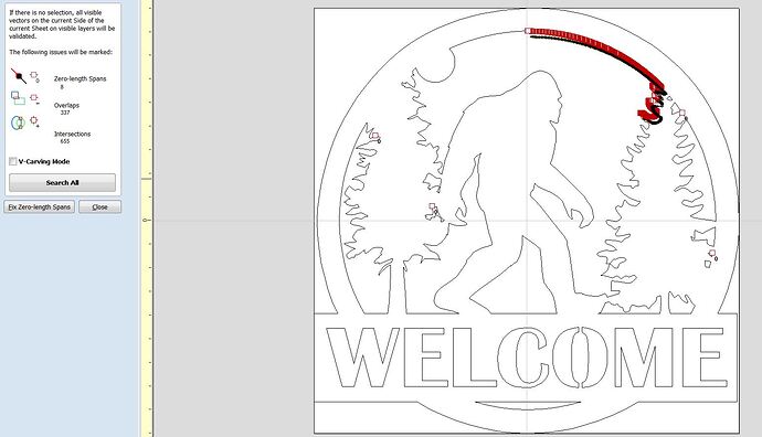

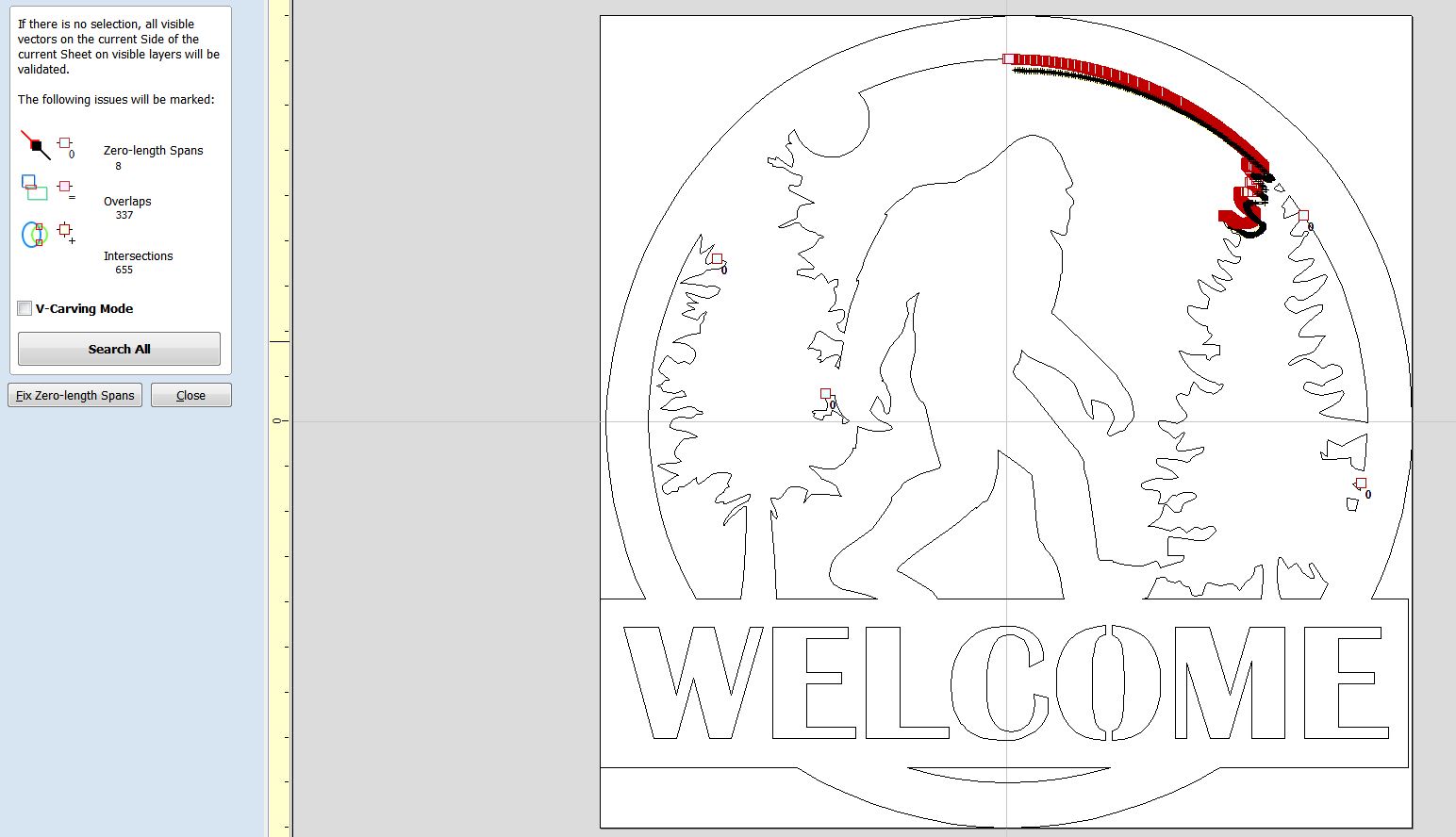

Out of curiosity, I imported your drawing into Cut2D and then ran the Vector Validator tool
on it and these vector errors were identified. I’ve never seen that many errors identified in a drawing before.
Now Sheetcam is smart enough to disregard small vector errors when generating a file and if it cuts OK then it is OK, but I always process my drawings until no vector errors are found and they always cut without a hitch.

If it cuts OK then it’s good enough.
The type of errors are identified in the panel left of the drawing. Overlaps without joining, zero length vectors and intersections are identified. You might have to keep selecting an area and zooming in to that area to be able to see them because you run out of regular zoom.
It could be however that with that many tiny vectors your gcode could be huge and take a long time to burn. If I was going to make more than one I’d take the time to fix the drawing.

Here’s your drawing with the errors fixed.
Big foot files fixed.zip (221.9 KB)
I went back to inkscape and zoomed in and i only show 1 node in that area.
I’m hesitant to get another program, KWIM? i have spent so much time trying to learn fusion, inkscape, sheetcam not to mention understand plasma cutting in general! I really didnt care about what toys joe had because i never had to learn them. Now i have to because he can not do the computer part of it. I’m trying to teach him but he would be the first to tell you that this is not for him, he can barley turn on this pc with my help!
thanks for the drawing!
YW - it was quick and easy for me to fix with the tools I have available.
All the errors found were in different areas than anywhere near the ā€œMā€ so I don’t know what the problem was with that character, but an open vector instead of a closed one seems a likely candidate. It’s possible to have two nodes with one directly atop the other that are not joined, creating an open vector loop instead of a closed one and Inkscape doesn’t know how to fill in open vectors.

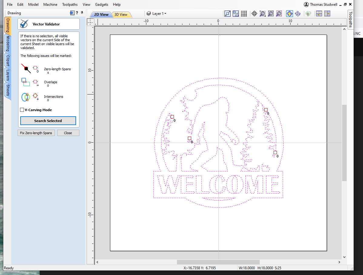

I don’t know which file you downloaded but I hadn’t seen any of what you’ve identified. I decided to check out the SVG file with VCarve Pro and this is what I get with the vector validator. Nothing like your results. My file was the SVG included in the ZIP file.
Are you working with the original file???
