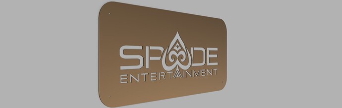

Well guys I am here again looking for come help please, I programmed this, then noticed it was not square or level in the square so i moved it to make it right and now I cannot seem to extrude it, only the letters and shapes extrude? I am including the F3 file hoping Twitch might see it and help me once again,

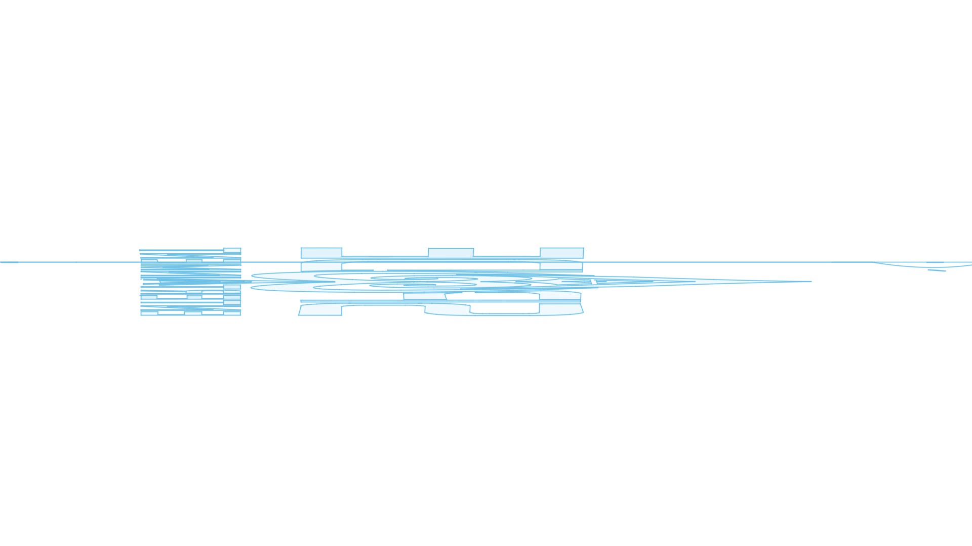

The sketch was a 3D sketch so all the line were not on the same plane.
I projected your project to the XY plane and extruded it .
You should be good to go now

TinWhisperer, You are awesome, Thank you again, I will remember to look at it from that angle, I used your divide and conquer on this too another super Tip!
