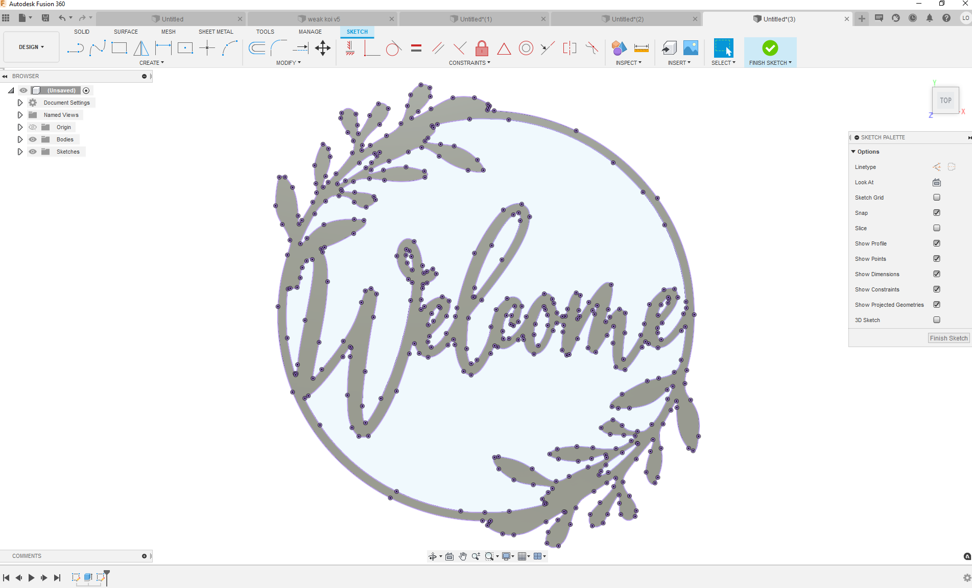

I have a sign design in fusion and it sticks in the tool generate process. Can someone help me find the issue?
it stalls at 45.5%
round-welcome-sign.dxf (124.7 KB)

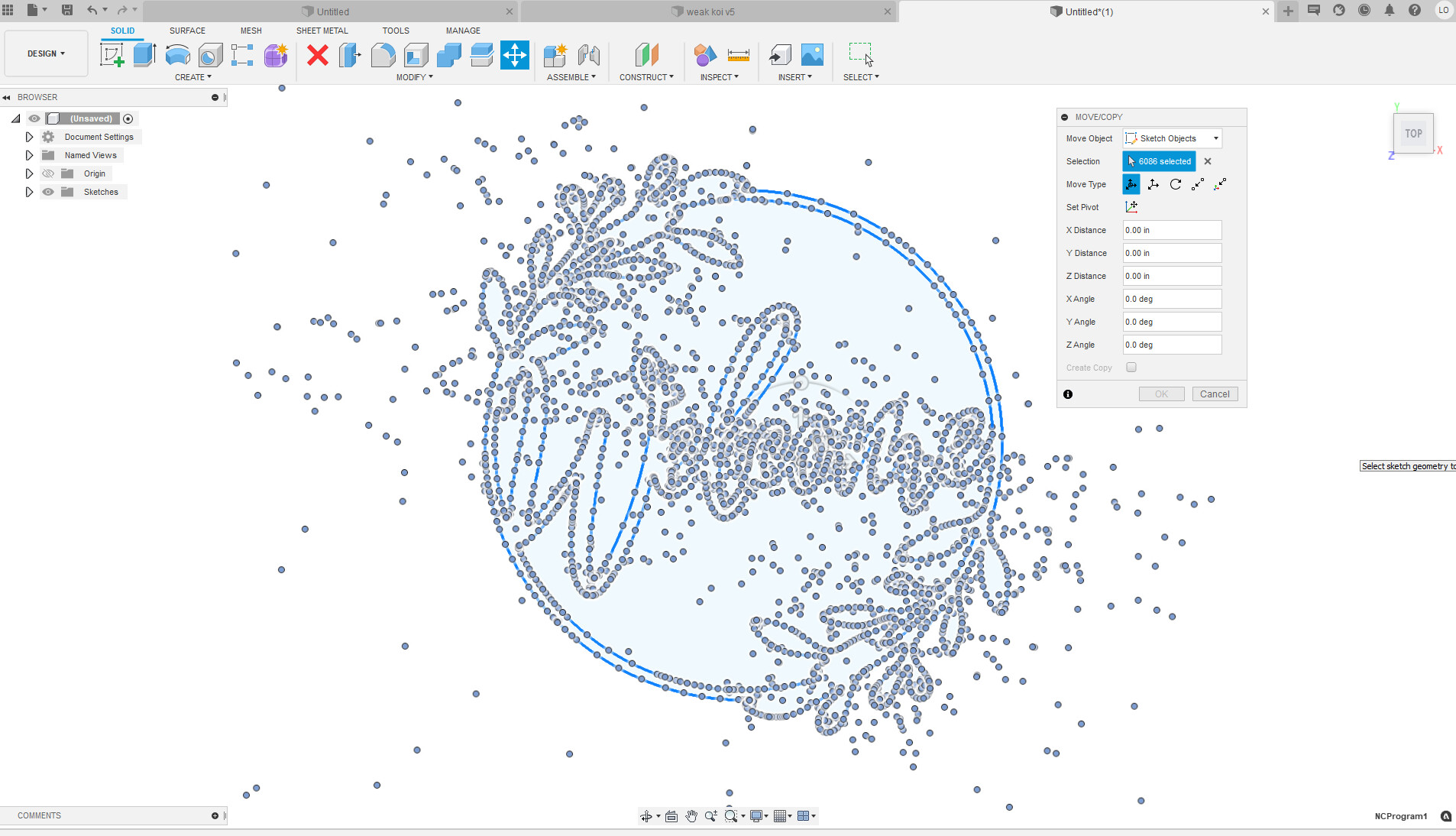

What size is that supposed to be? I imported it into Sheetcam and even with metric scaling, its about 55" in diameter. If i import it as inches, its 25x that size.
@ds690 is right…check your scale size of the drawing…you may be bogging down fusion…
I loded into shettcam and it processed in 2 seconds…but it is huge!!!
Therre is alot of dirty path to svg conversion happening here.
This will bog fusion 360 down, it want to track it all the points and sheetcam will ignore many.

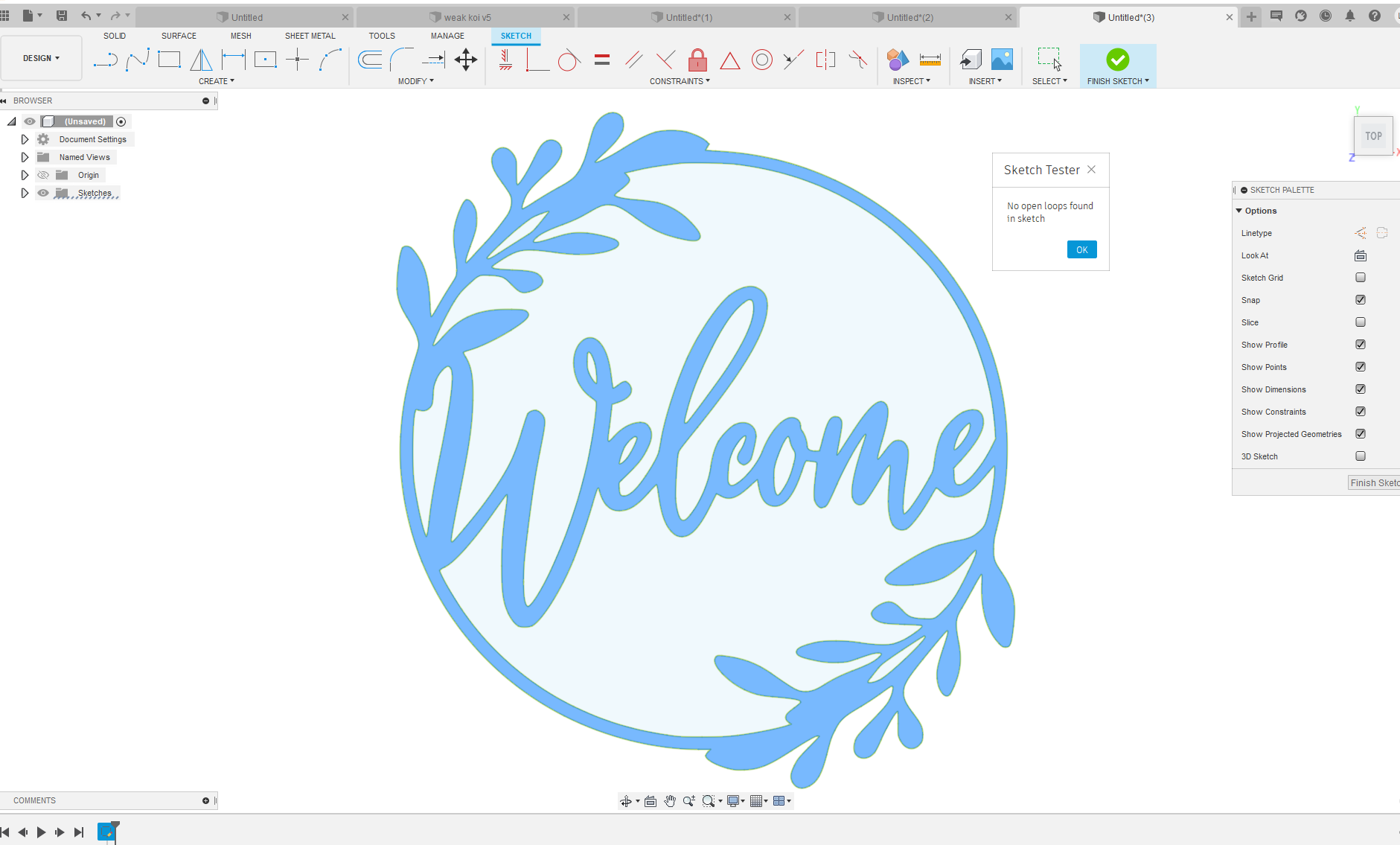

round-welcome-sign-crispy-16in.dxf (178.1 KB)
Here is a clean crispy file both in DXF and SVG.
I made it a 16 in diameter.
I also wasn’t sure of the scaling I though it might be 12 inches across but ?
in mm I was getting the same
but was thinking it may be pixels at 125ppi
How did you get the orignial file? how was it converted ?
