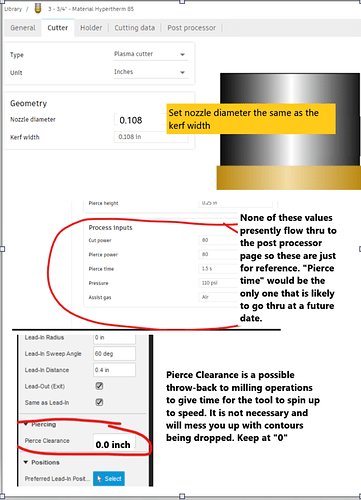

I have a crossfire pro and have been using a Hypertherm 45xp and just purchased the Hypertherm 85 SYNC with machine torch and now I need to add a new tool for all of my programs. I am needing to setup the new tool for cutting 3/4" mild steel.

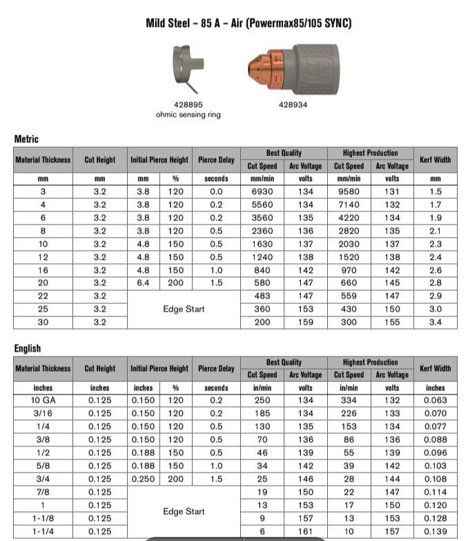

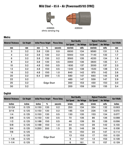

Here is the cut chart:

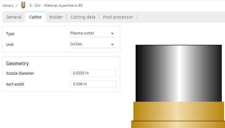

  1. I cannot find all of the specs I need for creating the new tool in Fusion 360 such as the nozzle diameter:

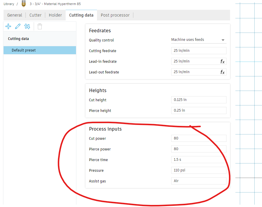

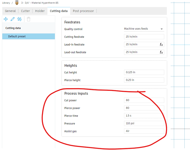

  2. Not sure of the Process Inputs:

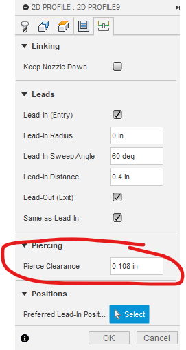

  3. After selecting the new tool but still in the setup properties…not sure what the pierce clearance should be:

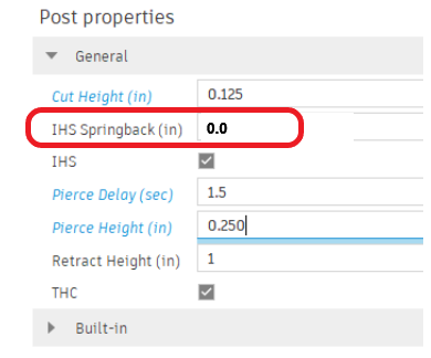

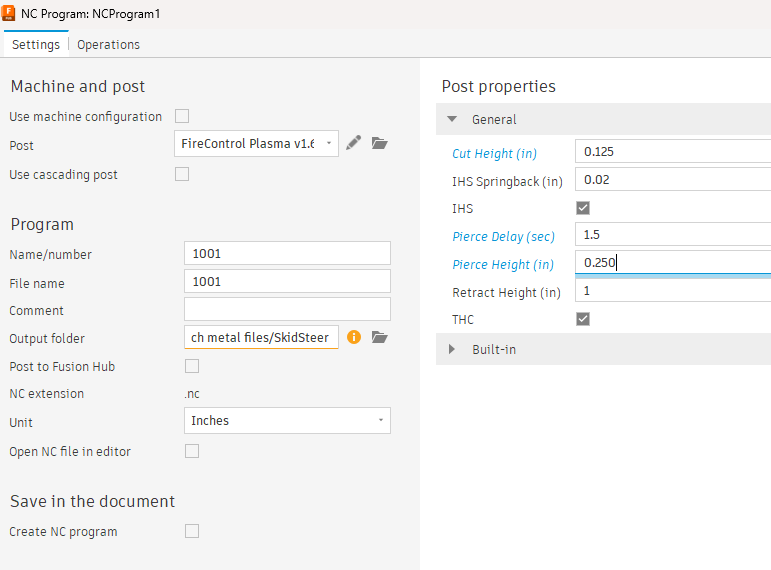

  4. I guess these settings in the creation of the gcode are ok
Thank you in advance for the help…I am looking for to getting this machine setup.
Your post processing page looks correct. Remember that by putting “0.02” in the Springback column, Fusion is going to add that to 0.02 that it already plans to cook into the code. And since you are cutting 3/4" inch plate, we know there is not going to be any flex. Just put “0.0” there.

  1. The torch goes down and contacts the material like it should at the beginning of the cut…but then it goes up and is cutting with the nozzle probably 1/8" above the material, is that normal? My hypertherm 45xp would cut with the nozzle probably under 1/16" away from the material.

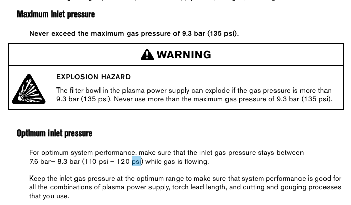

  2. My air regulator is sitting on 120psi when the machine is not running…then when it is cutting, it drops down to 80 psi. I have more capacity with the air comporessor but what should it be set at? Should the running psi be 120psi? which would then make the sitting psi greater and if so would that be bad for the machine with that much pressure on it.

According to the cut chart above, that cut height is right on the money: 3.2mm/25.4=0.126" or 1/8"
As for air pressure, your manual should tell you target pressure while cutting.
The Hypertherm machines regulate what air pressure they require. I have my pressure set just a tad over 100 psi.
For your machine the manual says this:
