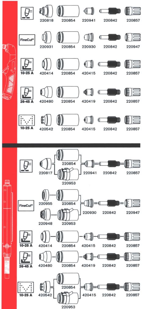

I have the machine torch for my 45XP and I’m just getting my table setup and electronics connected. Assuming that the torch I got doesn’t have fine-cut consumables, what exactly should I be getting? I see a fine-cut nozzle, but the electrode and swirl rings say flush-cut. A bit confused about what parts I need. Can someone recommend all correct consumables, we only plan to cut 16-22ga steel parts for the forseeable future. Thanks!
220948 shield, 220854 retaining cup, 220930 Finecut nozzle, 220842 electrode or 220777 Copperplus Electrode, 220947 swirl ring. I’d recommend using these consumables on mild steel thinner than 3/16".
You can use the 45amp 220941 nozzle and 220817 shield on thinner mild steel down to 16g but your feed rates will be pretty high. You’ll get better results with the Finecut nozzle and shield on thin stuff. And thinner than 16g, definitely use Finecut.
