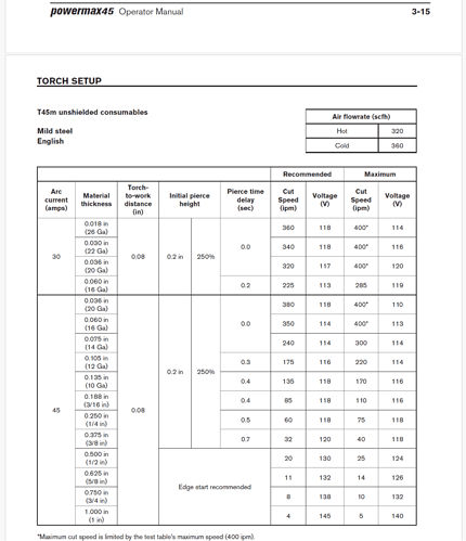

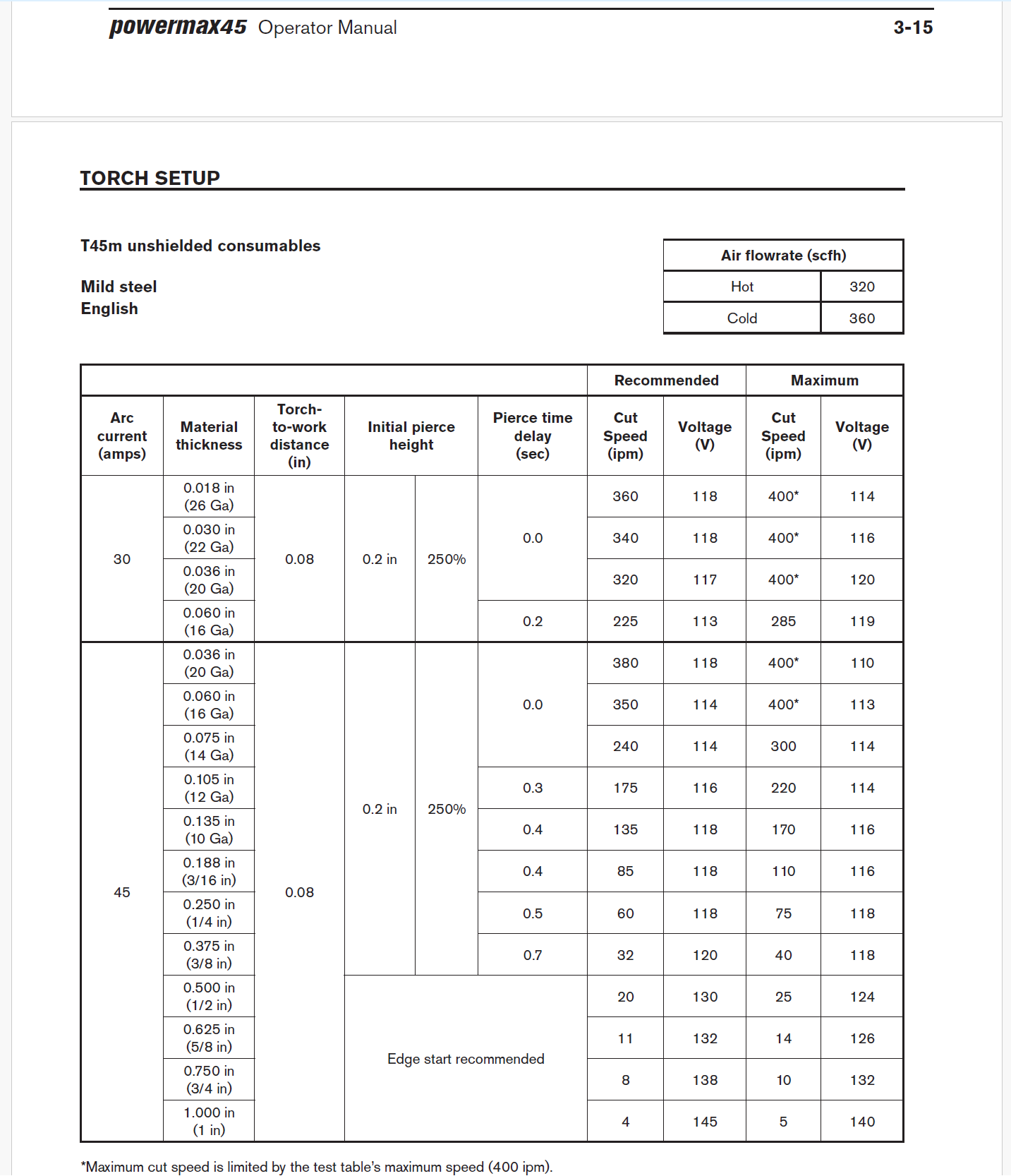

I just got my table and haven’t dialed in my plasma cutter. I’m wondering what settings people have for their setup. Not just the cut speed. Things like pierce height and time.
I would stick to the hypertherm cut charts to start.
Use a pierce height of .015" and a cut height of .06 to start.
Have your Pierce delay set to .55sec on the thin end of the chart and .1 at the thicker end of the chart to start
Just be aware that this machine only has a 35% duty cycle at 30 amps. And it’s recommended that anything over a quarter inches Edge started.
Also in the book there is some finecut consumable cut charts as well.
When I get my machine back, I will try these settings. Probably make a cheat sheet for when I set up cuts in Fusion. Thank you.
