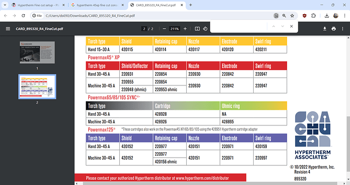

Using a 45XP with a machine torch and want to make sure I am getting the correct parts.
Looking a the chart above, I assume I need 220947 (Swirl ring) 220930 (Nozzel), and 220955 (Shield) I am having a hard time finding the shield… What is the difference between 220955 and 220948? Also, I know I want genuine Nozzles and Electrodes, but what about the shields?

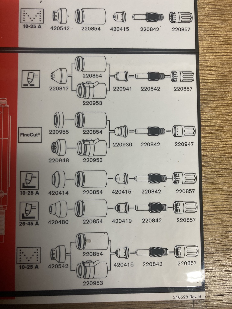

These are the part numbers you need.
Don’t be concerned that they come up as 65 or 85 when you search for them. Also, Hypertherm hand and machine torches use the same consumables. The only one that lists hand torch only is the drag shield, mainly because you don’t drag a machine torch.

The fine cut consumables are for the 30XP and work on the 45XP. This place has them all in stock https://harrisweldingsupplies.com

Fine cut consumables work best on thinner metal. The cutting tip/nozzle has a smaller orifice hole making a smaller flame so you get a thinner kerf. The fine cut consumables are designed to work at lower amps (15 to 30) with an orifice hole of 0.8mm/.029" were as a standard 45 amp cutting tip/nozzle has a 1.0mm/.040" orifice hole.
