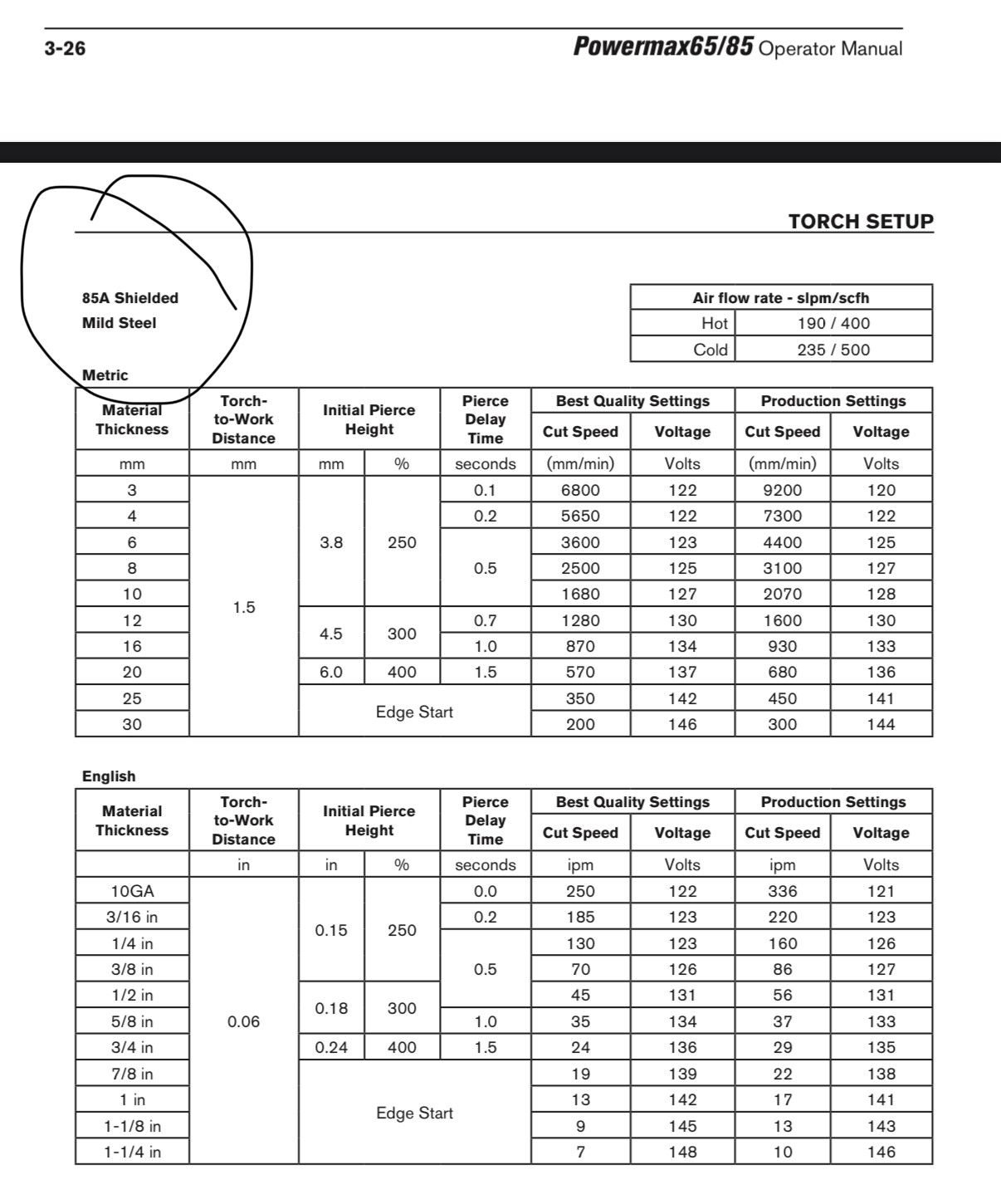

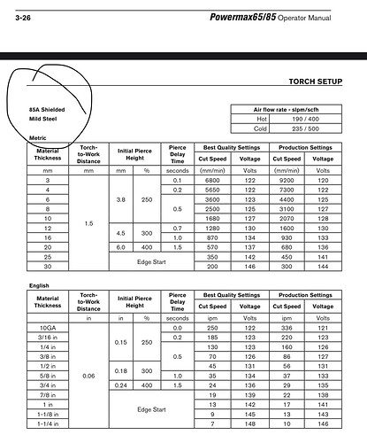

Good day, so just got a Hypertherm 85 and downloaded Hypertherms cut chart. It gives me a lot of information but not the amps needed per thickness of steel. Has anyone developed a short list that works well with just cut speeds, amps and pierce delay for thicknesses of 1/6" to 1" mild steel?
Thanks so much in advance. Cheers
What cut chart did you download that didn’t give you amps? Hypertherm provides that.
Here, from the manual. https://www.weldersupply.com/Content/files/ProductPDFs/Powermax65OperatorManual.pdf?srsltid=AfmBOoq9-2h1MHBK0O7RSKDcD2BFYCw5_ui1lubLlwpgOu5amzvYwgTb
Hypertherm charts are pretty accurate for dry cutting. Reduce cut IPM 15-20% for water table cutting. That has been my experience.
