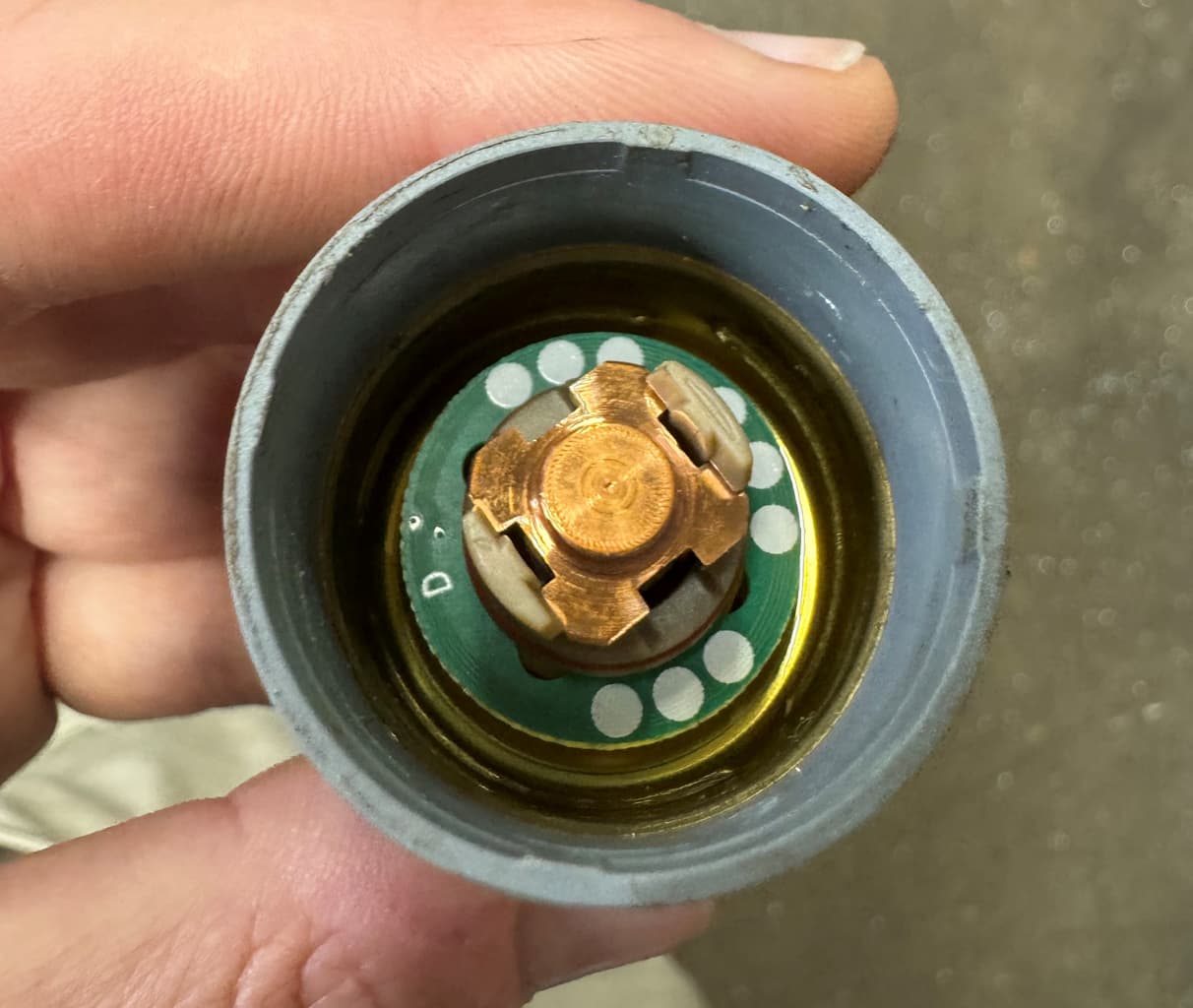

Hi there, I know this is an old thread, so I hope you don’t mind me jumping on it. I see you are using the Hyp. sync version. I’m contemplating the same machine, only the 45sync, but was wondering if you have had any trouble with the cartridges getting damaged by the water in the table. Worried about the electronics in the cartridge. Would you mind letting me know your experience.

Hoping for the official word, I contacted Hypertherm directly, and after a lengthy phone conversation the fellow continually repeated that the torches were not designed to be run over a water table, they were designed to be run on a downdraft system, and that if water did get into the cartridge, it WILL cause problems.
So…I was just wondering, from your personal experience, what can you tell me?

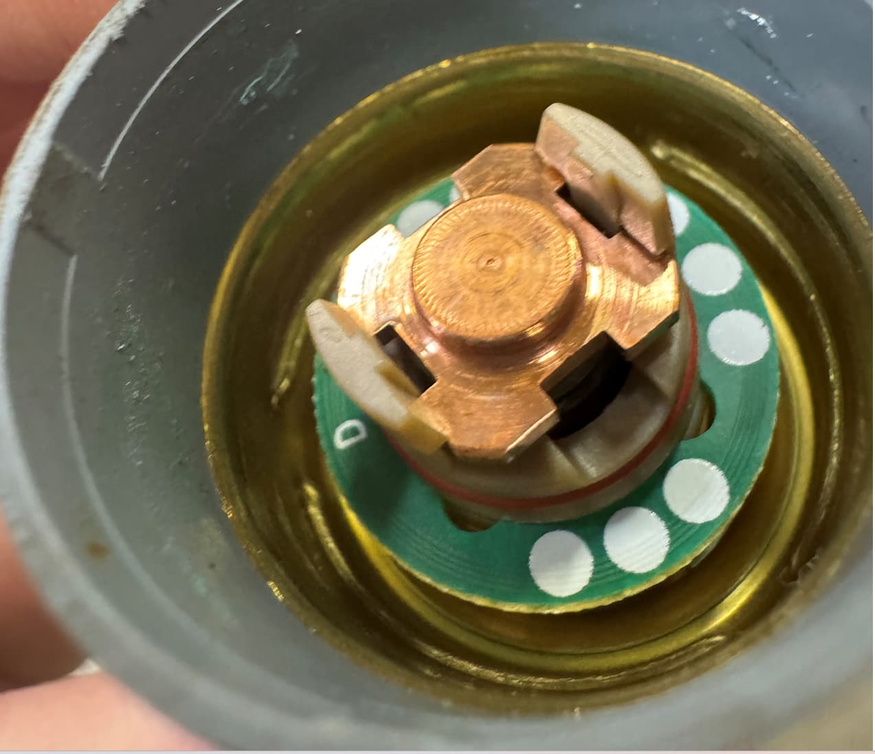

Thank you, this is the kind of real experience information I have been seeking, not just opinion. As mentioned, I am contemplating a sync unit but have never even had the opportunity to look down inside the cartridge itself. Can you see the electronic components or are they somewhat covered? After changing out a cartridge have you ever noticed water droplets on the inside, or anything that might look like powdery residue from whatever additive you use in your water table? Thinking of corrosive action on the components.
For reducing the possibility of water getting in thru capillary action down the threads, all the Hypertherm guy could suggest was a wrap or two of black tape around the seam.
I’ve never noticed anything unusual to indicate any kind of water ingress. Here is some pics of inside a used cartridge. On the torch itself, there is an O-ring on the threaded part this cartridge screws onto.

These machines are not delicate, and many people go as far as performing submerged cutting. Would I do it? No. But you’re not going to ruin anything by getting the cartridge wet like you’ve asked multiple times.

It is funny though that you say there is an “O” ring there. I specifically asked the Hypertherm guy if there was any “O” ring seal there, and he said no.
Maybe he was referring to the 45 which I was asking him about at the time.

No problems with water and the electronics in cartridge.
